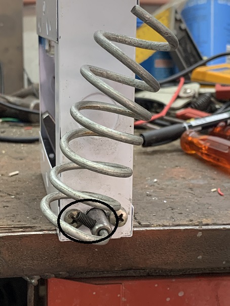

I used a standard 4 x 4 surface mount electrical box to house everything in.

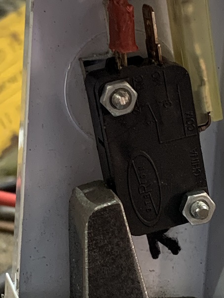

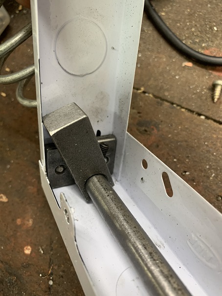

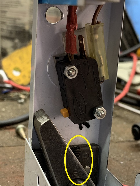

Some 25 x 5 flat bar inserts inside to help my shaft pivot smoothly and a adjustable tab to activate a hefty 220V rated micro switch.
Attachment 32973

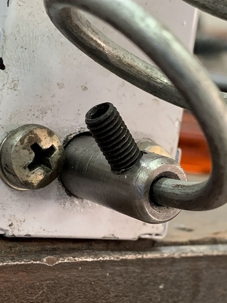

Then on the end of the shaft a coil of 4mm wire for storing the iron when not in use. Similar to what the commercial stand have. I also made this adjustable, so the weight of the iron will activate the switch.
Attachment 32974 Attachment 32976 Attachment 32978
To stop the shaft moving from side to side I fitted another tab on the other inside of the box. This is also adjustable, this time to protect the switch from being smashed if something heavy would fall on the sire holder.
Attachment 32977

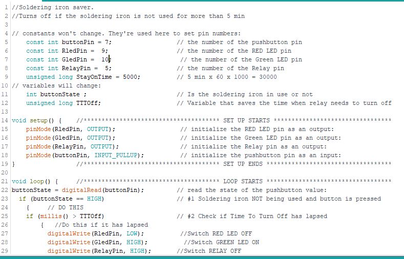

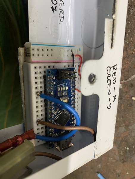

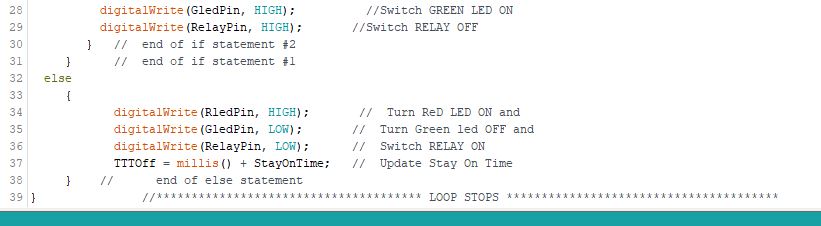

Then I used an Arduino Nano to do the programming.
Attachment 32979
I can send the code if somebody is interested.
Attachment 32980 Attachment 32981
The logic is to capture the time once the micro switch is made and then add a pre determined length of time to that. As the Arduino is running at 16 MHz it will the continuously check if that "Calculated Time" matches the "Current Time" if it is TRUE it means the time has lappsed and you have not used the soldering iron for that time, so it turns the power off.
I have mounted it in such a manner that the USB is accessible, for 2 reasons:-
1) I can use my newly built Power Pack as a power source and
2) I can easily change the "ON" time on the Arduino.

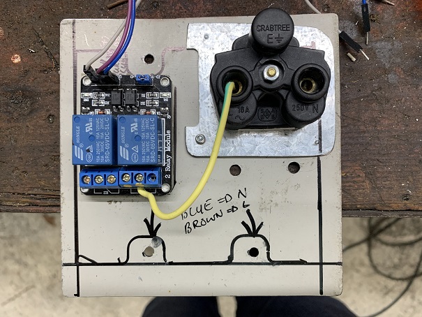

I have used a duel RELAY MODULE because they were cheaper than the single units at the time I ordered them.
Attachment 32979 Attachment 32982
