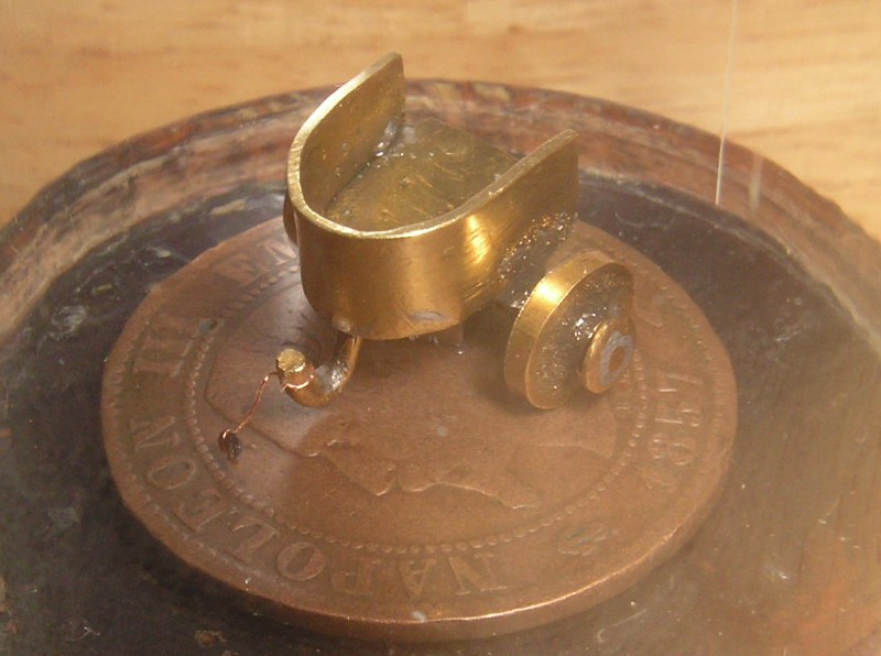

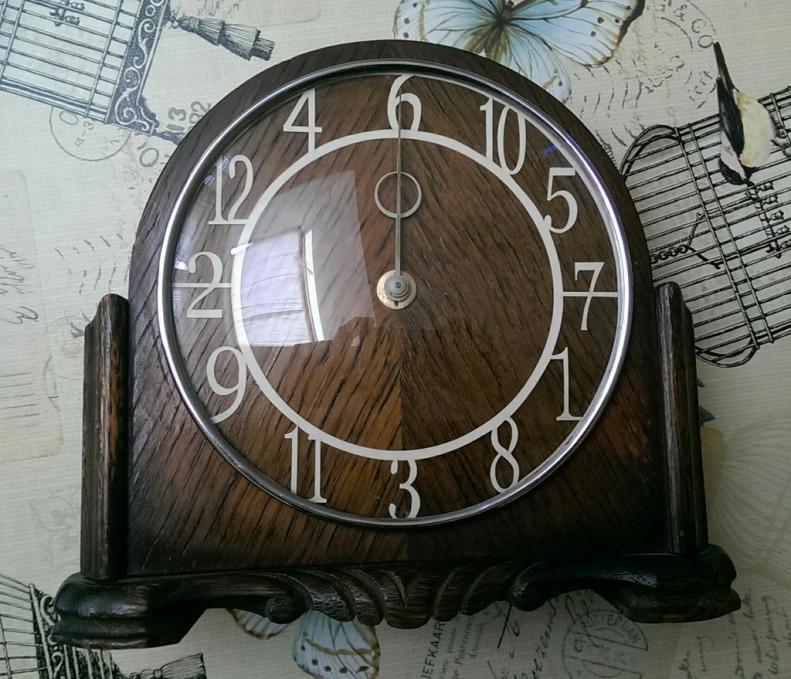

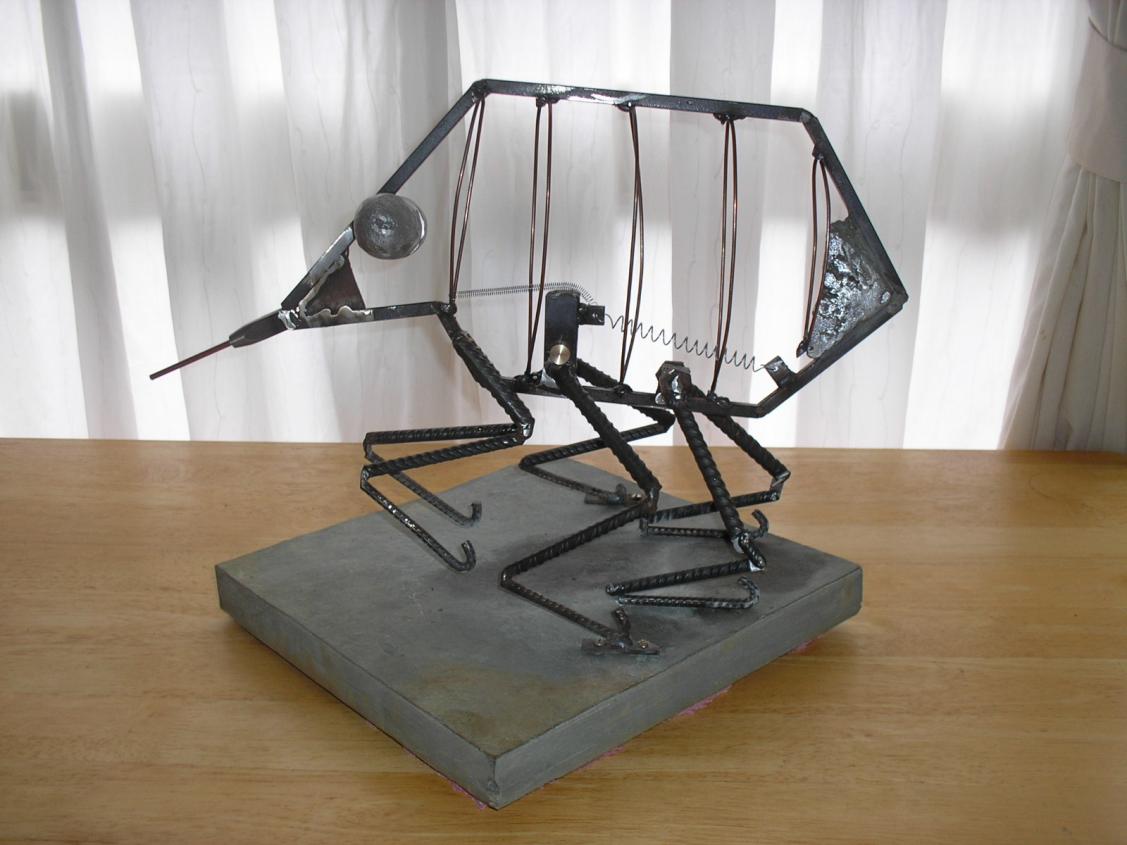

    Most of my things are tools or fixes but here's some of my arty projects

    I am the same way I always have something to fix up or modify.
    Quality work, how did you attach the bits for the carriage? Those parts look really small even my smallest tip would melt that metal in an instant.

    The wheels on the flea chariot are 5mm, the hubs just 2mm. I silver soldered the axle to the carriage with a small torch then used soft solder and carefully applied flux to attach those so that the wheels still turn.
    I had the flea shipped in from the USA, the wire was a bit tricky as it snapped easily when making the tight turns. I probably should have annealed it but as the other end was already attached to the flea it was not easy. The coin is about the size of a 2p or US Quarter.

    Love that chariot, Andy!
