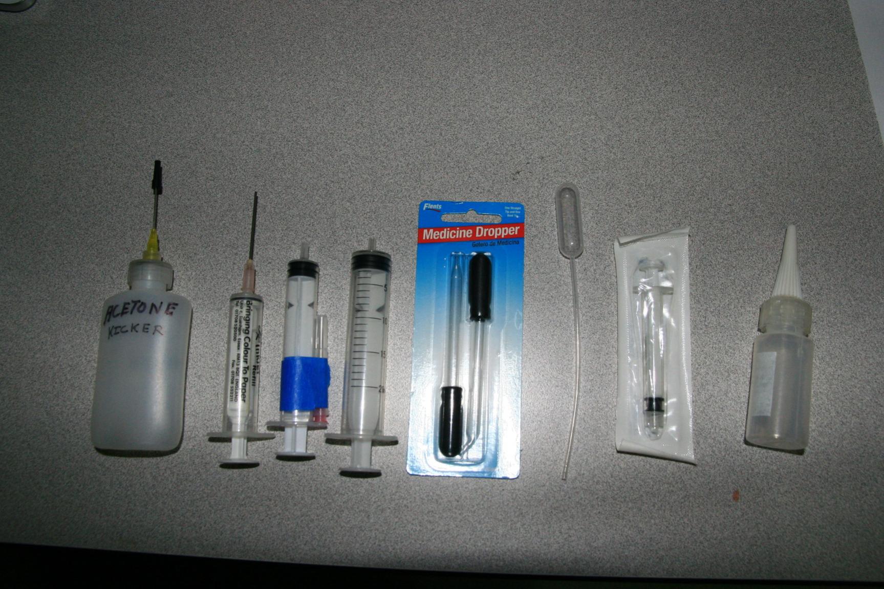

    More "no spill containers
    And don't forget the old ink jet syringes and ink bottles with the long needle tip. Found in the drug store some eye droppers.
    CA glue applicators and some small made to order bottles with tiny tips. Yep I save all that stuff. Great for locktite, acetone,
    oil, blueing and any other thin fluid. Usually they don't spill when tipped over. Watch out for the locktite though, it will seal up the tube!
    Yep, I think I have it......OCD that is.

    When ever I am mixing resins I will go to the feed store and buy the 5 ,10, 50 or 100 CC syringes depending on what resins I may be mixing, The guy used to ask me what size needles I wanted but now he knows that I only want the largest gauge that will fit which ever syringe because the first thing I am going to do is grind off the sharp tip anyway
    The smaller syringes work great for things like sewing machine oils and powdered graphite for freeing up stuck tumblers in locks
