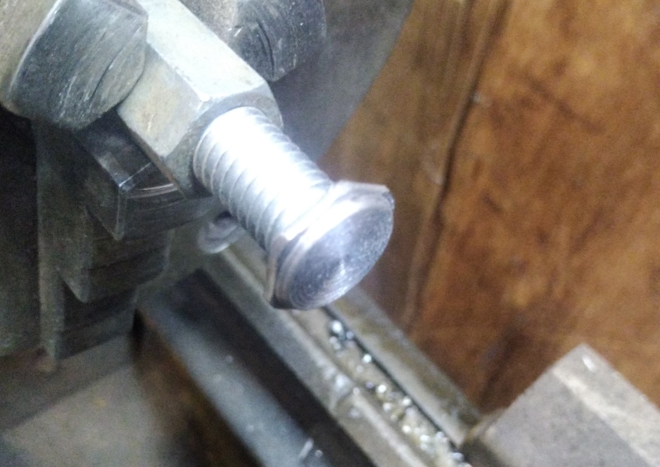

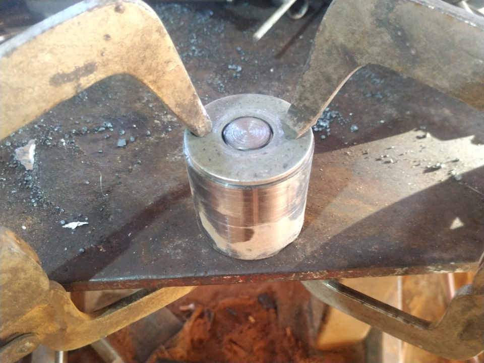

Ever try to locate a 1/2" bolt with a 2" diameter flat head?
if you find them let me know.
Until then I'll have to make my own
starting with a 1/2" bolt bussing the head down to about 1/8" in thickness very minorly rounding the hex sides then welding a hardened washer to them
I use a 1/2" coupling nut as the collet
Attachment 42146
Attachment 42147

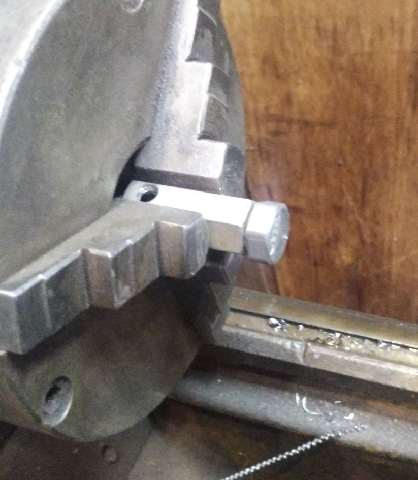

Place the bolt in the holding fixture
Attachment 42148

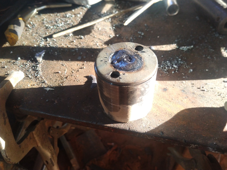

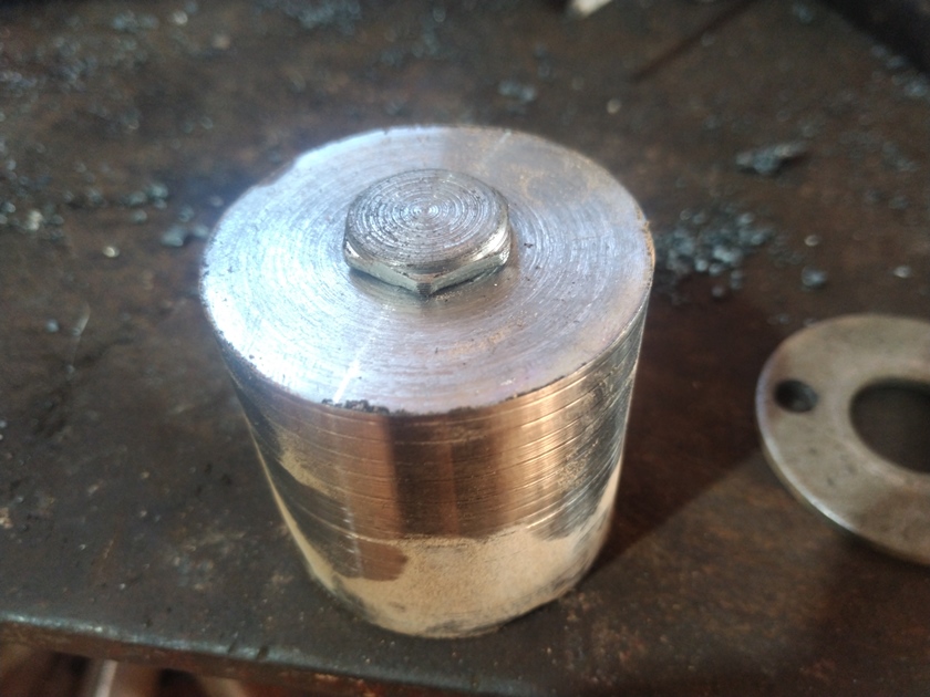

Then clamp the washer with spanner holes drilled in it on the fixture
Attachment 42149

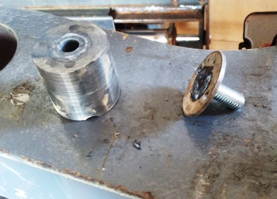

A little welding and I have made some special bolts
Attachment 42150
Attachment 42154
Attachment 42155
