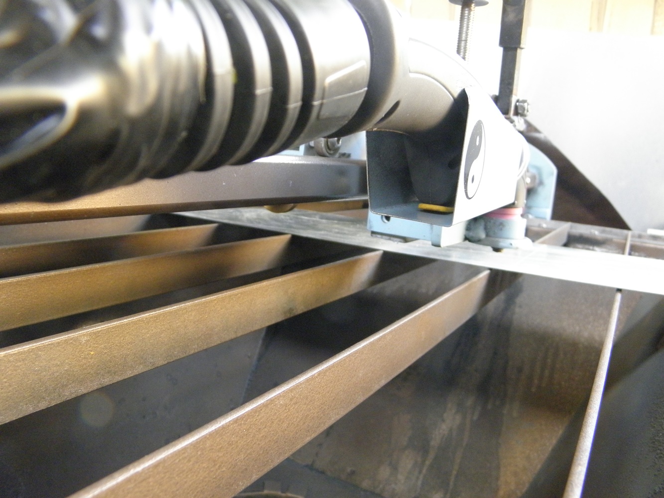

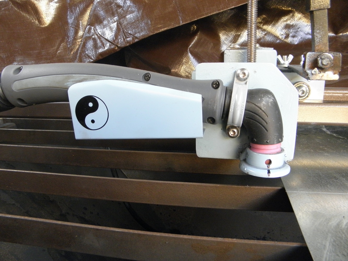

    Spark Deflector. Made from sheet metal. the trigger area is getting a lot of hot metal on the trigger guard causing plastic to melt. this guard stops it form getting hit by hot sparks.
