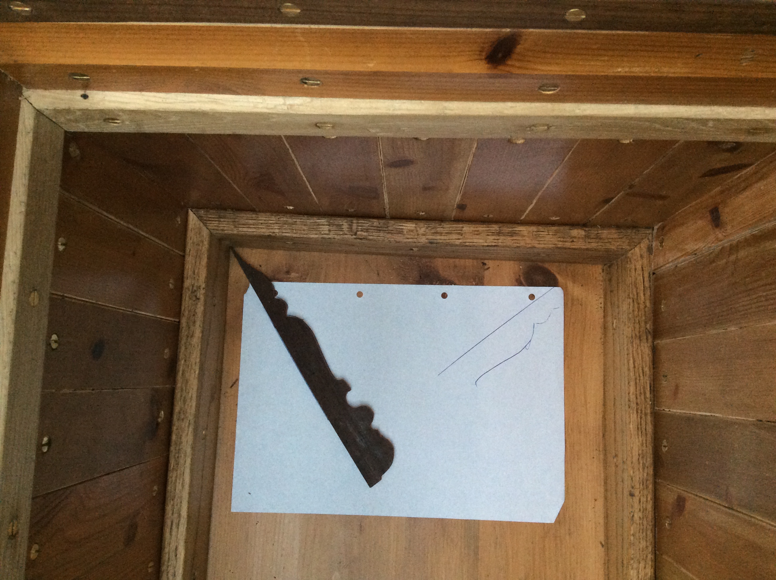

    Yes, I take your point, Peter, ha ha. I could not think of anything else to use as an example. It was merely to show the technique. The last time I did this was to fit an oak window board into an irregular masonry opening.
    Spiling sticks, joggle sticks and a “digital” rule-05e708b8-ade9-4c16-90f5-79fb92d9d202.jpeg
    Were you to fit a board to fit the bottom of this ( slightly tapering) chest I made, you might find the method helpful. While I might scribe using compasses, it’s never occurred to me before to move the spiling stick and pencil simultaneously
