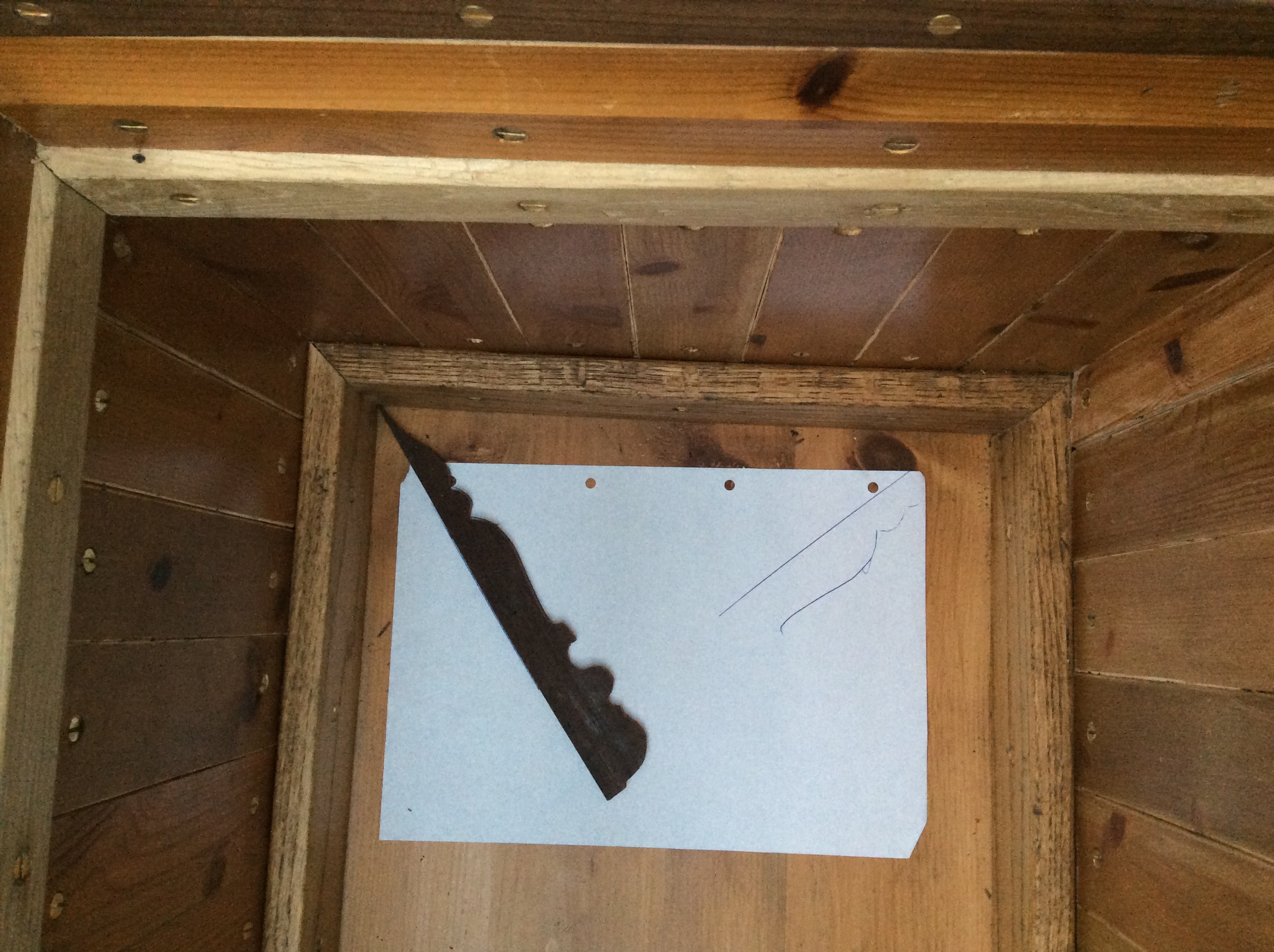

Yes, I take your point, Peter, ha ha. I could not think of anything else to use as an example. It was merely to show the technique. The last time I did this was to fit an oak window board into an irregular masonry opening.
Attachment 41419
Were you to fit a board to fit the bottom of this ( slightly tapering) chest I made, you might find the method helpful. While I might scribe using compasses, it’s never occurred to me before to move the spiling stick and pencil simultaneously
Peter, the video is not the best example of the process either. Imagine a much more complex shape. For example fitting a counter top into the galley of a boat. Or fitting a V-berth into the bow of a boat. You want it to fit snug against the side to things do not slip between it and the side of the boat. There are no straight lines. There is nothing good to use for reference points. You just have to "map out" the size and shape by creating your own reference points.
The scribing technique you describe certainly works in a lot of situations, but that is dependent on the angle of the stick, or scribe or compass, etc remaining constant to in relation to the surface being copied.
