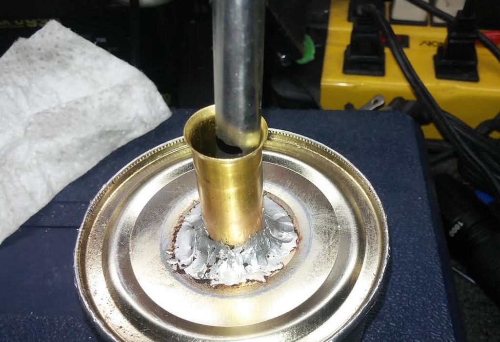

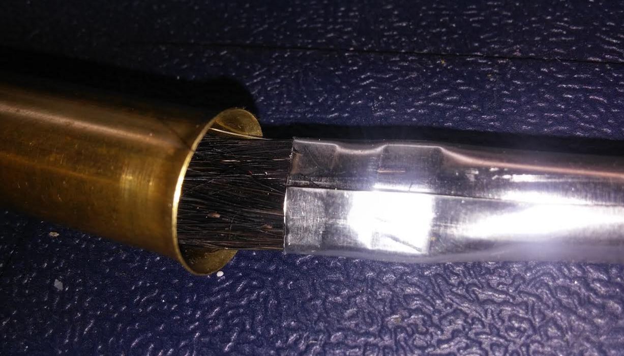

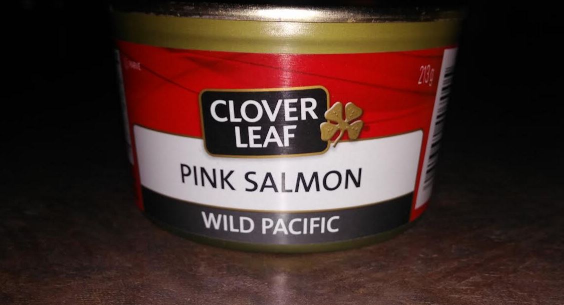

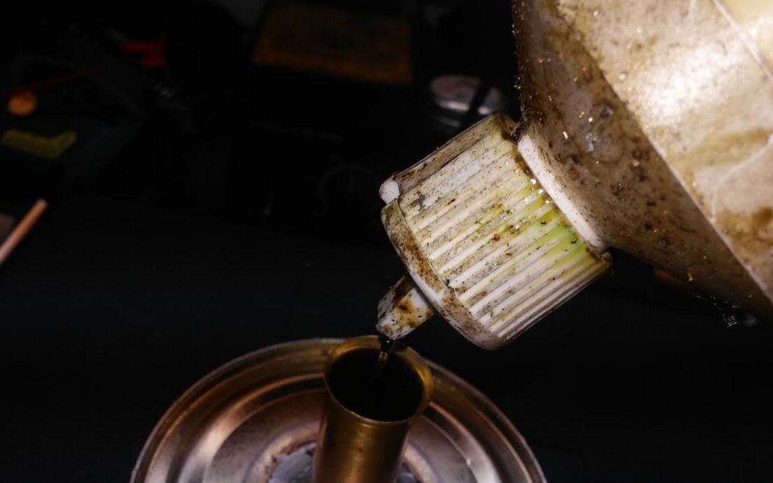

    Here are a few pictures of a spill free container
    that I build for my shop . I forgot to take a picture before
    soldering everything but there is a rare earth
    magnet in the container. It stay on my lathe tail stock with cutting
    fluid in it Enjoy
    I like this size container

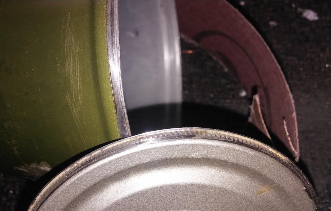

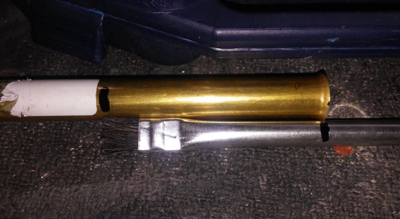

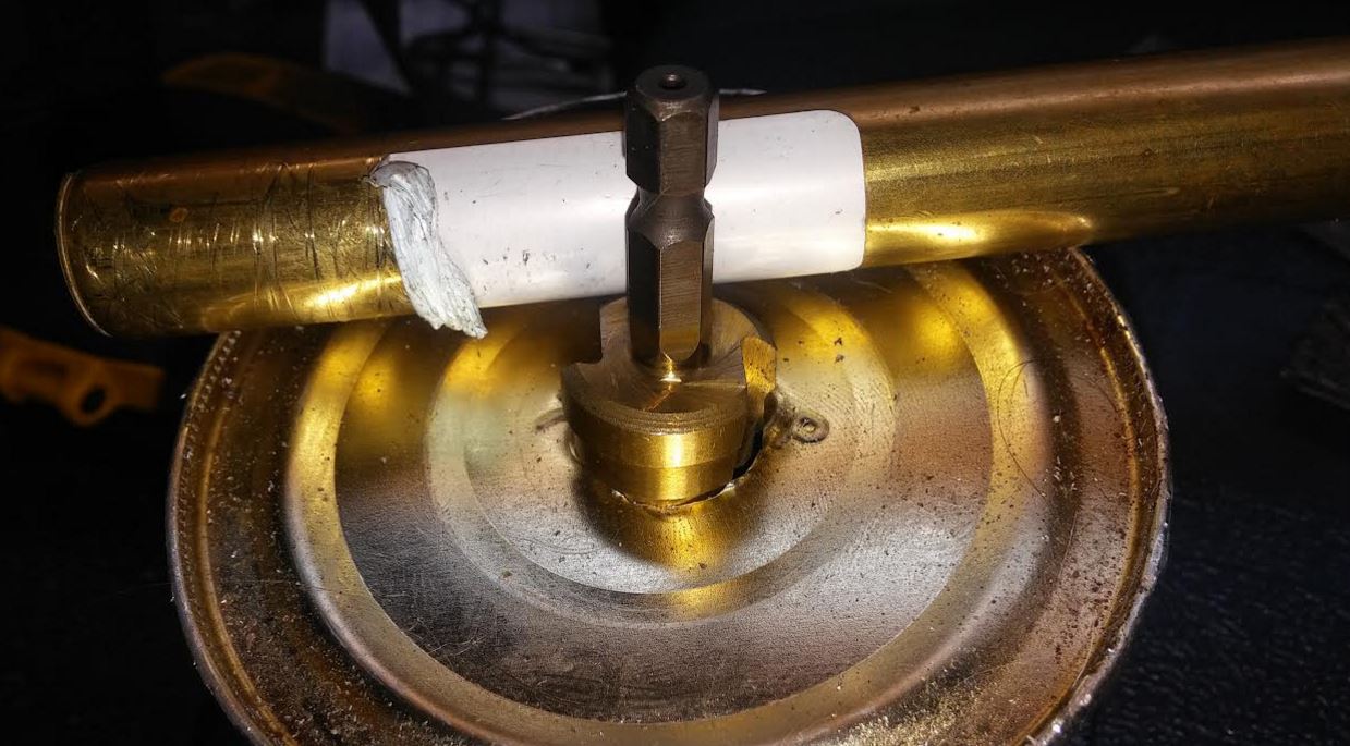

    once empty and clean you must sand the edge before soldering

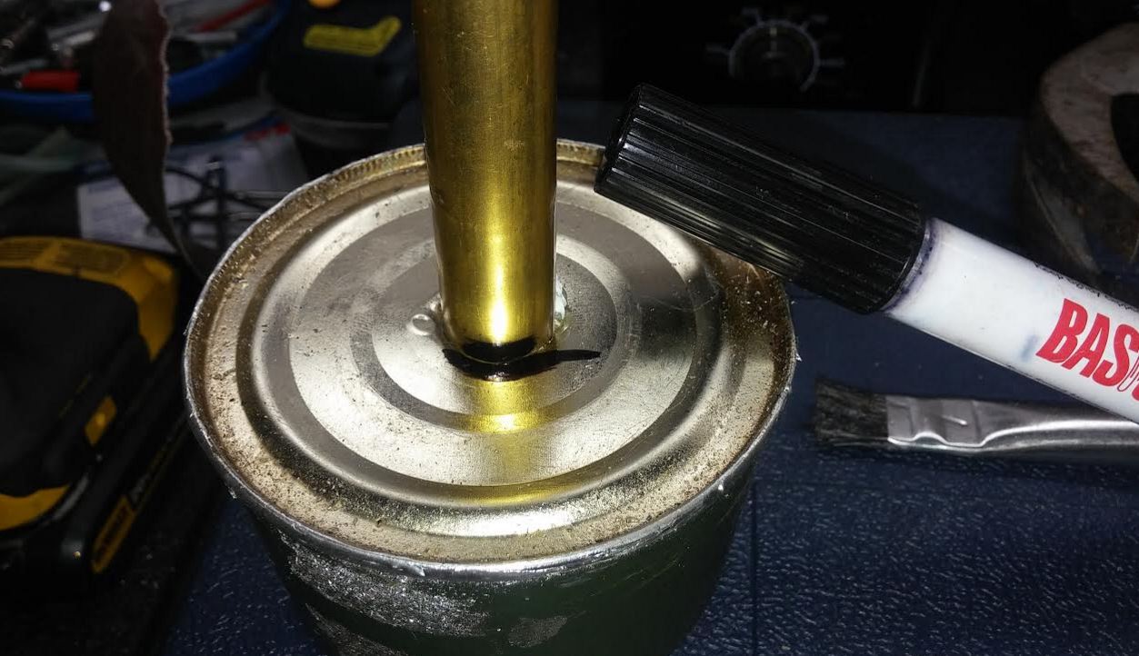

    I used .062 solder make the job easier

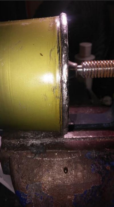

    I then hold everything rite with a C clamp and solder the joint

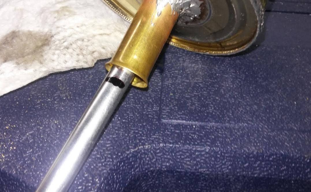

    then I find a small brass tubing to fit my brush

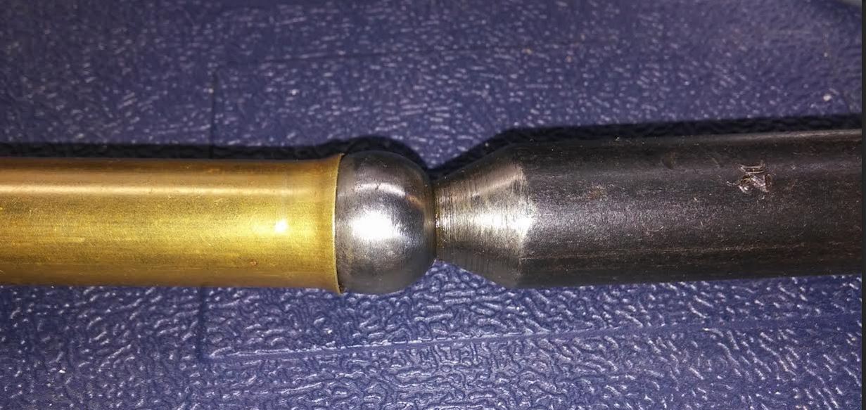

    I use a damping punch to make a nice flare
    stop my brush from shredding

    I then mark how long I need to cut the pipe, it's push all the way to the bottom.

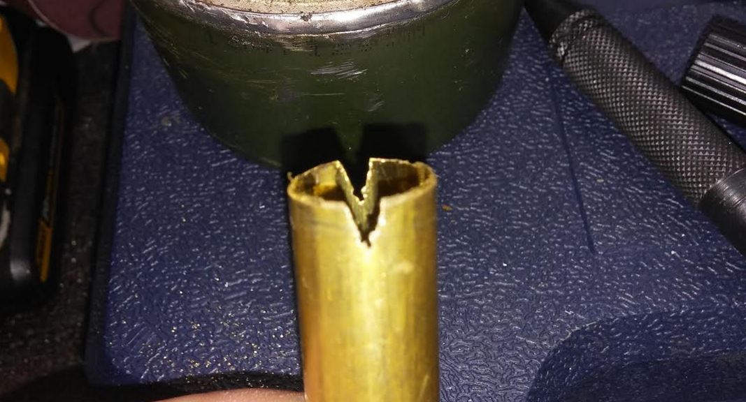

    on the other end I make a small V with a file

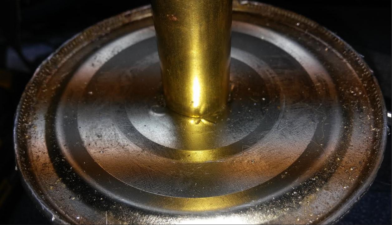

    then I solder my pipe as straight as possible and fill it to about half
    and Voila you can flip this upside down if you wish and nothing will come out
    enjoy
