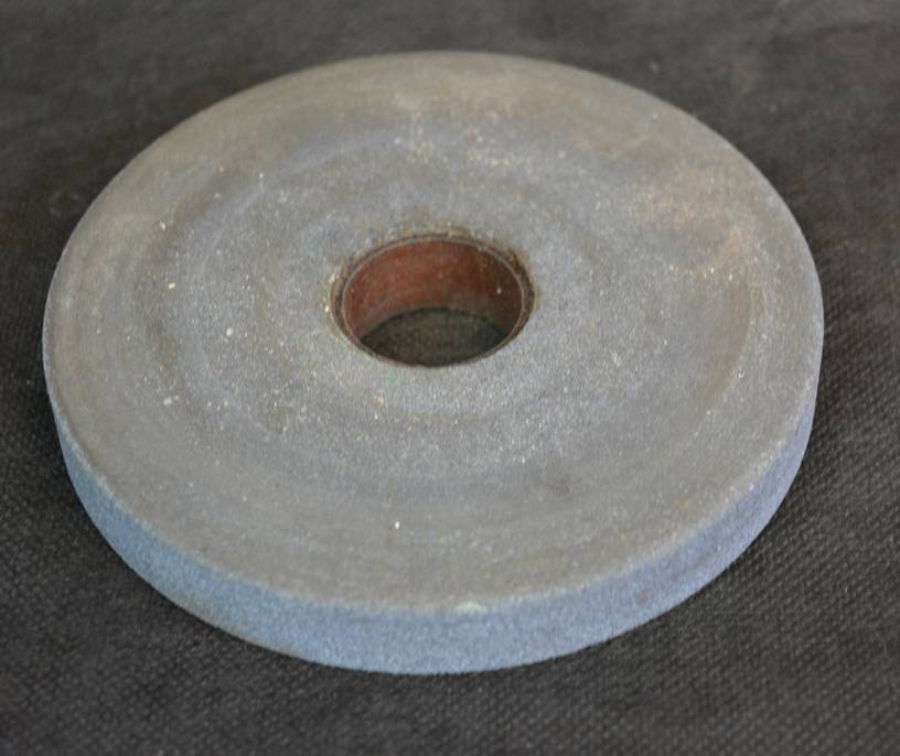

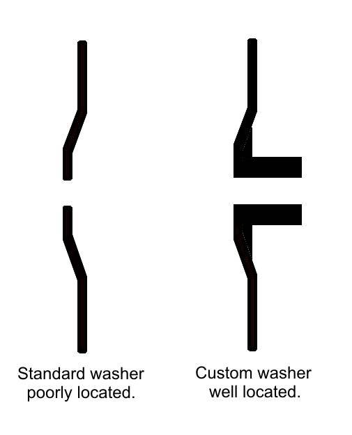

    When ever I replace the wheels on any of my bench and arbor grinders which is rare, the first thing I do is true all 3 sides of the wheel. .....
    In my experience even cheap grinding wheels are made very flat and of even thickness. If that is generally the case then any lateral runout must be due to the grinder itself. Bench grinders generally have wheel washers which are quite thin and which bear up against inadequately sized shoulders on the shaft. This locates the washers very poorly as regards to wobble.
    This is easily attended to and only needs doing once for any particular grinder.
    I junk the inner washers and make a combined washer and stub shaft to hold a wheel with a larger diameter hole. I make this washer/shaft piece to be a light push fit on the grinder shaft. Unless the grinder shaft is bent this ensures that the washer will hold the wheel with the minimum of lateral wobble. Only rarely have I needed to true the sides of a new wheel.
    Split Point Drill sharpening-grindingwheellocation02.jpg Click for full size images.
    Wheel with oversized hole.
    This shows the comparison to the usual stock wheel inner washer of the custom washer/shaft that I use.
    I use the narrow style washer on the outside of the wheel because that is free to align with the wheel, all the location is done by the inner custom piece.

    Tony, I am in full agreement with your observations, on my bench grinder the locating shoulder for the inner washer is only 2mm larger than the thread, couple that with a cheap stamped washer its not surprising that run-out is common. The only only wheel that has run true from the off is my CBN cup wheel and that is the one I had to make a custom mounting for. The next time I need a wheel change I will copy your idea.

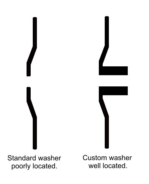

ID:	27585 Click for full size images.
    Speaking about washers which is another word for flanges as I understood, I give you an idea which comes from one of my fists parallels small jobs during apprenticeship, it was in a shop where they use one meter stone wheels for grinding paper cutters which surely doesn't exist now, they learn me to make flanges as possible with only a third of the diameter touching the stone, and now, making those flanges for 50 to 125mm. wheels in aluminum I make them with like a large band touching on the outside and a centered center as you explain, the recess is less than 5/10 of a mm., 300grams paper as inter-layer, that give good results when forming the outside profile with the Fluidmotion/Vertex tool which needs a very stable centering.
