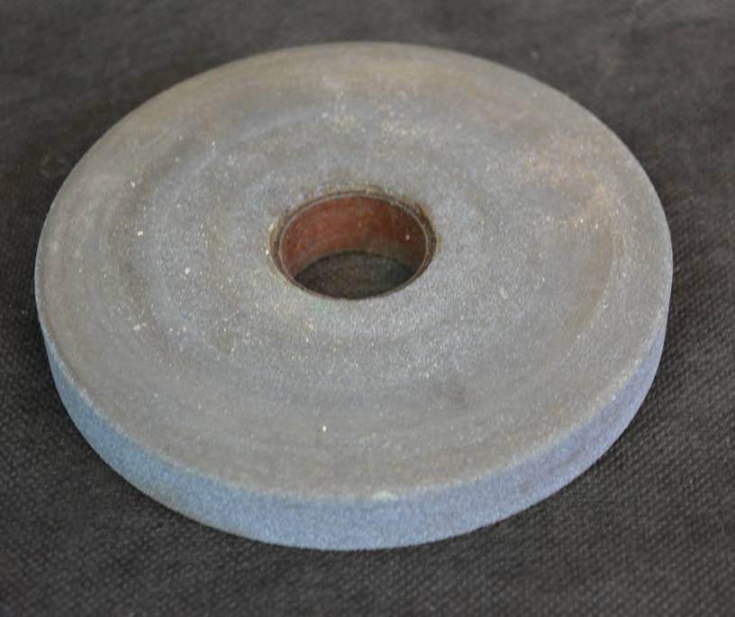

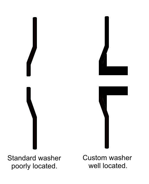

In my experience even cheap grinding wheels are made very flat and of even thickness. If that is generally the case then any lateral runout must be due to the grinder itself. Bench grinders generally have wheel washers which are quite thin and which bear up against inadequately sized shoulders on the shaft. This locates the washers very poorly as regards to wobble.
This is easily attended to and only needs doing once for any particular grinder.
I junk the inner washers and make a combined washer and stub shaft to hold a wheel with a larger diameter hole. I make this washer/shaft piece to be a light push fit on the grinder shaft. Unless the grinder shaft is bent this ensures that the washer will hold the wheel with the minimum of lateral wobble. Only rarely have I needed to true the sides of a new wheel.
Attachment 27585 Click for full size images.
Wheel with oversized hole.
Attachment 27587
This shows the comparison to the usual stock wheel inner washer of the custom washer/shaft that I use.
I use the narrow style washer on the outside of the wheel because that is free to align with the wheel, all the location is done by the inner custom piece.
Tony, I am in full agreement with your observations, on my bench grinder the locating shoulder for the inner washer is only 2mm larger than the thread, couple that with a cheap stamped washer its not surprising that run-out is common. The only only wheel that has run true from the off is my CBN cup wheel and that is the one I had to make a custom mounting for. The next time I need a wheel change I will copy your idea.

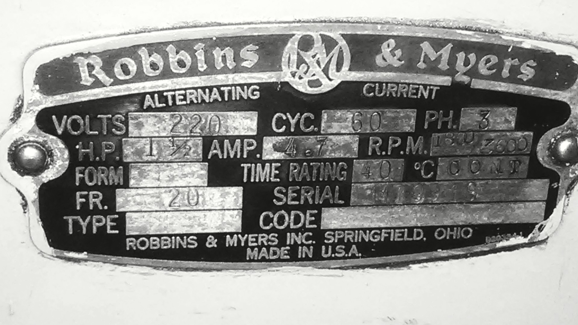

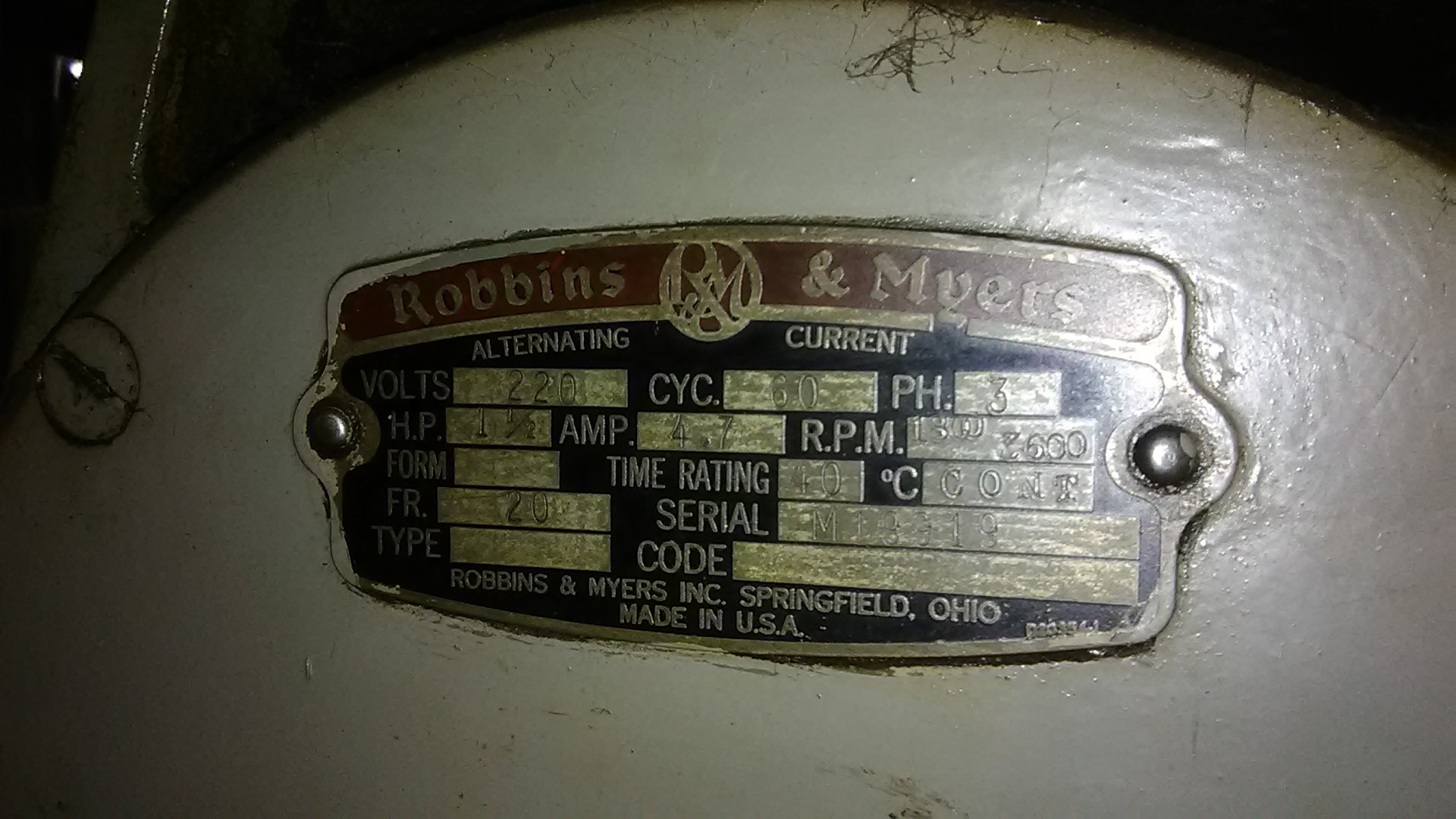

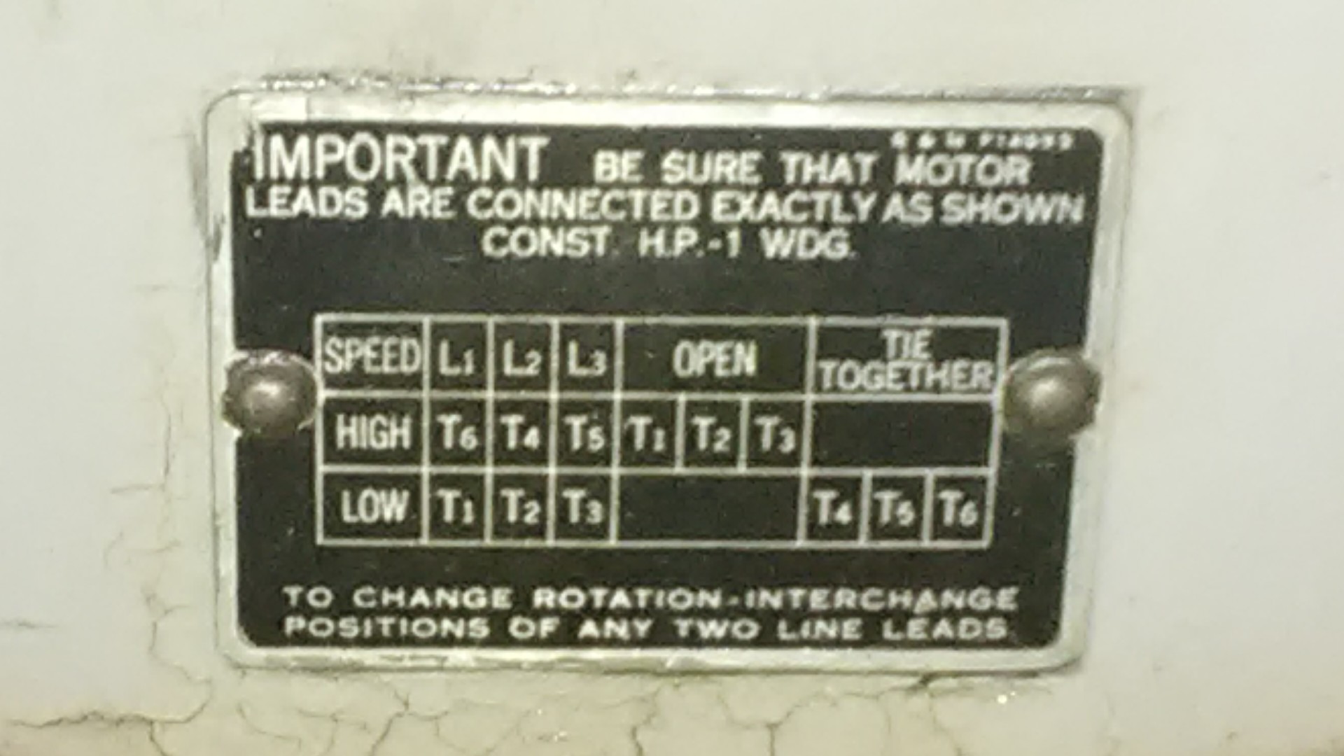

3000 rpm motors have two poles, 1500 rpm have four poles. Sometimes you find a four pole motor where all the winding connections are brought out such that with a bit of switching it acts like a two pole motor.
These two speed motors can be very useful on a machine tool, lathe or mill, because you can run at half speed with near double the torque compared to running a two pole motor at half speed with a VFD. This can often eliminate the need for back gears to go slow with high torque.
I had a lathe with a motor like yours 2/4 pole, I kept the motor when I scrapped the lathe (the bed was worn right down in one area due to its previous life) and I now use the motor on my shock absorber dyno. It is driven by a VFD but being able to switch pole numbers is handy.
Your motor must be 50 Hz not the US 60 Hz. The synchronous speeds for a 60 Hz (US made or sourced motor) would be 1800/3600 rpm. So under rated load yours should spin at around 3450/1725 rpm with reduced torque on American electricity or 2850/1425 rpm at specified torque on everyone else's electricity.
All the above assumes an induction motor.

'We' are correct; me barely, Tony accurate.
In my defense, the tag was very hard to read until cleaning it better.
Attachment 29100
RPM 1800/3600 60Hz 3PH 220V 4.7A

Not unusual to find scattered 50Hz machines, rare though to find unmounted 50Hz motors.
I have two machines at 50Hz that will be remedied with VFD's. One is the 50 NM taper Herbert-DeVleig 4B, other a 40 NM Rambaudi.
Most well built 50 Hz motors will tolerate 60 Hz, of course they will run 20% faster and lose some torque if run on the rated voltage.
I have the opposite, I brought back some machines tools from my time in the US and so I have to run 60 Hz motors at 50 Hz. No problem with 3 ph motors because I run those on VFDs to get full speed, but my lathe has a 2 hp 1 ph motor and so it runs slower than it could. I am currently chasing a 5 hp 3 ph motor to put in its place. I do not need 5 hp but using an oversize motor with a VFD gives good torque at lower speeds than a smaller motor.
As I said before that is a 2/4 pole motor. Today on our favourite auction site I picked up a 5 hp 4/8 pole motor. That means 1500 and 750 rpm. Heavy and big, multipole motors need more iron and copper inside.
I shall fit it to my lathe which will enable me to ditch the two stage pulley system and noisy back gears and replace them with a pole number switch and VFD. I am hopeful that this will produce a smoother and quieter machine capable of the lowest speed that I am likely to need and a faster machine at the other end.
A close to 1:1 pulley and poly-V belt system should be all I need.
