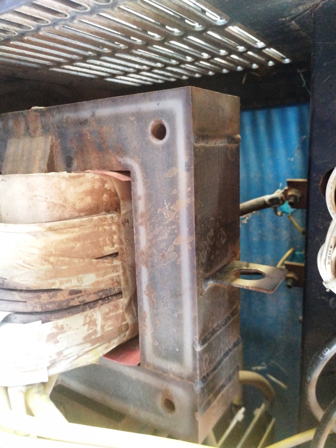

I don't see anything wrong with it. I like the fact you used a much larger transformer to make your spot welder. The ones made with even a large microwave transformer are dismal in power. I even made one several years ago to determine if everyone's claims of the high amperage output was anywhere near real. It takes a lot of core weight to create a large enough magnetic field to achieve enough amps to do any good.
Looking forward to the rest of the build!

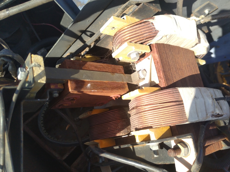

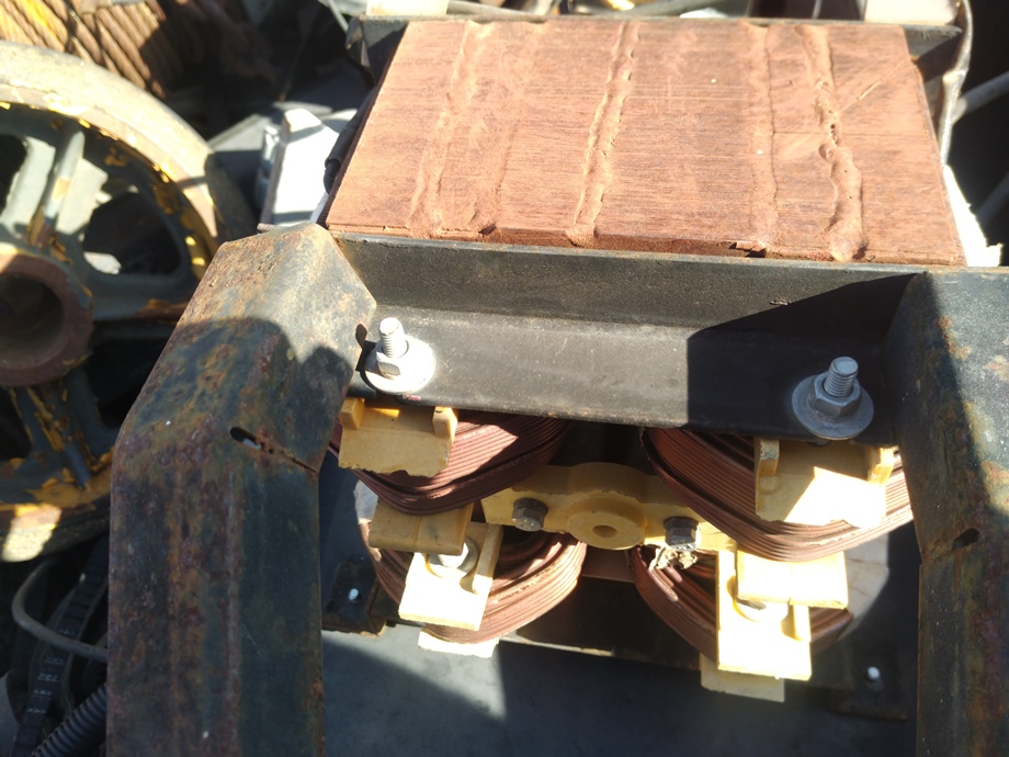

Darkford if you could get your hands on one of these you could regulate the output by moving part of the core in and out of the magnetic field area
These are wleging machine transformers so obviously the secondaries have more turns than a spot welder and would have to be rewound for the higher amperages at lower voltages
Attachment 42676
Attachment 42677
Current can also be controlled by winding the secondary winding with multiple smaller conductors. 2,4,6,8 in hand windings each winding still having the same number of turns, connected in parallel, to keep the output voltages in a similar range
