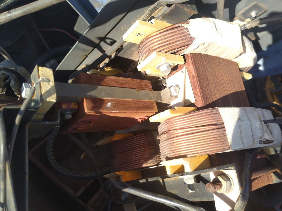

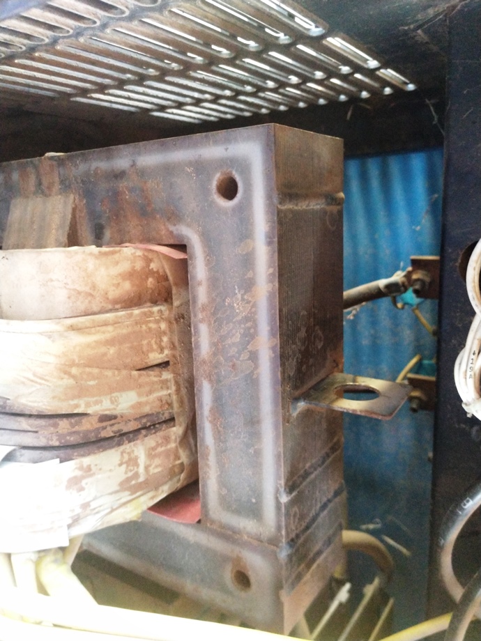

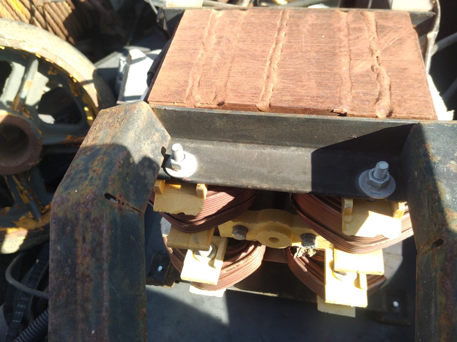

    Darkford if you could get your hands on one of these you could regulate the output by moving part of the core in and out of the magnetic field area
    These are wleging machine transformers so obviously the secondaries have more turns than a spot welder and would have to be rewound for the higher amperages at lower voltages
    Current can also be controlled by winding the secondary winding with multiple smaller conductors. 2,4,6,8 in hand windings each winding still having the same number of turns, connected in parallel, to keep the output voltages in a similar range
