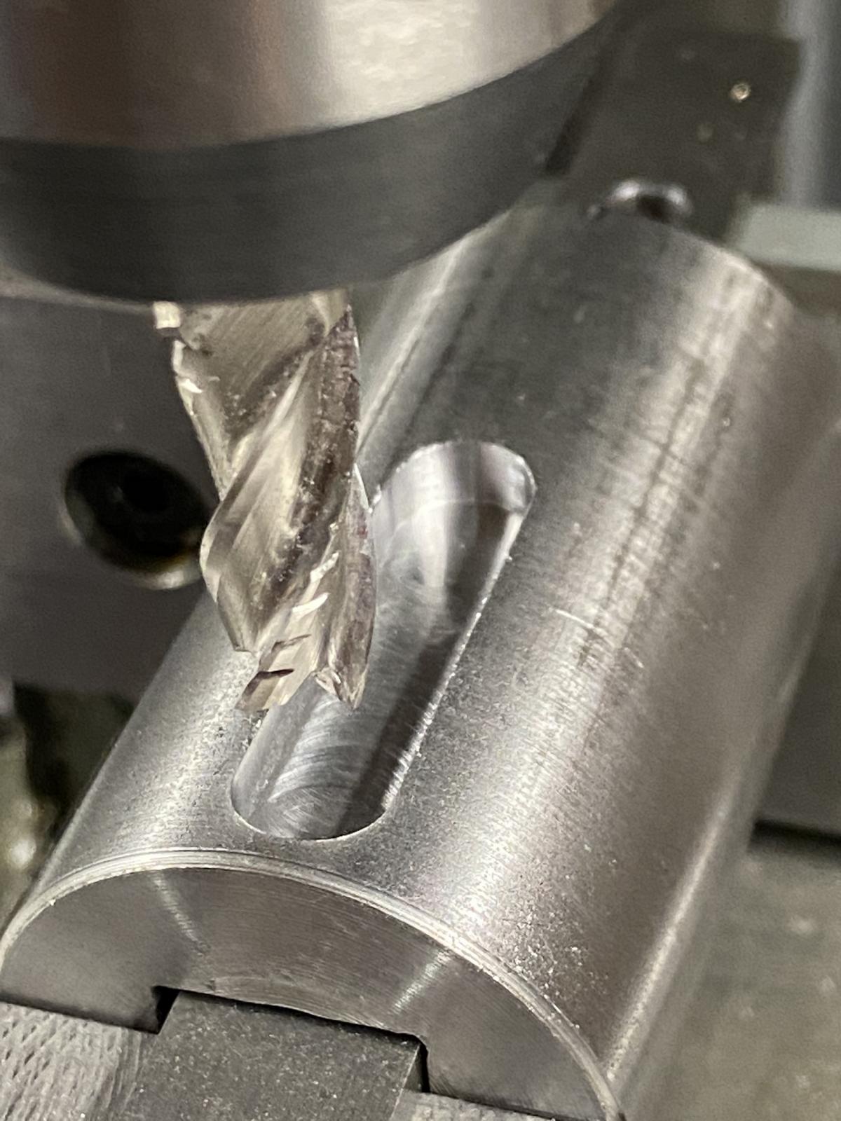

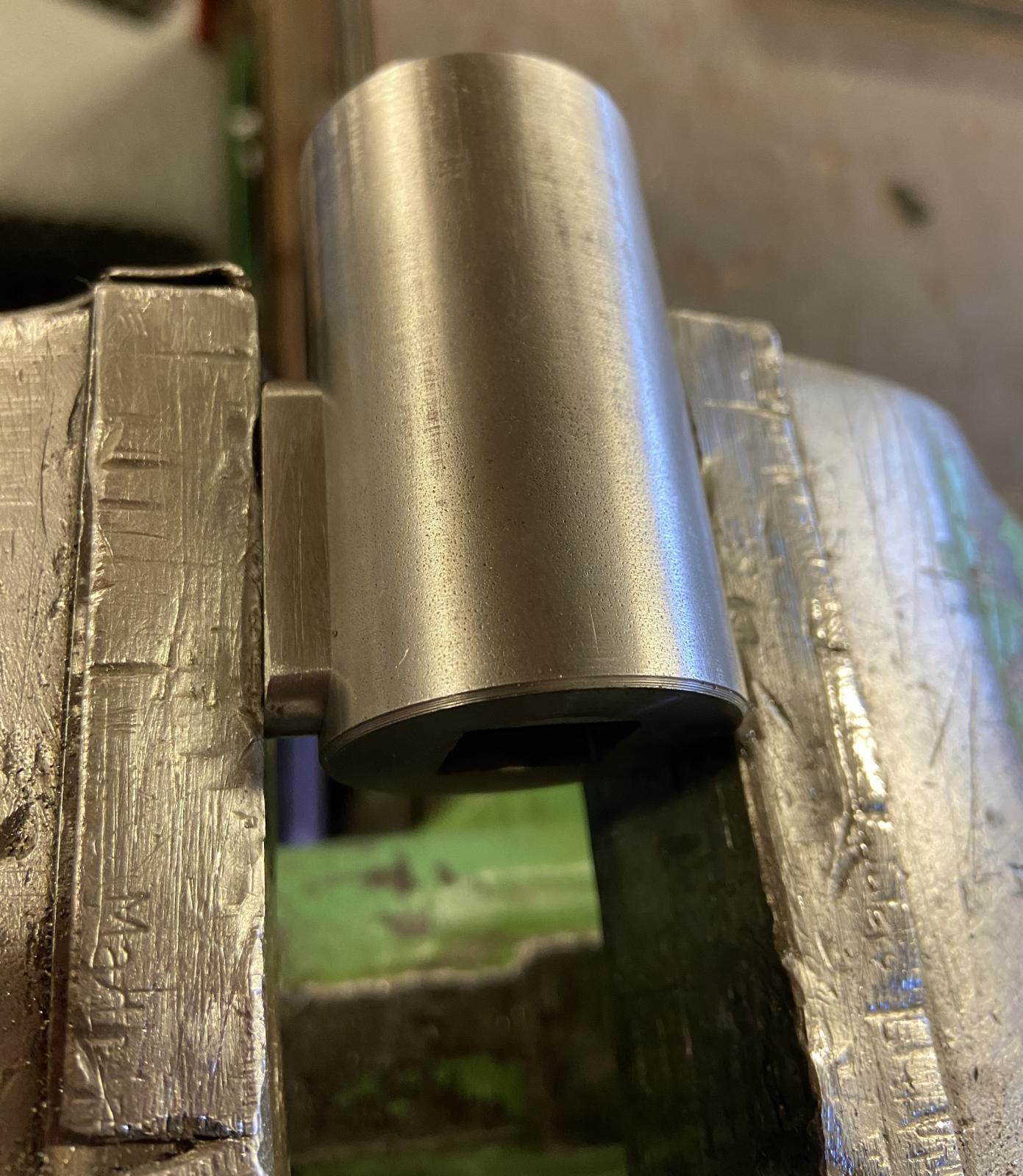

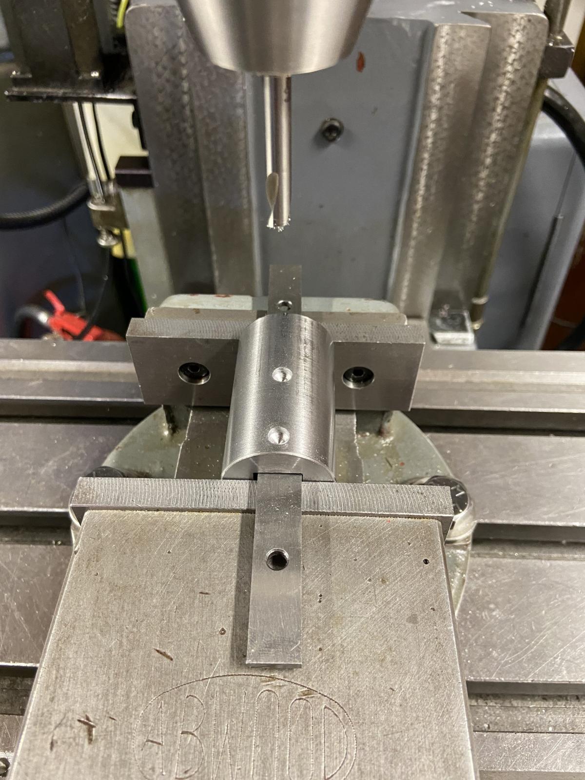

The taper lock pulley and bushed arrived so the first process was to cut the keyway. The adaptor bush was set up in the mill vice and to ensure the orientation of square to keyway position a parallel was used to align.
Attachment 33156 Parallel used across vice jaws

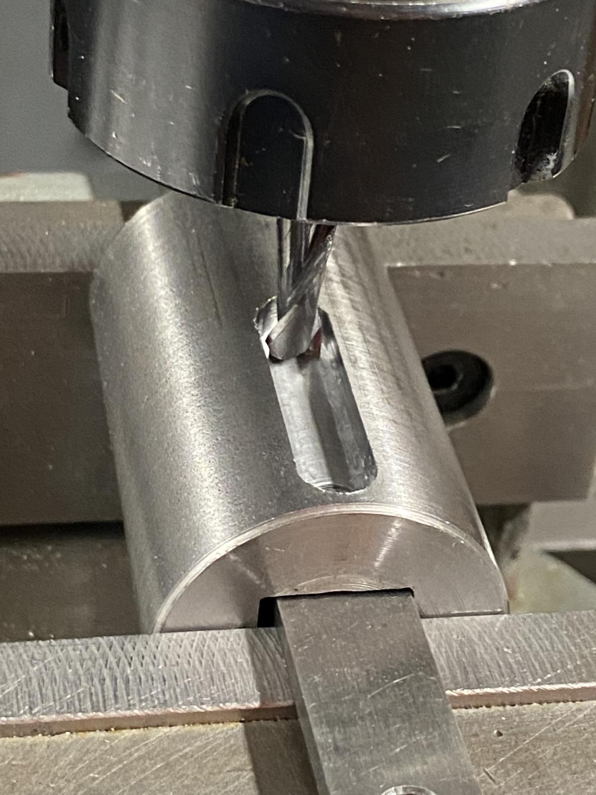

Attachment 33157 Roughing out keyway

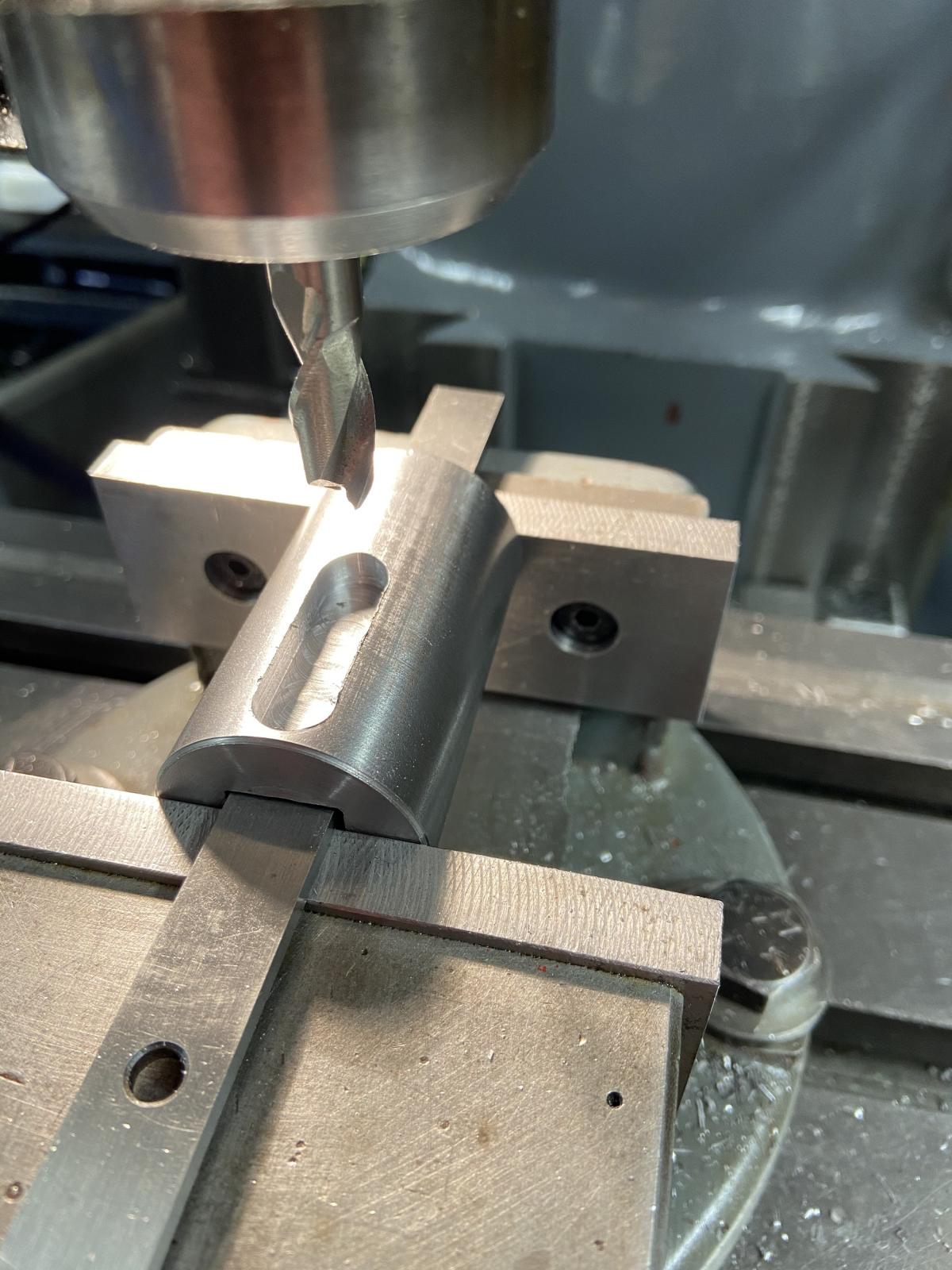

Attachment 33158 Attachment 33159 Finished keyway

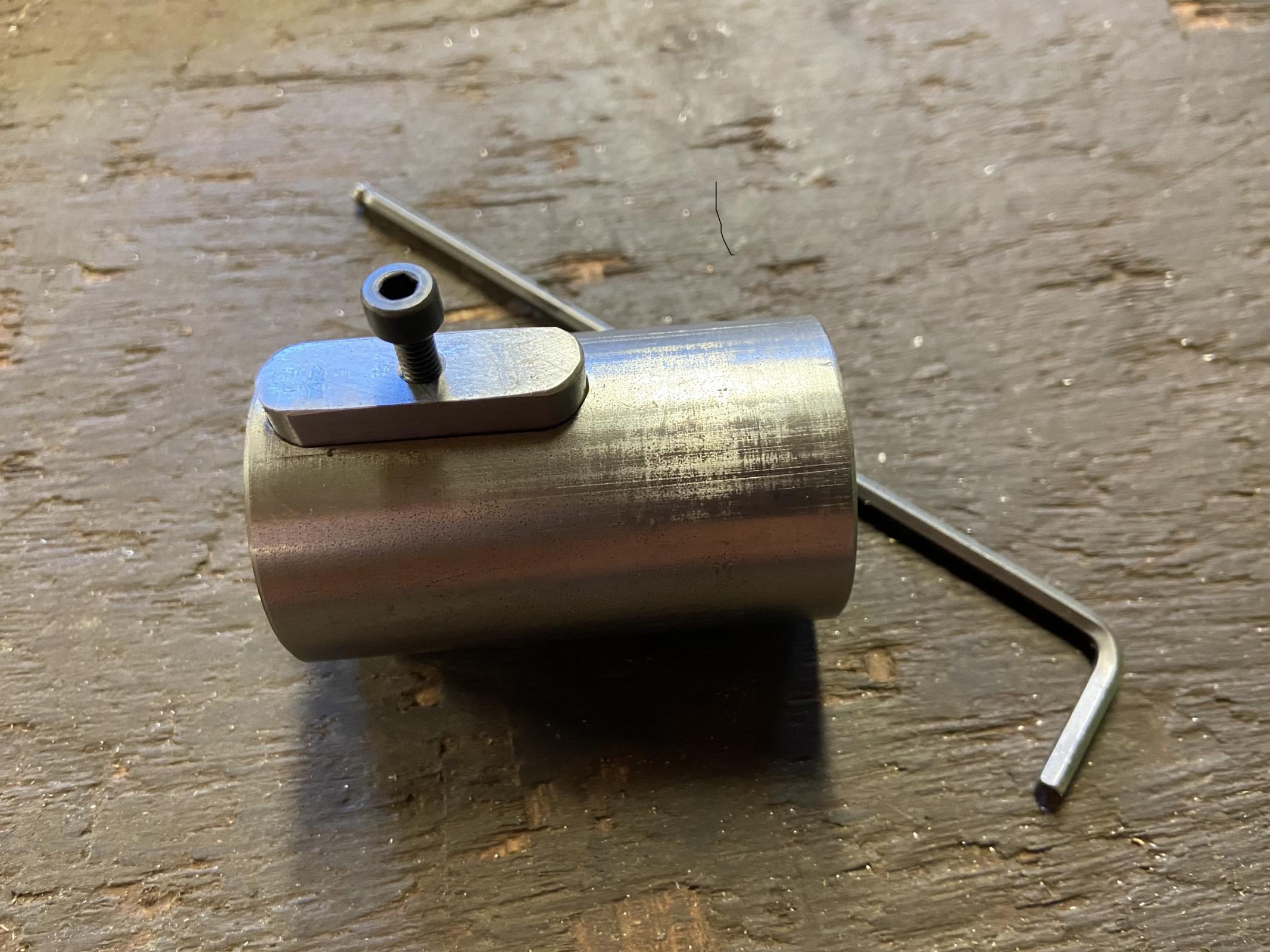

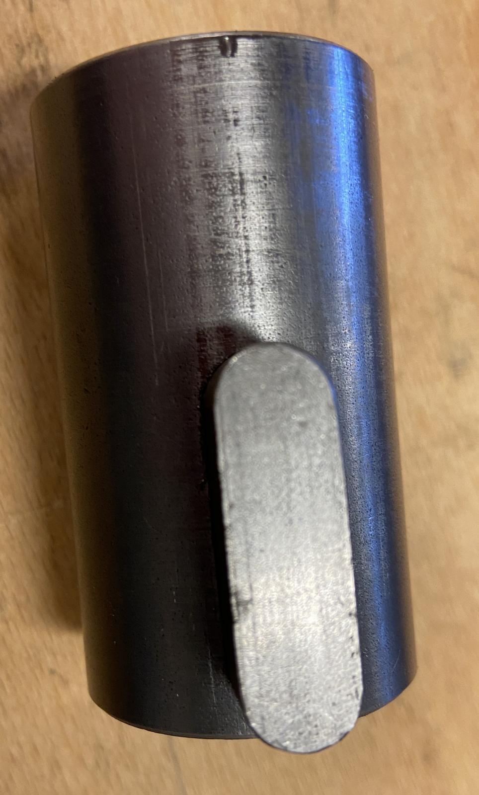

After milling the keyway this was then used as a gauge to make the key.

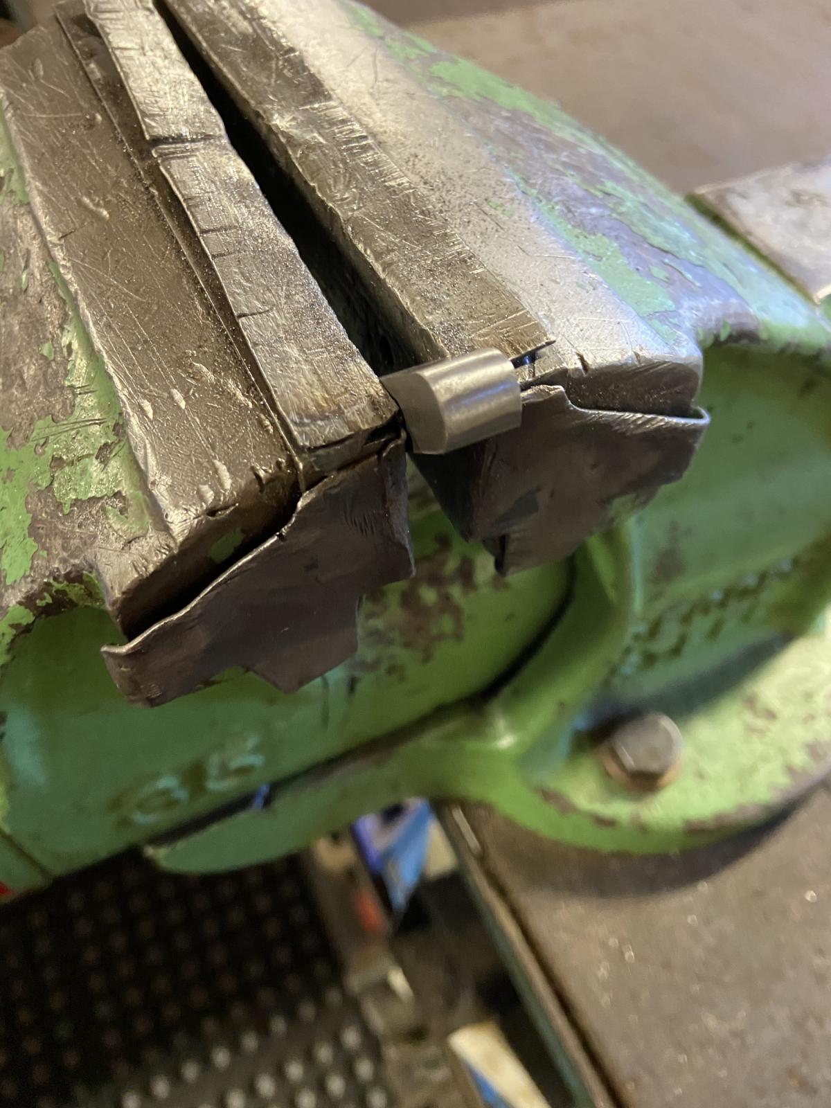

The key was made from a piece of 3/8" square steel cut just over length and ends filed to full radius.
Attachment 33160
One end filed.
Attachment 33161
The machined keyway used as a gauge to check fit.
Attachment 33162

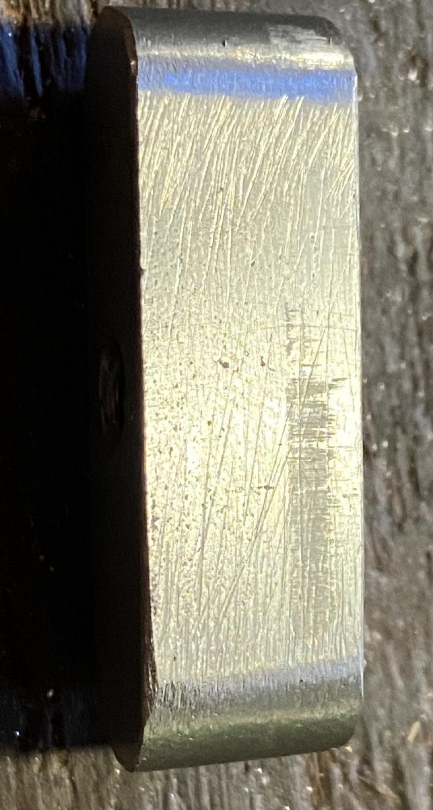

I machine a screw in the middle of the key to aid removal.
Attachment 33163
The key is pushed into the keyway and this highlights the tight spots once removed.
Attachment 33164
Witness spots identifying high spots on key.
Attachment 33166

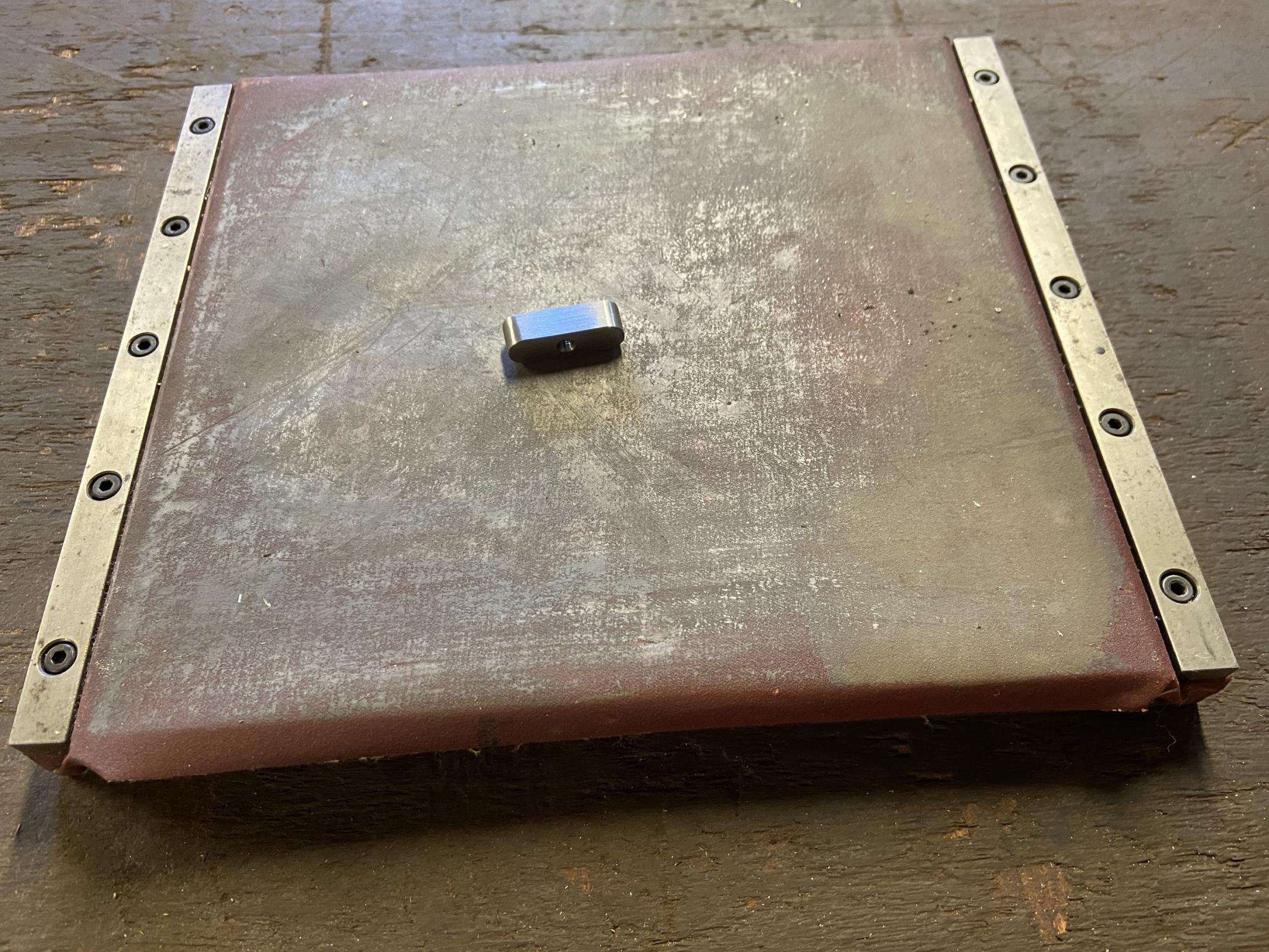

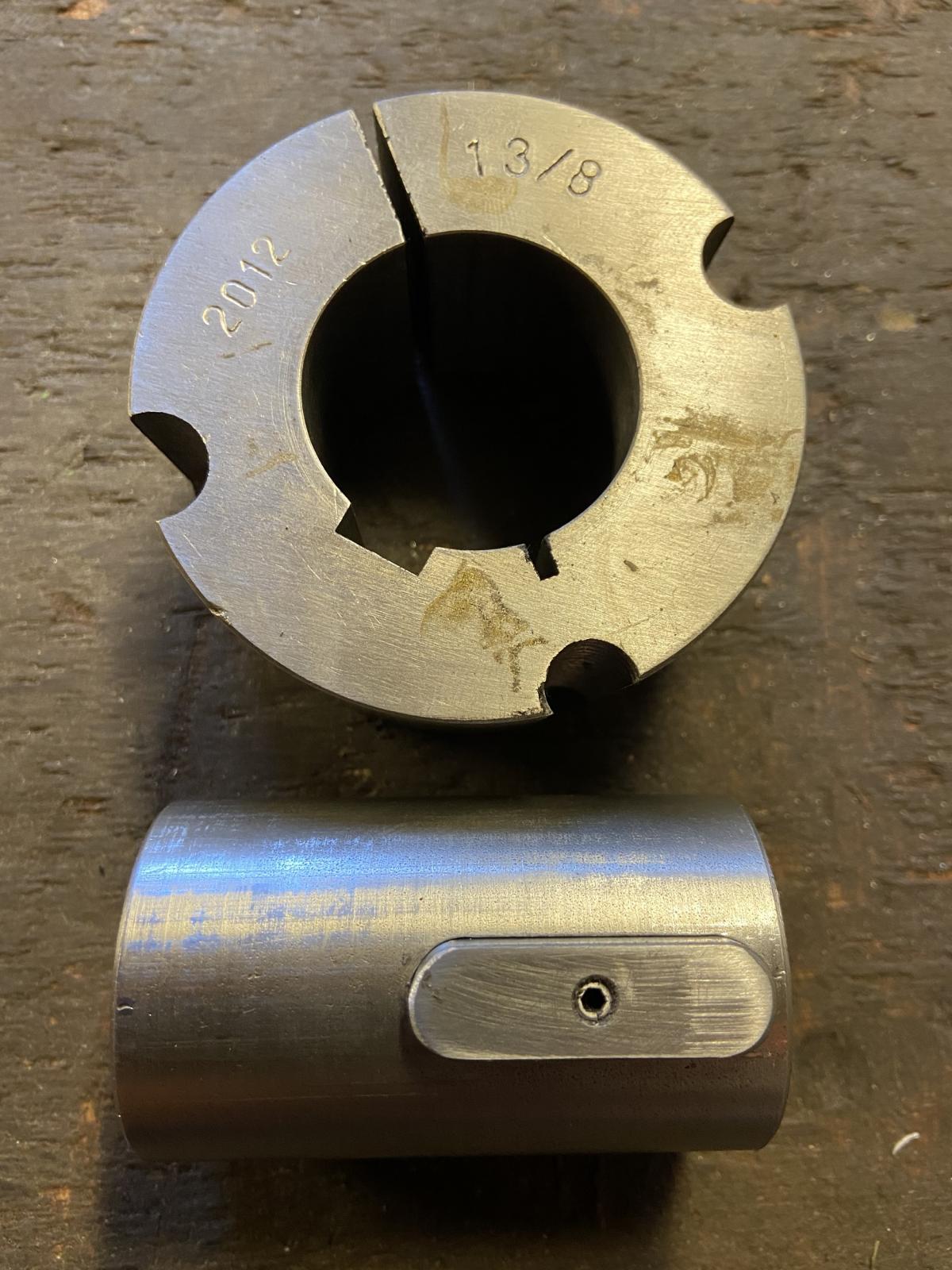

The high spots are removed on the homemade lapping plate.Link to lapping plate: https://www.homemadetools.net/forum/...996#post106055
Attachment 33165 Attachment 33167

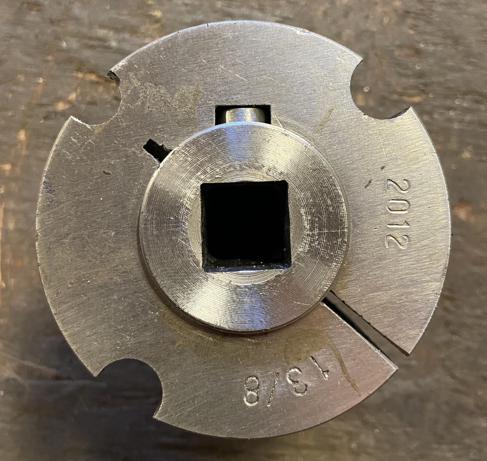

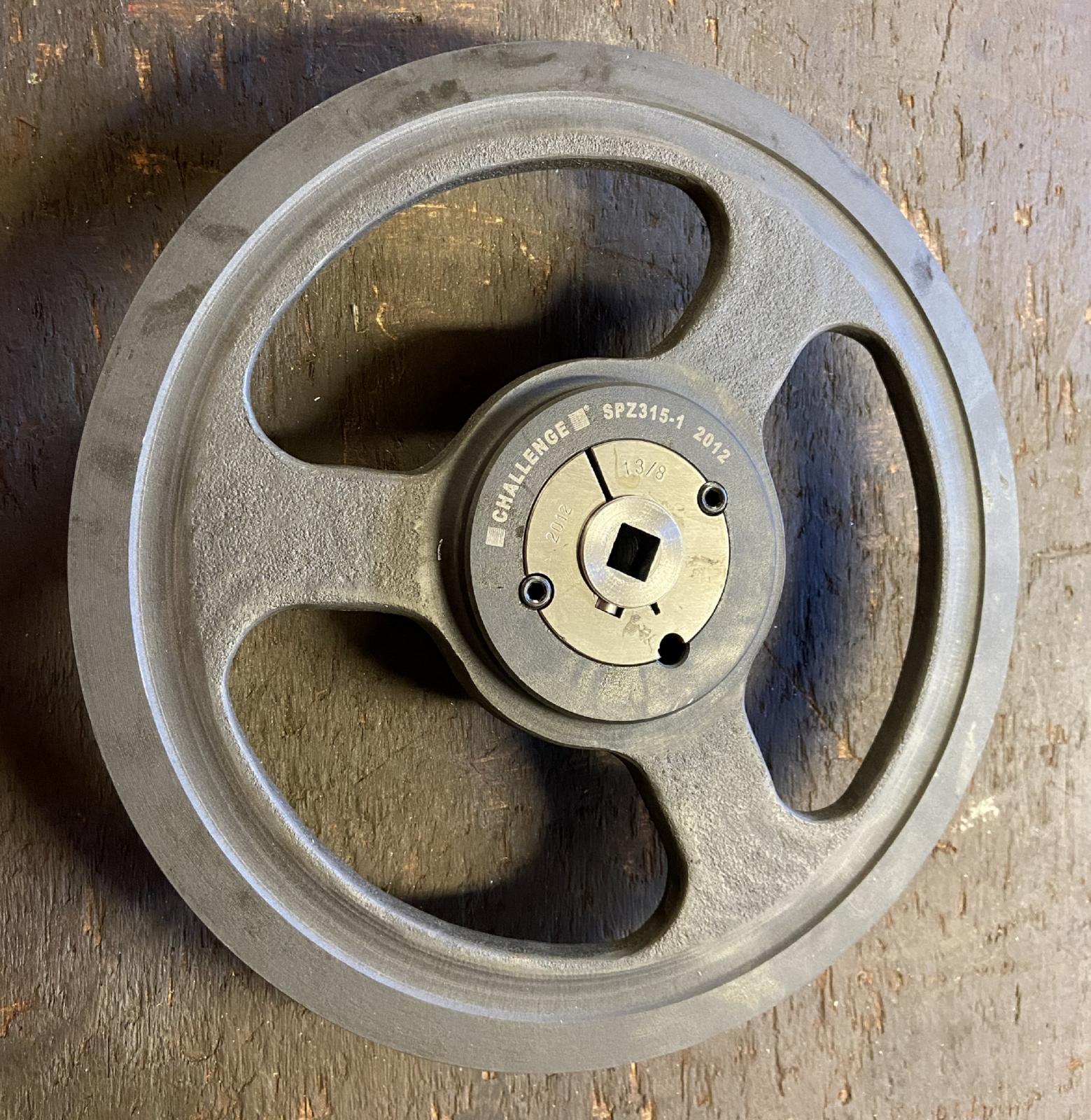

Taper bush and adapter
Attachment 33168

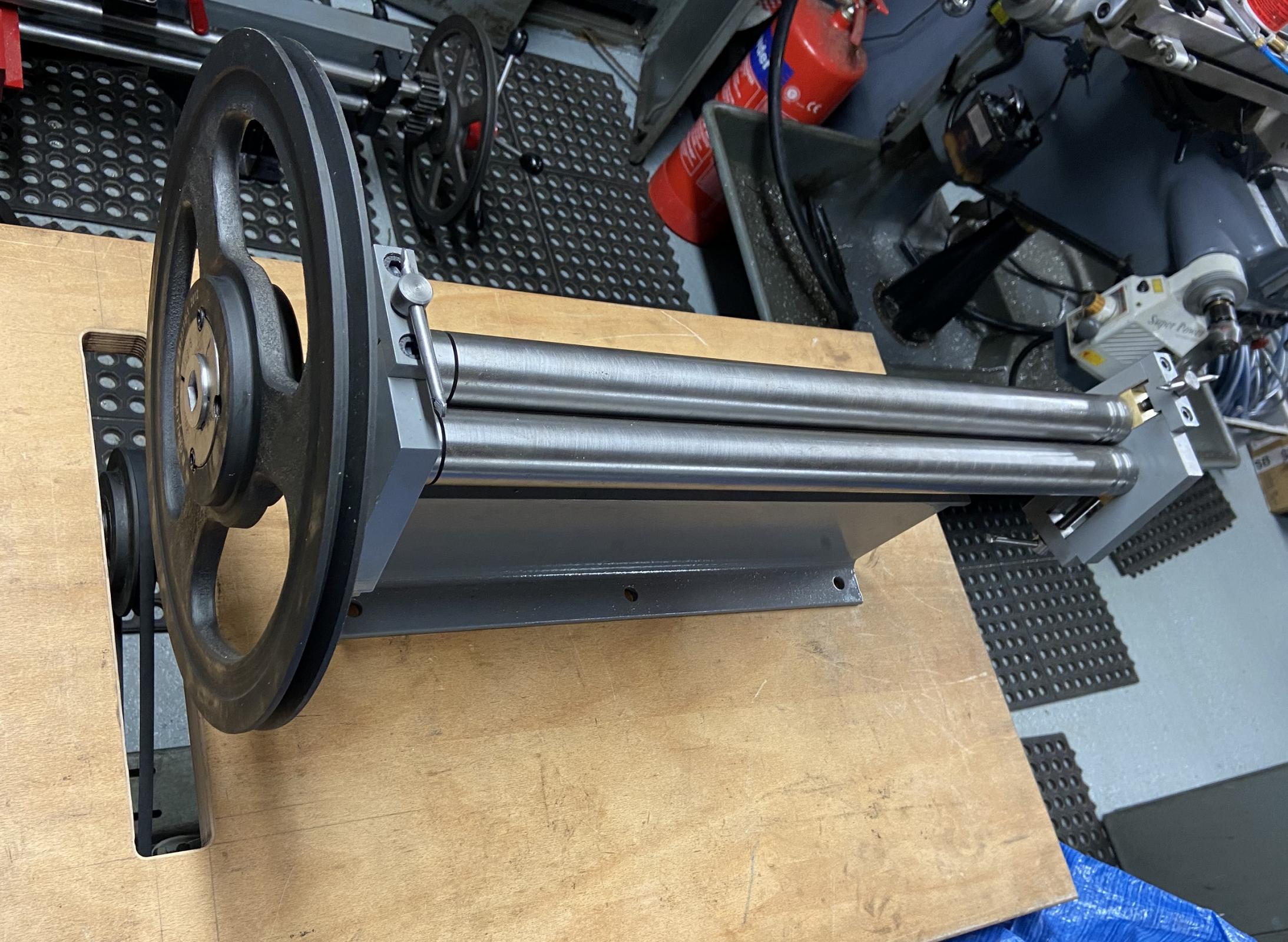

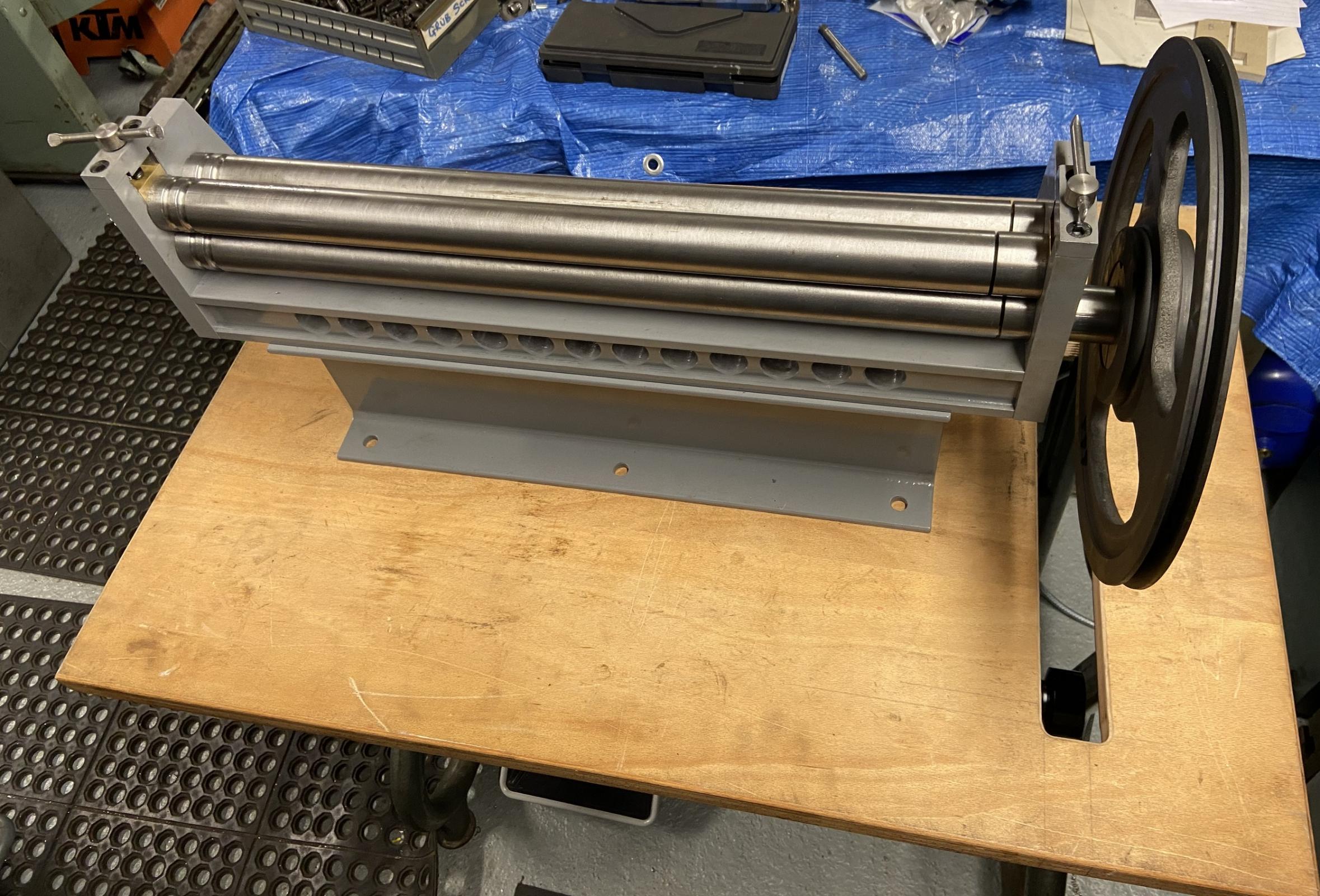

Completed assembly ready to fit to slip rollers.
Attachment 33170 Attachment 33171
Pulley pushed on slip rolls waiting to be positioned correctly and bolted to table top via M8 prong tee nuts.
