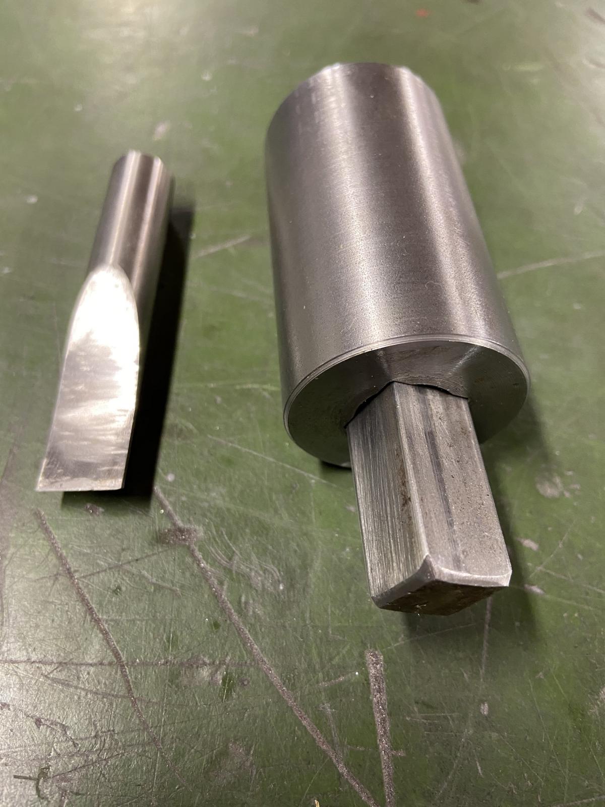

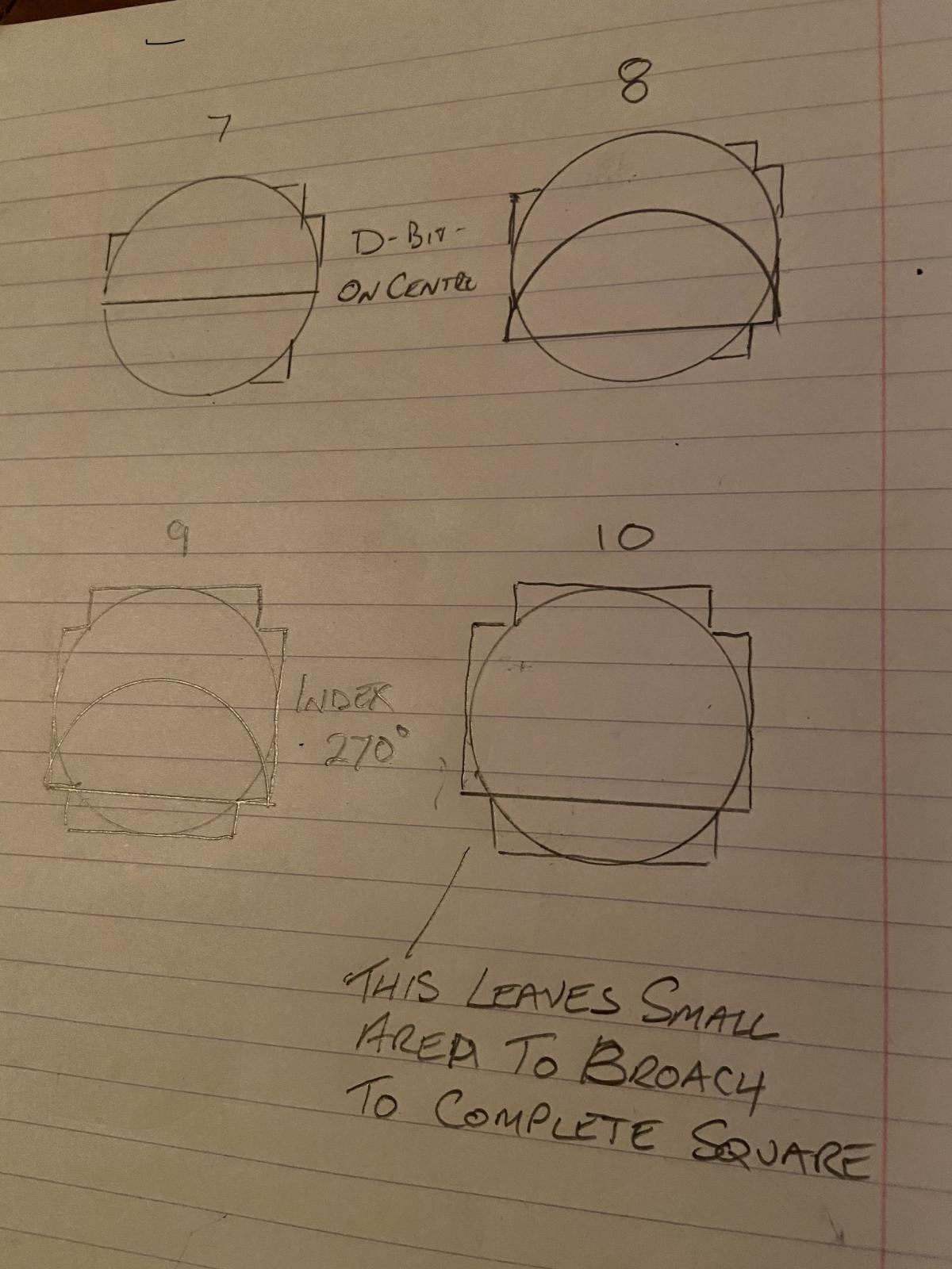

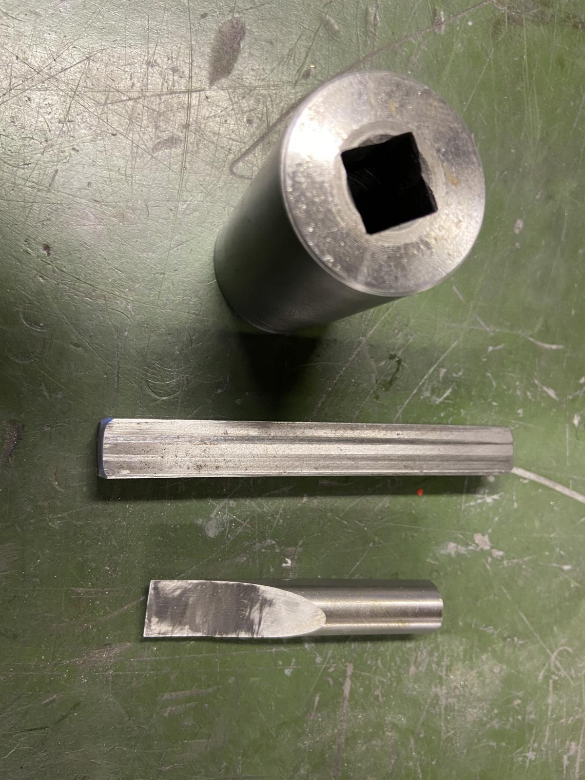

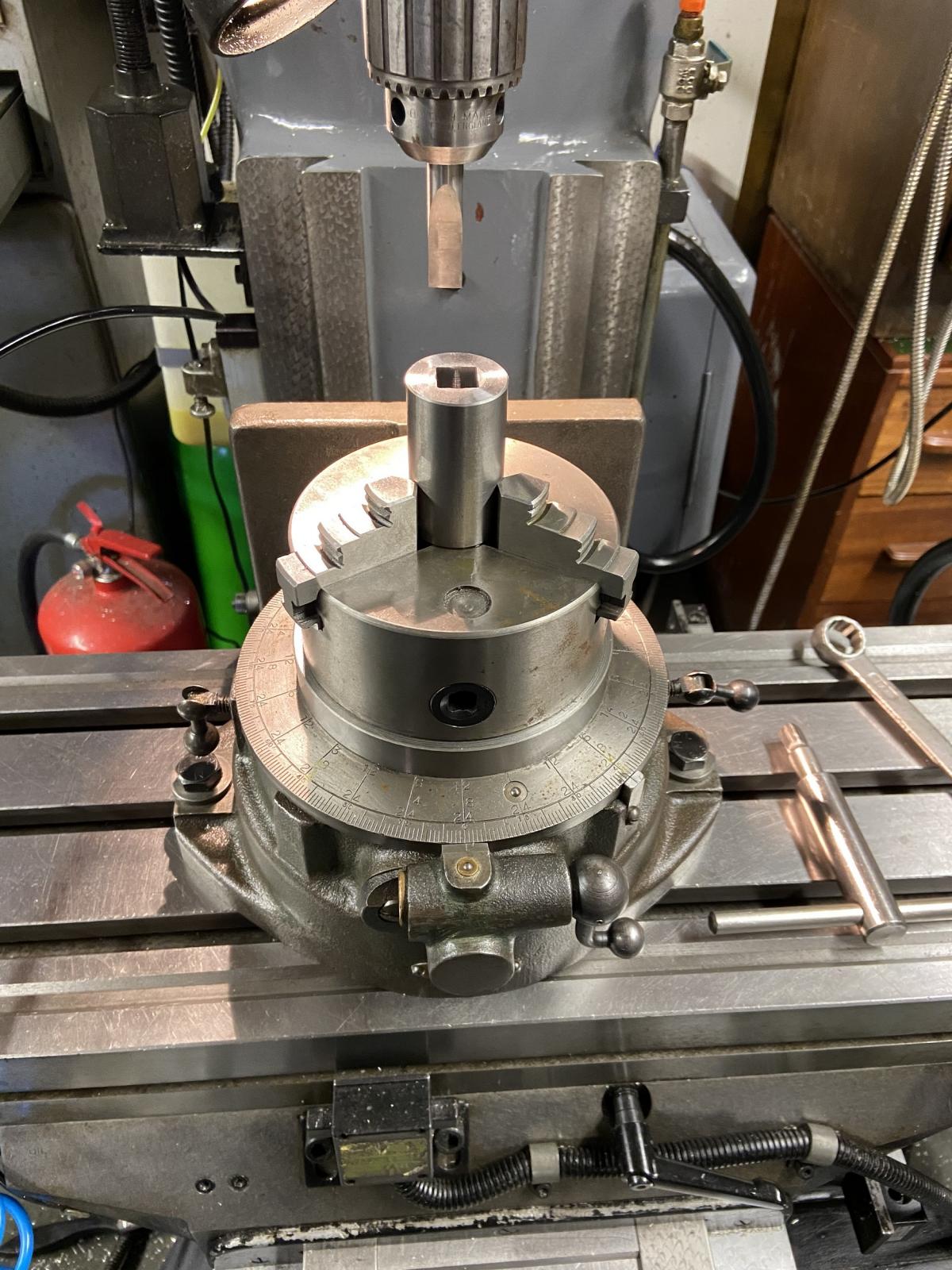

    So I thought I would share with you all how I broach square holes on the mill using an indexing head and a cutter ground like a D-Bit.
    The first operation is to turn the adapter and bore/Drill a hole to finished sized square this is sized across the flats (A/F).
    A D-Bit is then ground from a round piece of high speed steel (HSS) to half its diameter.

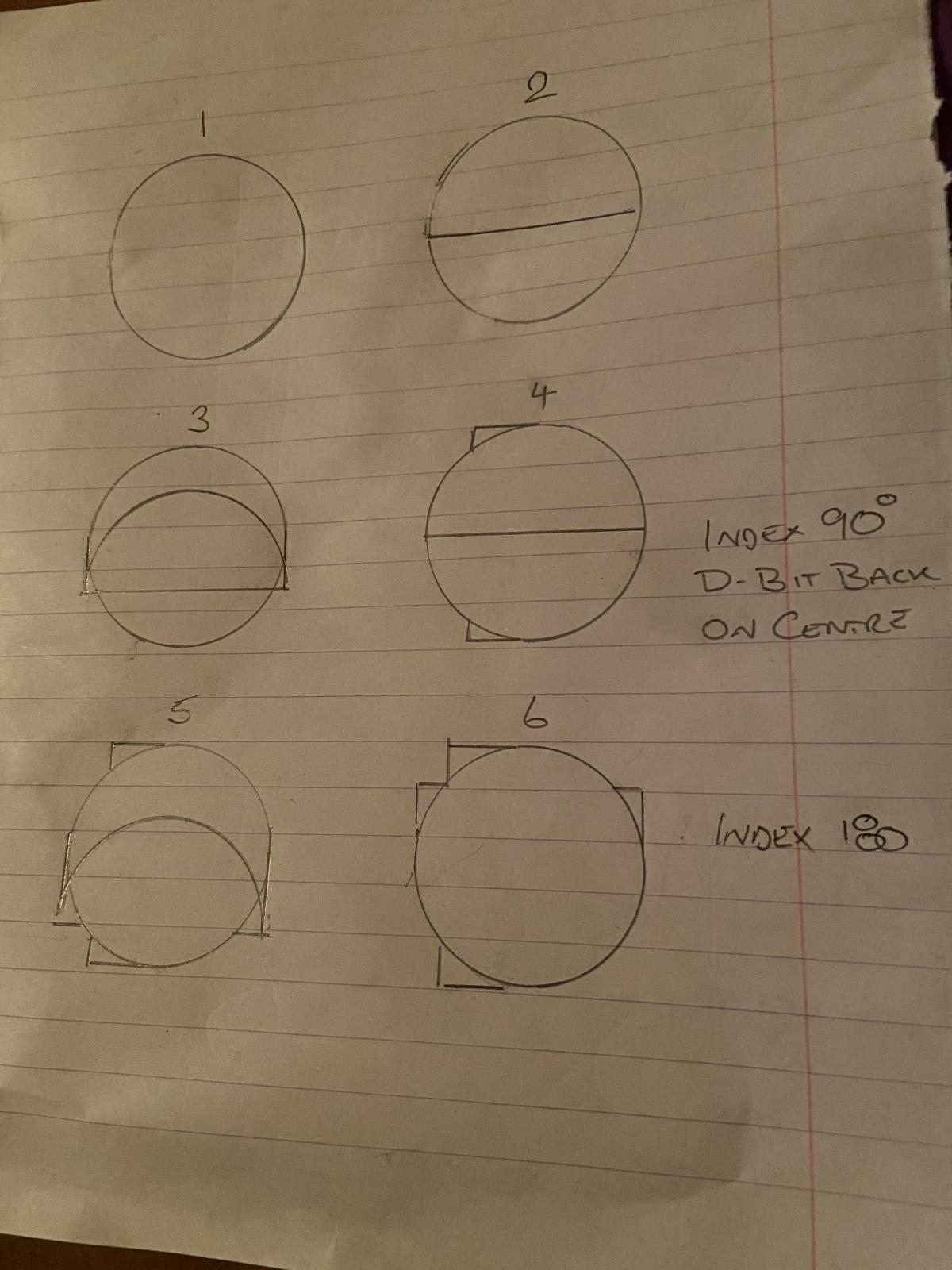

    The component can then be centred over the indexing head on the mill. The tool can be held in a chuck and the machine placed in low gear to prevent the spindle from rotating. Even better if you have a brake.

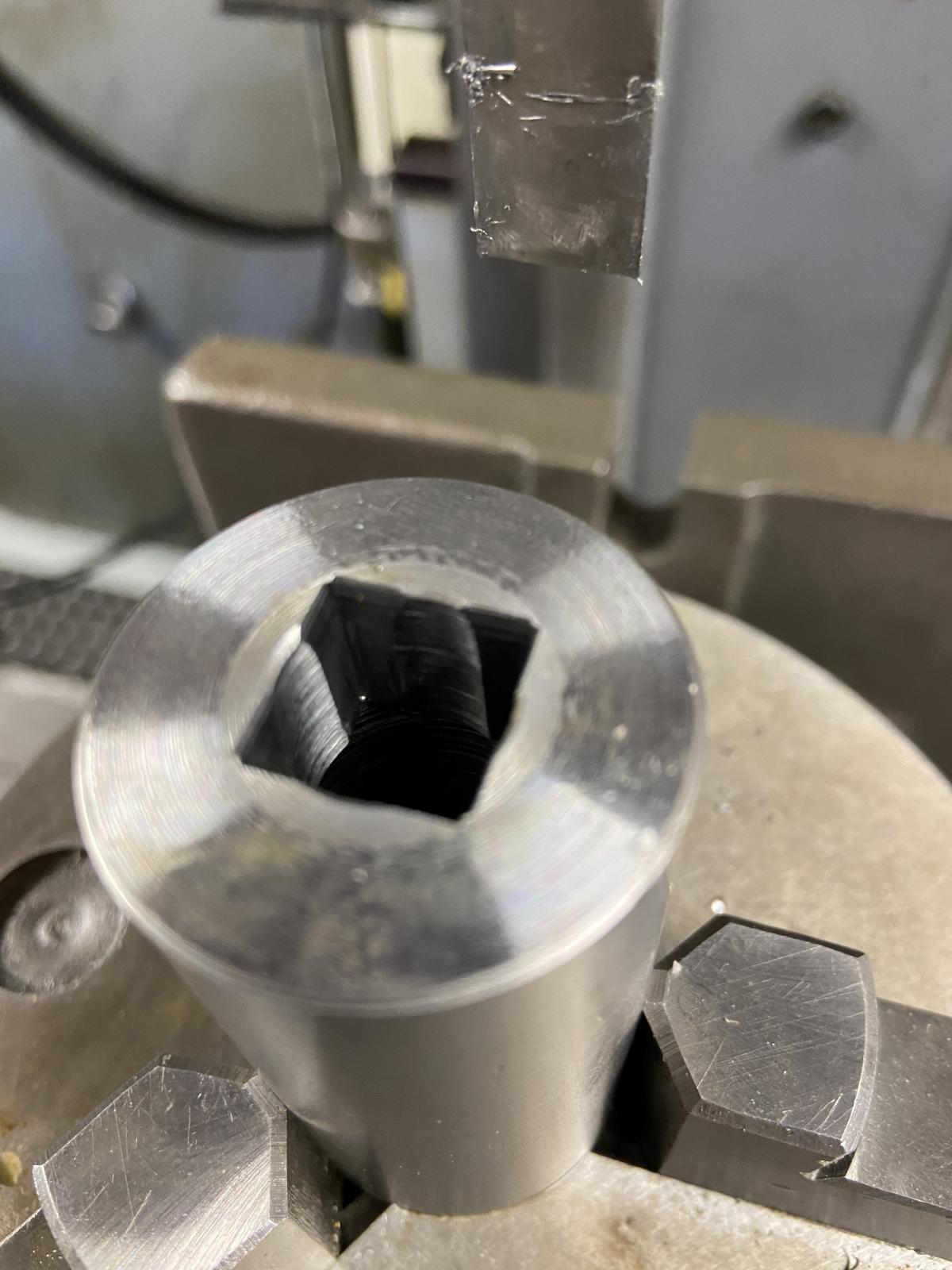

    It is now a case of moving the quill of the machine up and down in conjunction with one axis taking very small cuts. The two photos below show the procedure for cutting the square.
    Complete setup on mill
    Process for cutting

    Cutting square

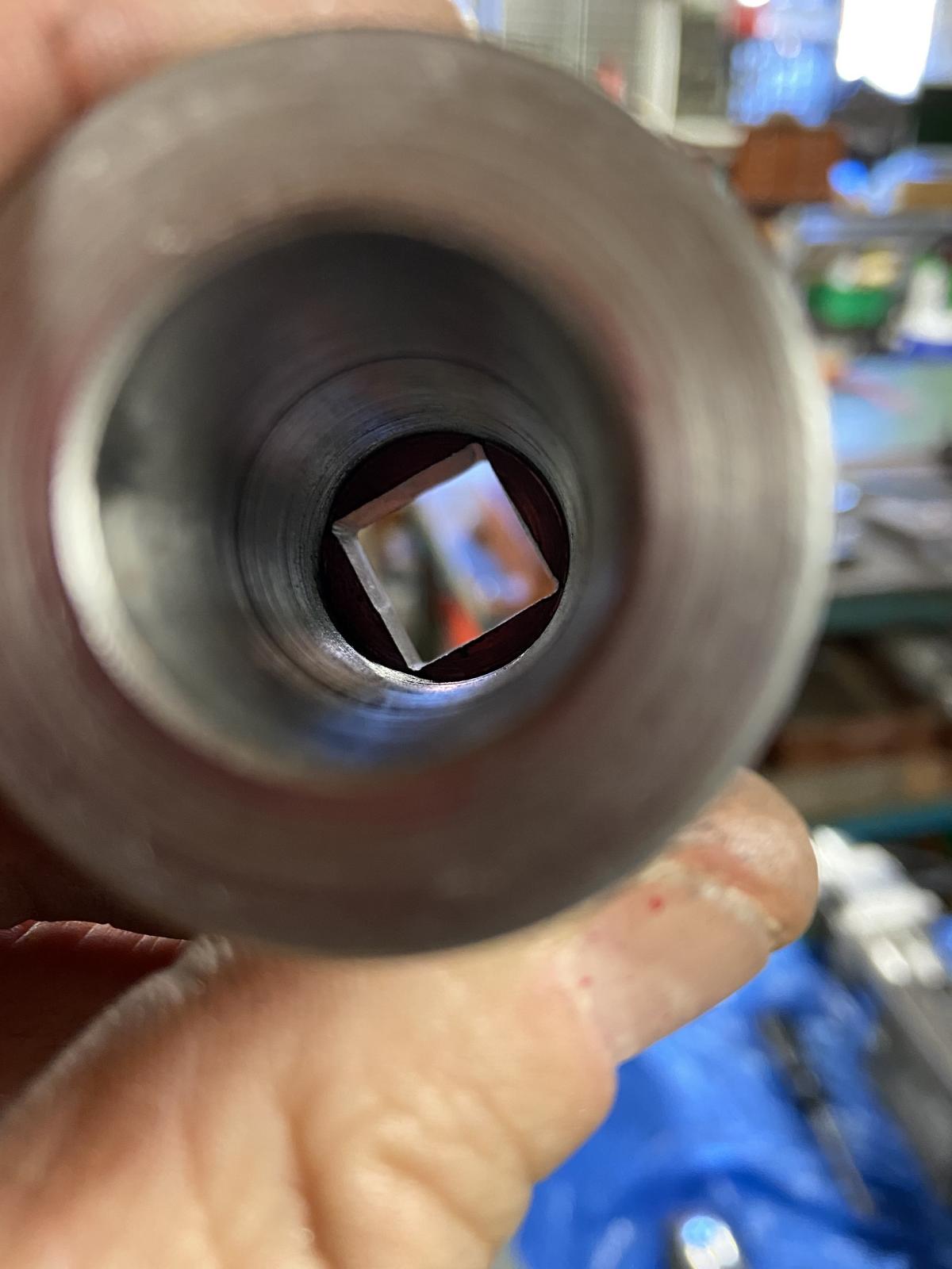

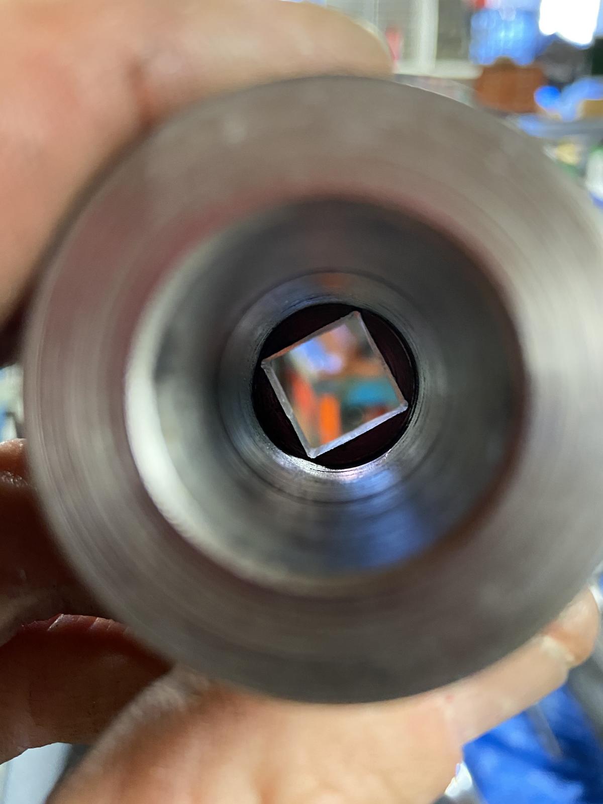

    Finished hole to size
    Broach square holes with D-bit-img_4330.jpg Broach square holes with D-bit-img_4331.jpg

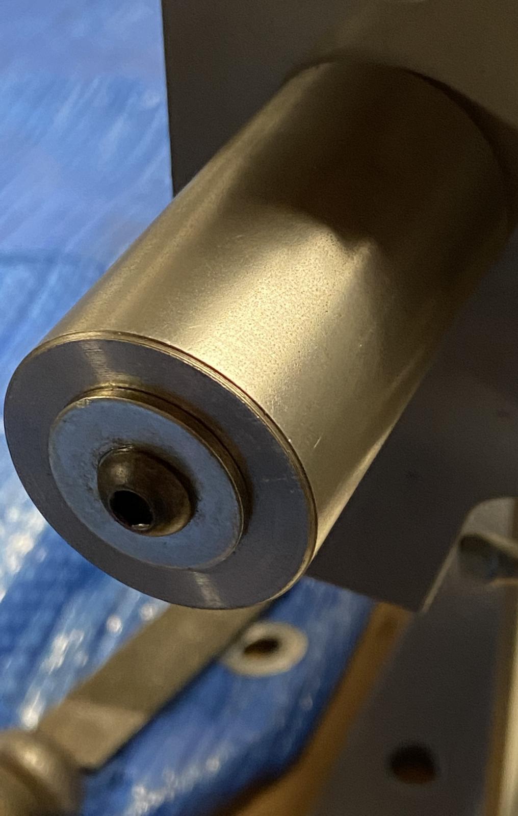

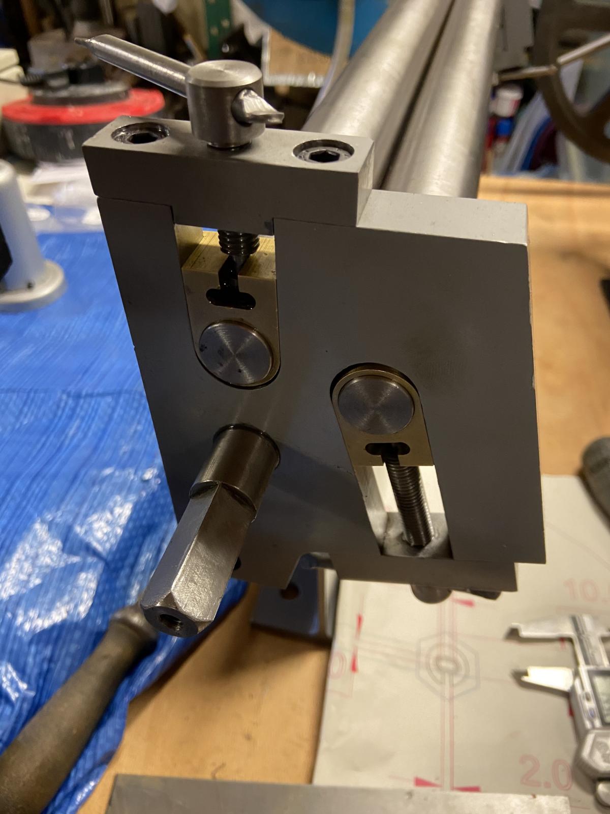

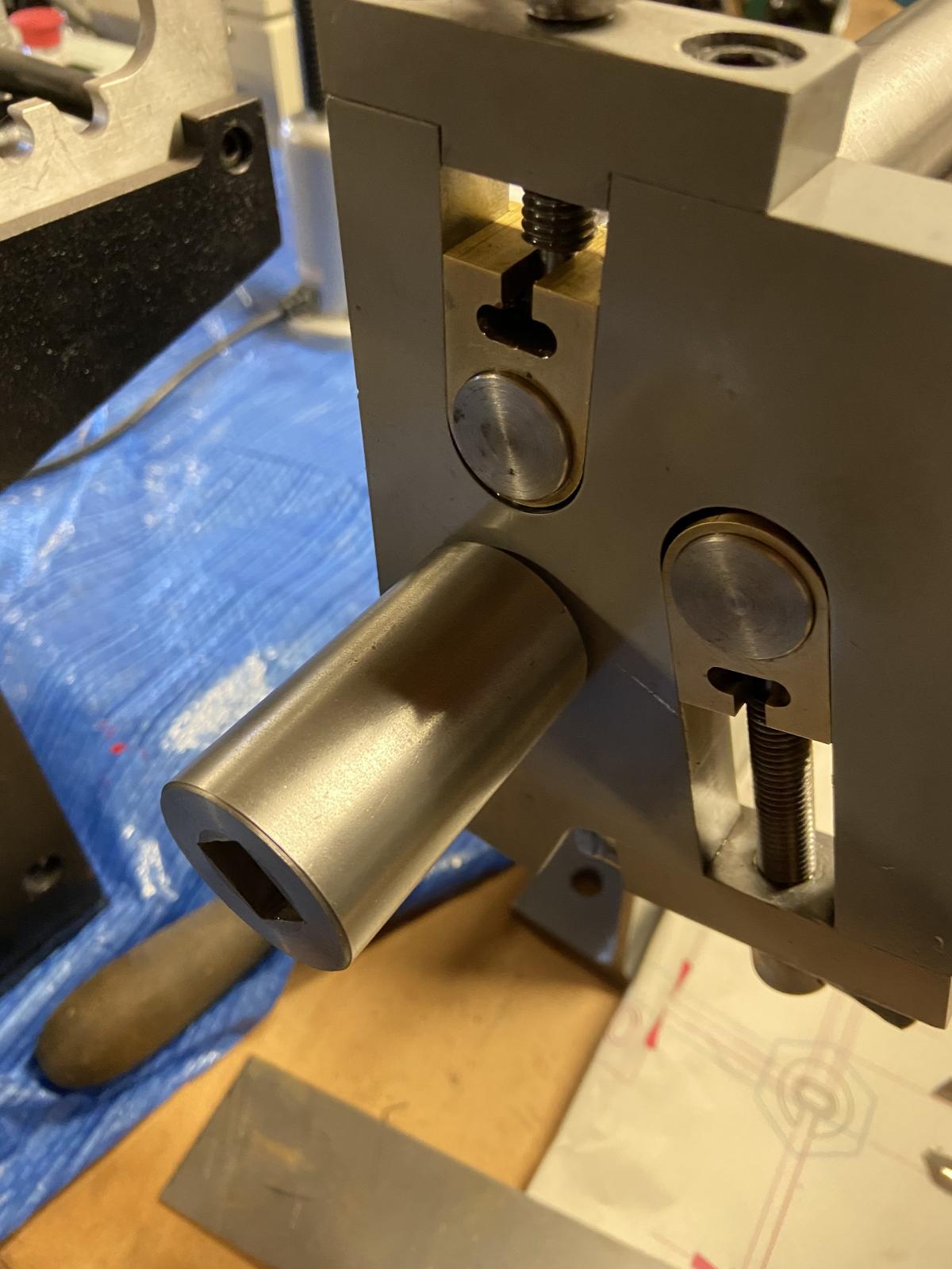

    Square drive shaft and fitted adaptor
    Broach square holes with D-bit-img_4328.jpg Broach square holes with D-bit-img_4329.jpg Broach square holes with D-bit-img_4332.jpg

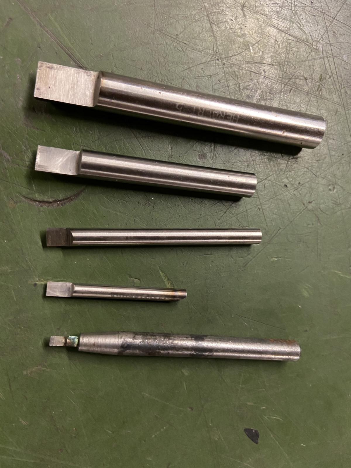

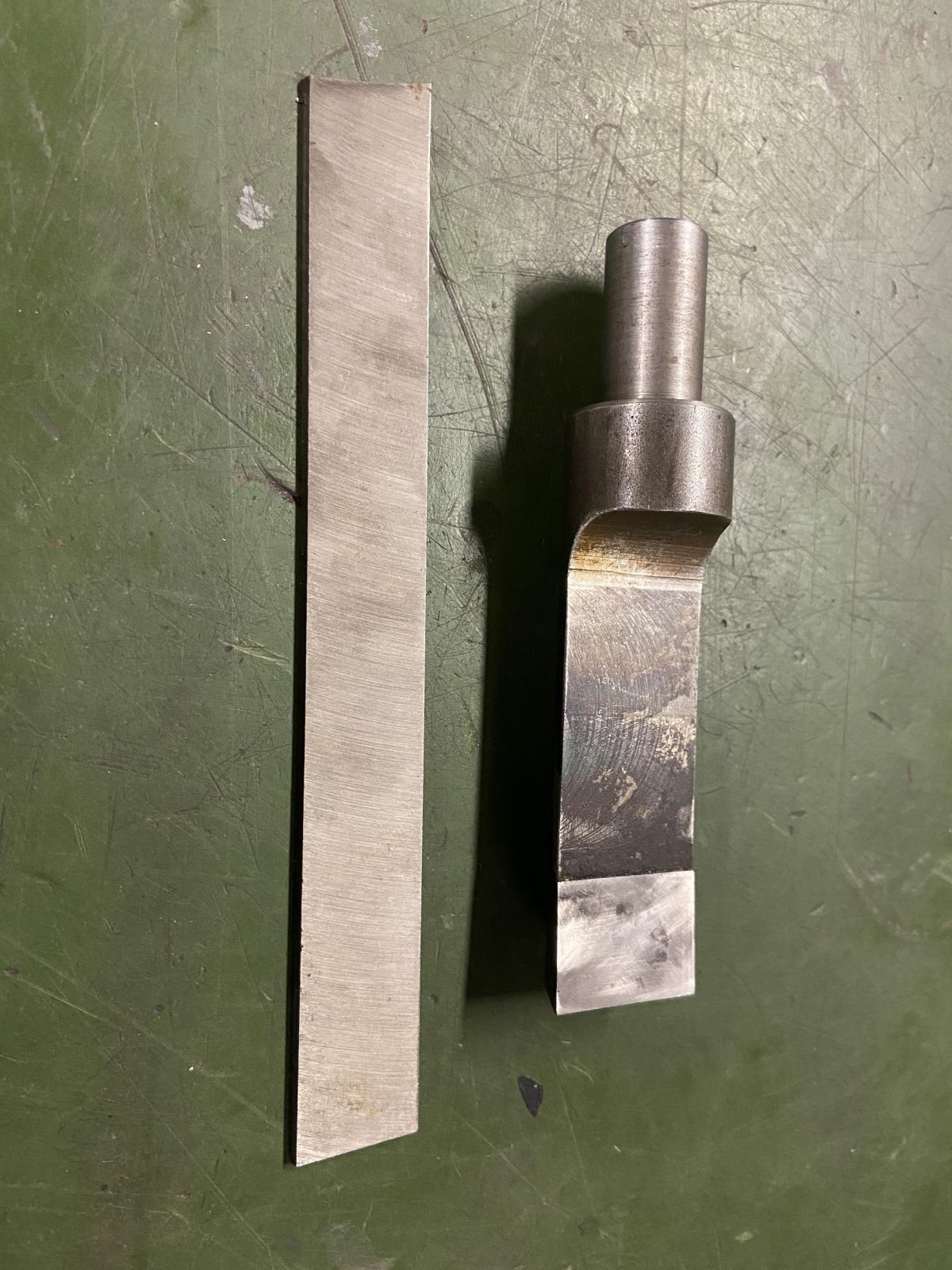

    I have used this method for cutting different size squares and have made several size broaches. The large one was made from mild steel and a piece of parting off blade silver soldered to the mild steel shank . This was used to cut a square slot in cast iron on the axle boxes of my 3" scale Foden steam wagon.
    Broach square holes with D-bit-img_4337.jpg Broach square holes with D-bit-img_4336.jpg
    Square cut and gauge piece used to check fit along with the D-Bit
    Broach square holes with D-bit-img_4323.jpg Broach square holes with D-bit-img_4324.jpg
    This method works really well and is very accurate, Like everything there are some drawbacks The deepth of square is limited by how far you grind the tool and the longer the tool more flex so more patience is needed. Plus side very cheap to make and almost any size can be cut rather than buying expensive square broach which will only cut the size it was intended for and the shape. Using the D-bit hexagons, slots etc. can be cut.

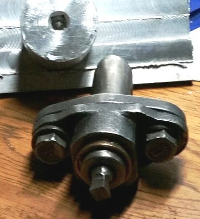

    I'm a fan of D bits too. Need to mill an unusual shaped channel - make a D bit with the desired profile. Need to make precise holes - make a D reamer from the same shaft that will go into the hole. And now there's a D broach.
    I've been using Thompson QS shafting intended for linear guide purposes because I've found that it's hard enough for D tools without a subsequent hardening process but not too hard to machine to the desired shape. Granted it will wear quicker than a properly hardened and tempered bit but for my projects it holds its dimensions long enough.
    I only make one size square hole with my rotary broach (¼") using a HSS bit and it serves its purpose for that.
