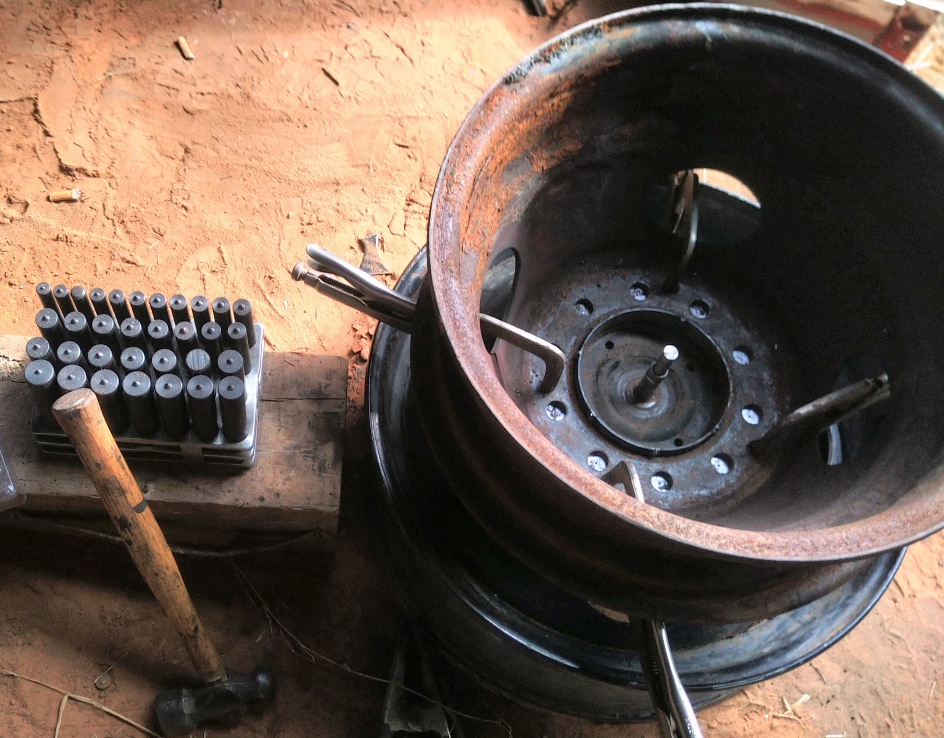

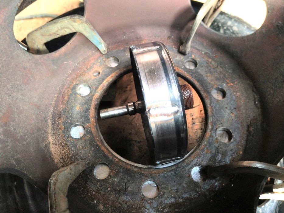

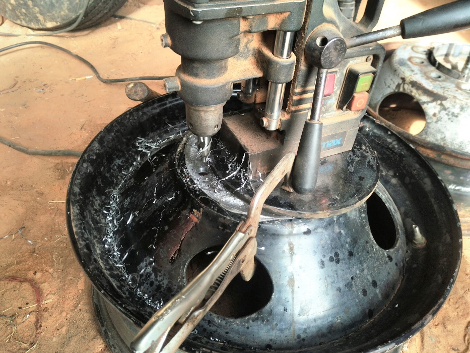

    I needed at least 2 rims to use for mocking up how I want the truck to sit. So here is what I have done.

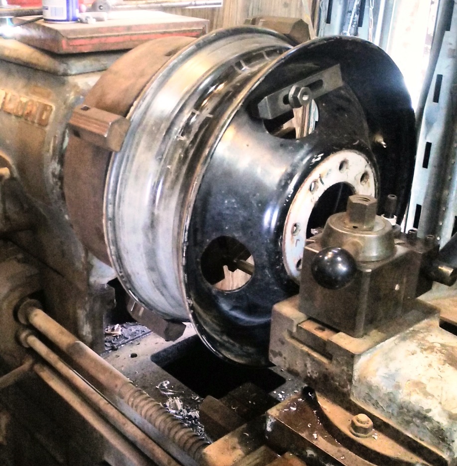

    I dismounted the tire, chucked a rim in the 4 jaws, on my 22" lathe, bored the pilot center to match the 16" rims then welded up the bolt holes used the smaller rim to locate the bolt pattern transfer punched the holes and drilled them with a mag drill.

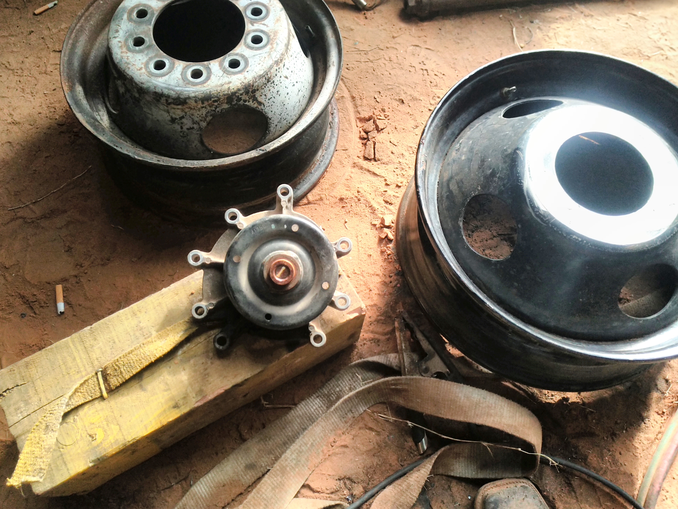

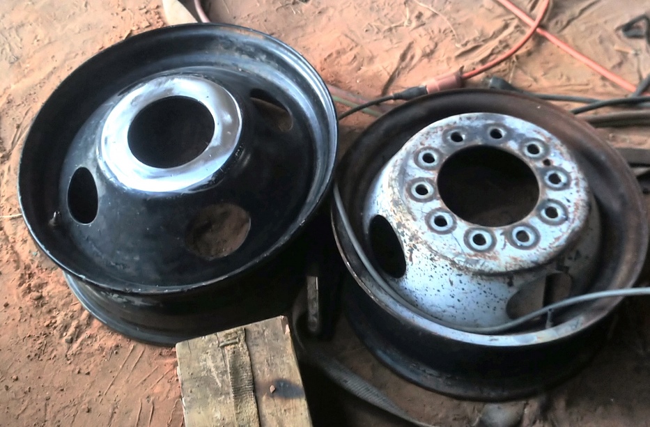

    Took the Pulley from an old water pump and modified it to serve as a center locator.

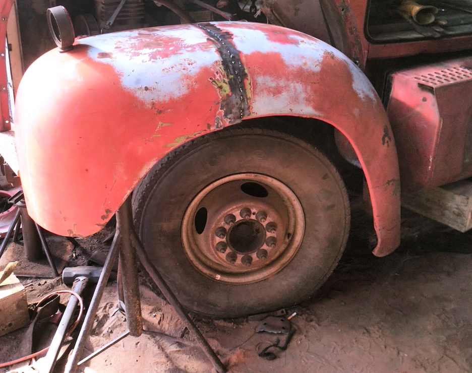

    truck with small wheel

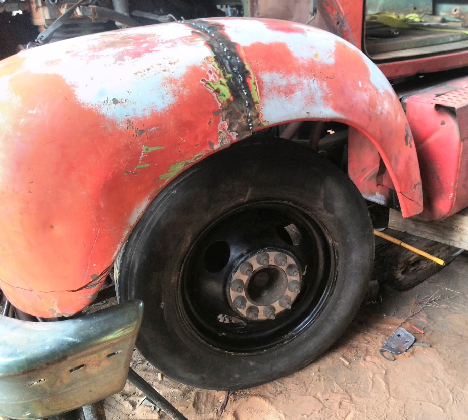

    truck with larger wheel
    I may go ahead and make all 6 rims to have a full rolling chassis, but I don't intend for them to be used for highway use. Right now they are just tools to aid in building the truck
