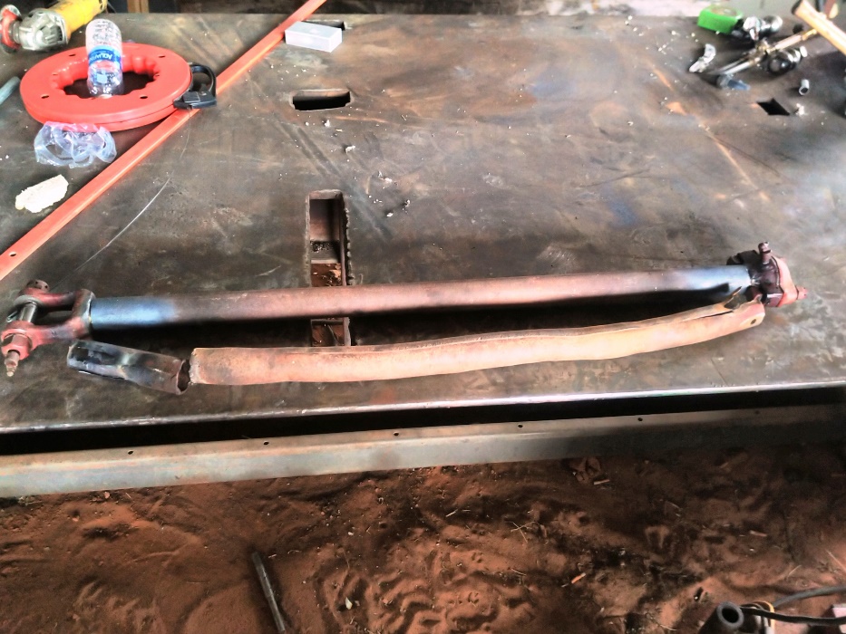

Finally got around to repairing the steering link on the 1916 5 ton CT electric Truck
The new link and the old bent and broken tube

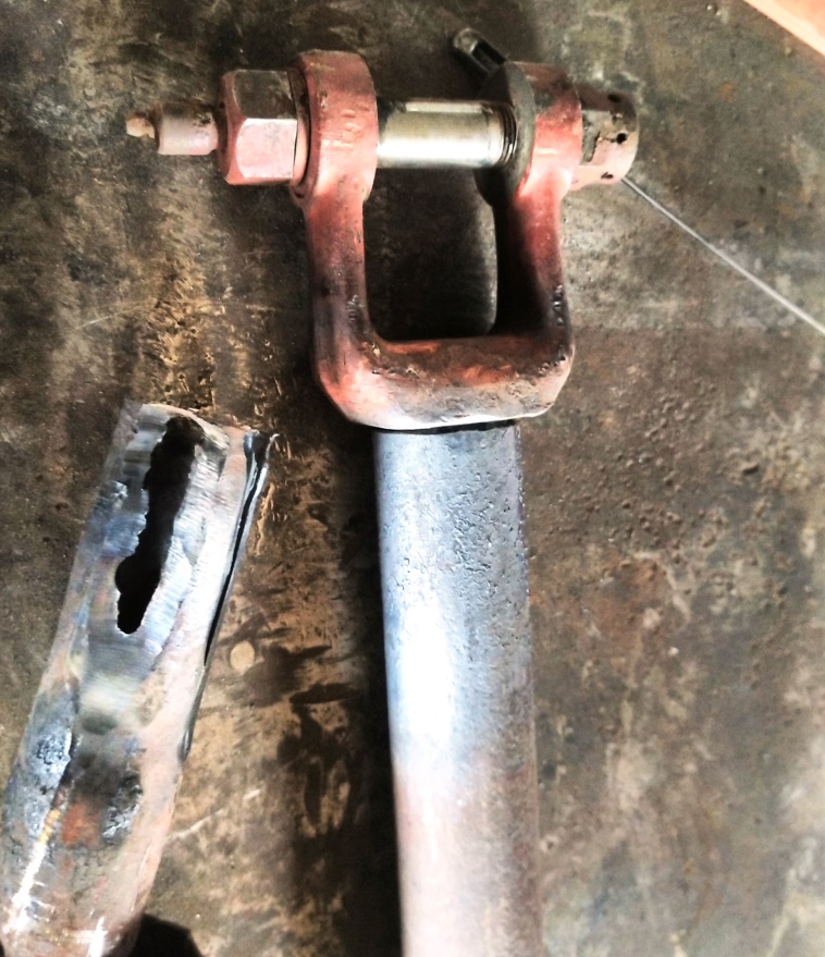

Attachment 45872
I machined the bore on the ends of the sch 80 pipe but left them several thousands under sized, then heated them to nearly white hot and pressed the ends on

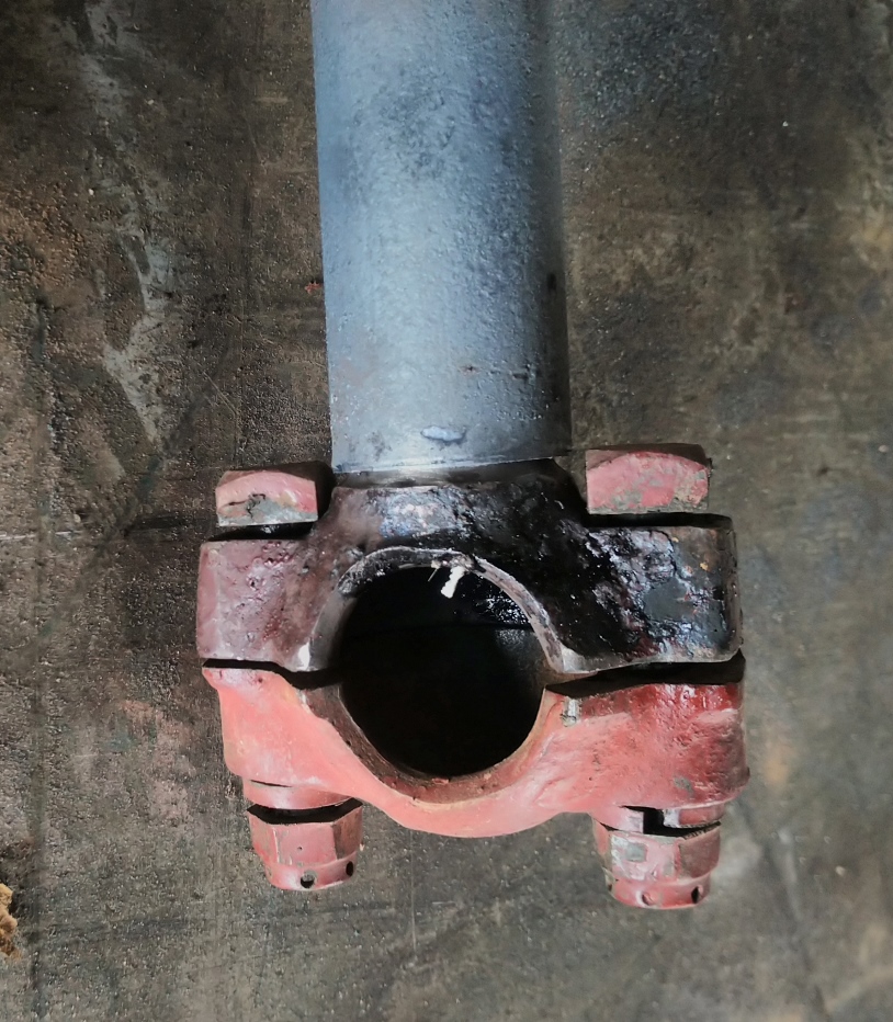

Attachment 45873
Attachment 45874
