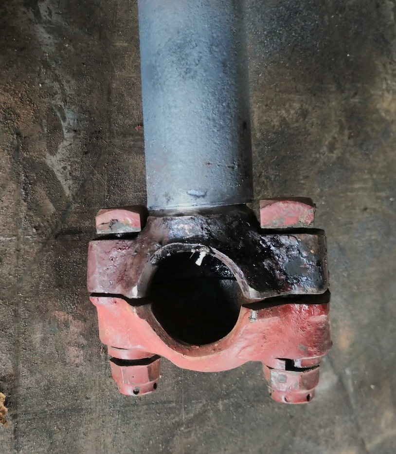

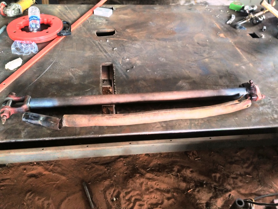

    Finally got around to repairing the steering link on the 1916 5 ton CT electric Truck
    The new link and the old bent and broken tube

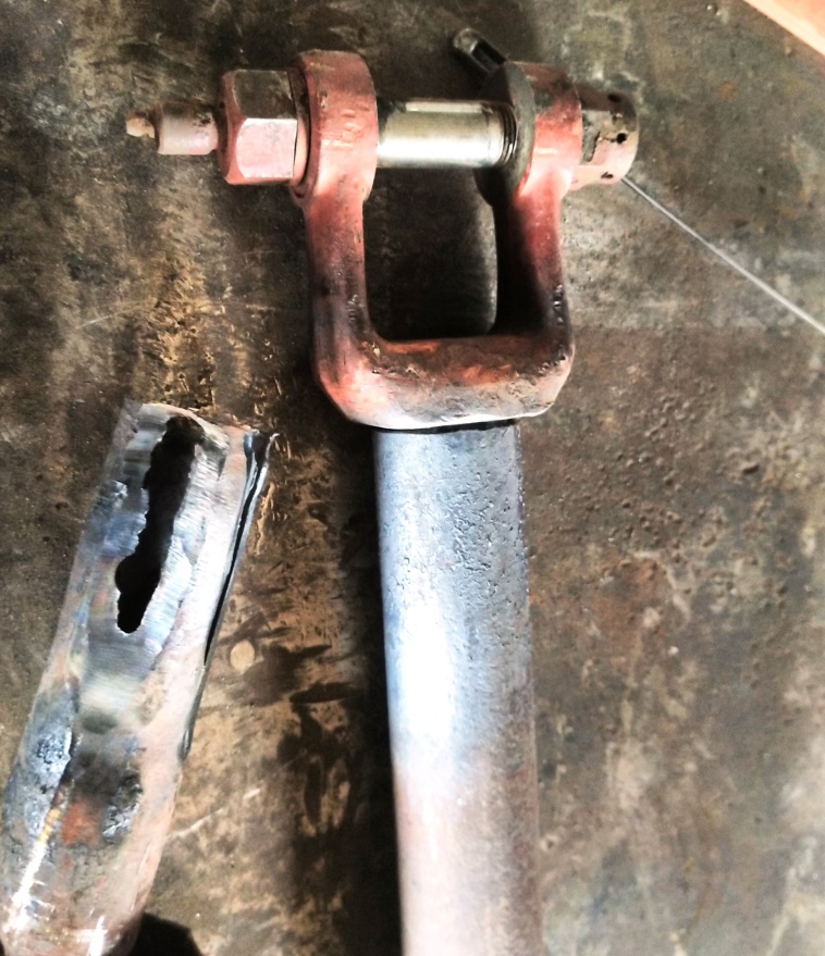

    I machined the bore on the ends of the sch 80 pipe but left them several thousands under sized, then heated them to nearly white hot and pressed the ends on

    The only way you would be able to tell it is not original is I used seamless sch80 instead of welded sch40, that and the fact that I did not need to braze a .010" shim sleeve around the stubs to make my pipe fit tight but after it is painted you would have to cut it apart to find those differences or know the factory weight of the assembly I will make 4 soft steel round head rivets to pin the ends on with but I need to make a rivet set die with the correct shape to buck them in place. There are other rivets I need to buy or make for other parts of the truck so this will be done at a later date.
