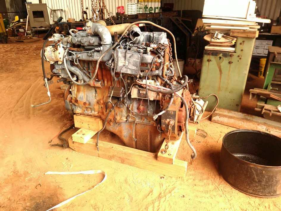

In needing to put several engines in my storage van the first step was to build a skid for them to rest on
Made out of 3x6 rough cut lumber held together with 1/2" diameter 6" long lag bolts
the engine is chained down to it to make it easier and safer to move around
Attachment 40073
