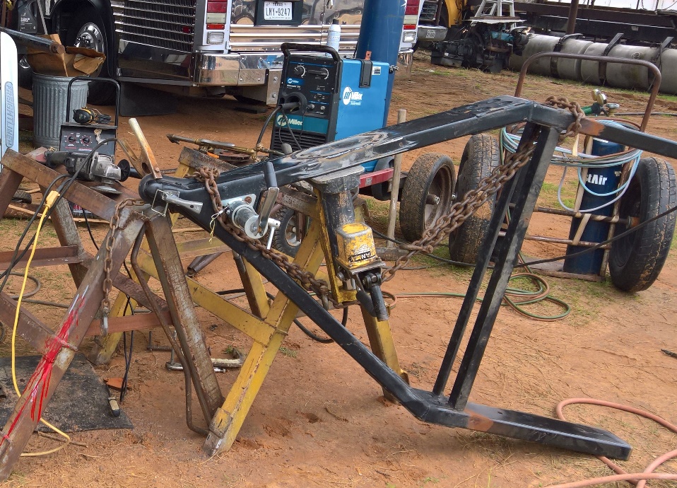

This was how I straightened it I first put in on a pair of work horses then placed my hydraulic toe jack on the damaged area and used a chain to jack against.

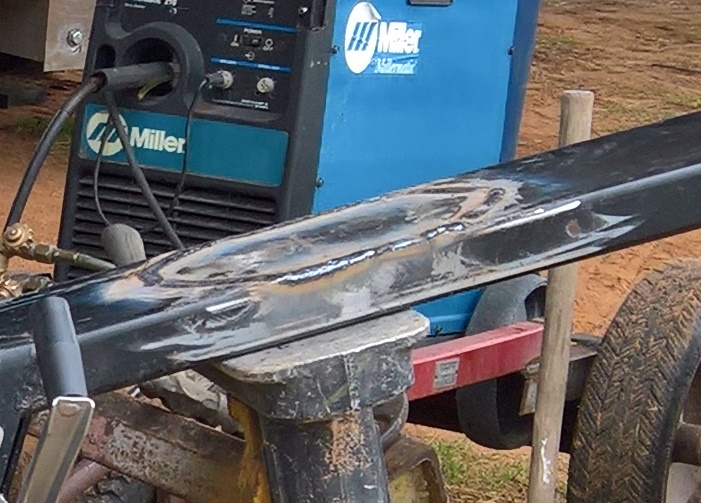

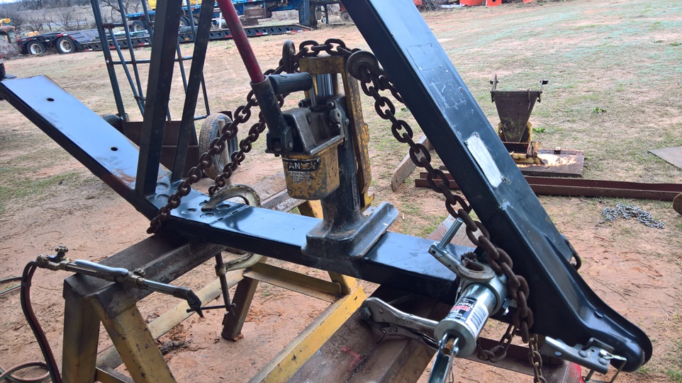

Once I had the tubing straight linearly I turned the tongue over and sectioned out the damaged outer face of the tubing then hammered that part flat and welded it back in place
Attachment 34089
Attachment 34090
