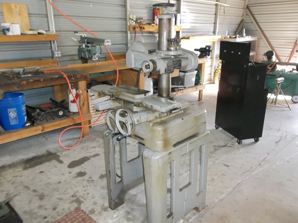

Attachment 13909
Before

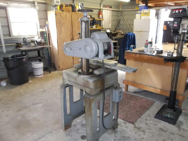

Attachment 13910
Before

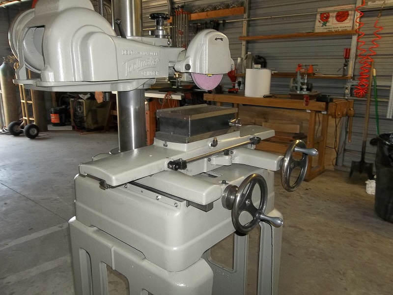

Attachment 13911
After

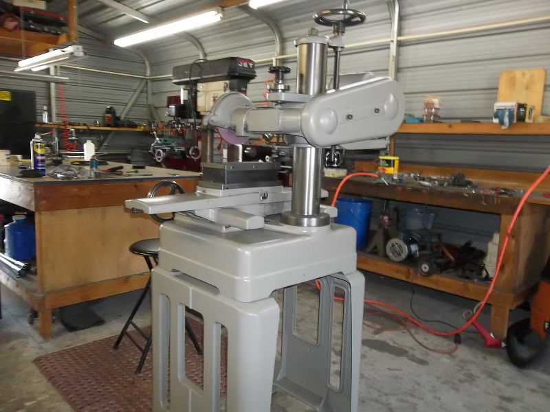

Attachment 13912
After
