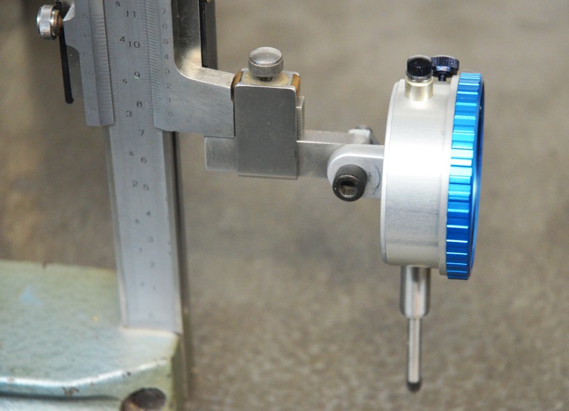

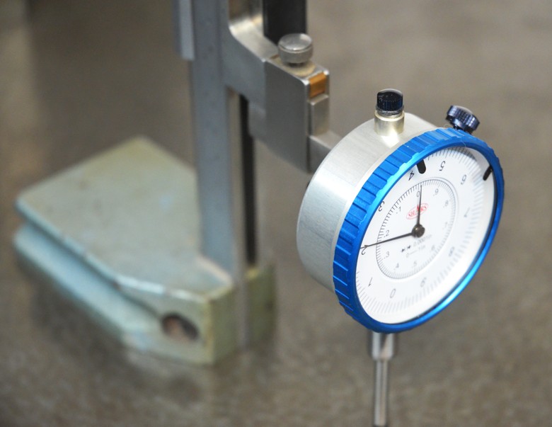

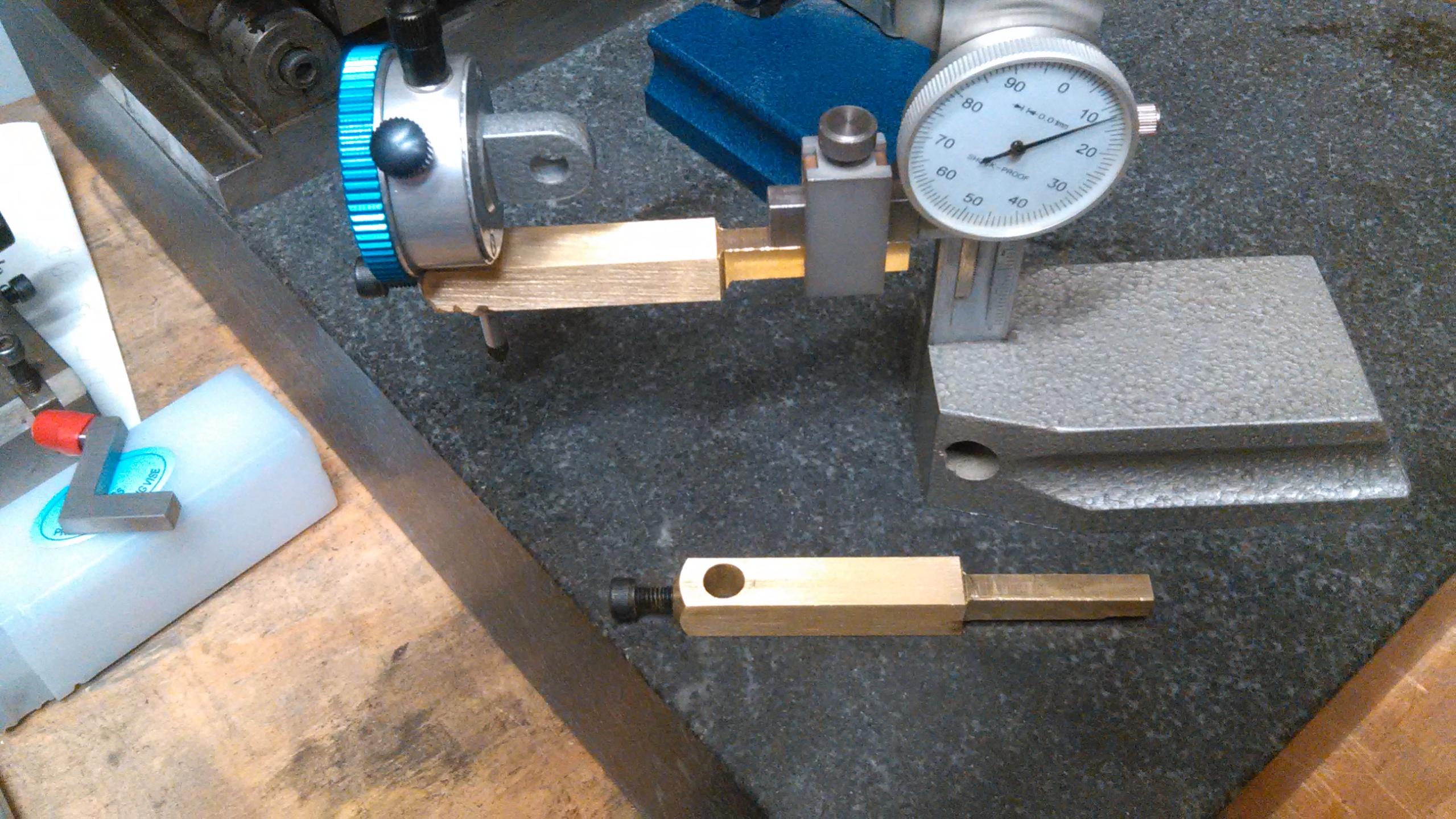

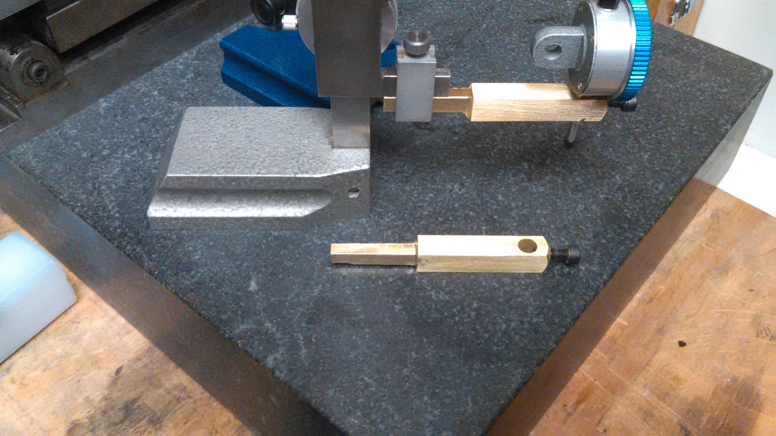

To make the height gauge hold a dial indicator, I used some 7/16" square brass stock I had. I made one for 3/8" stems, and another for 8mm stem.
The screw on the end is 10-32. So to finish this, I need to make some brass thumb screws. These fit in place of the carbide tipped scribe.
