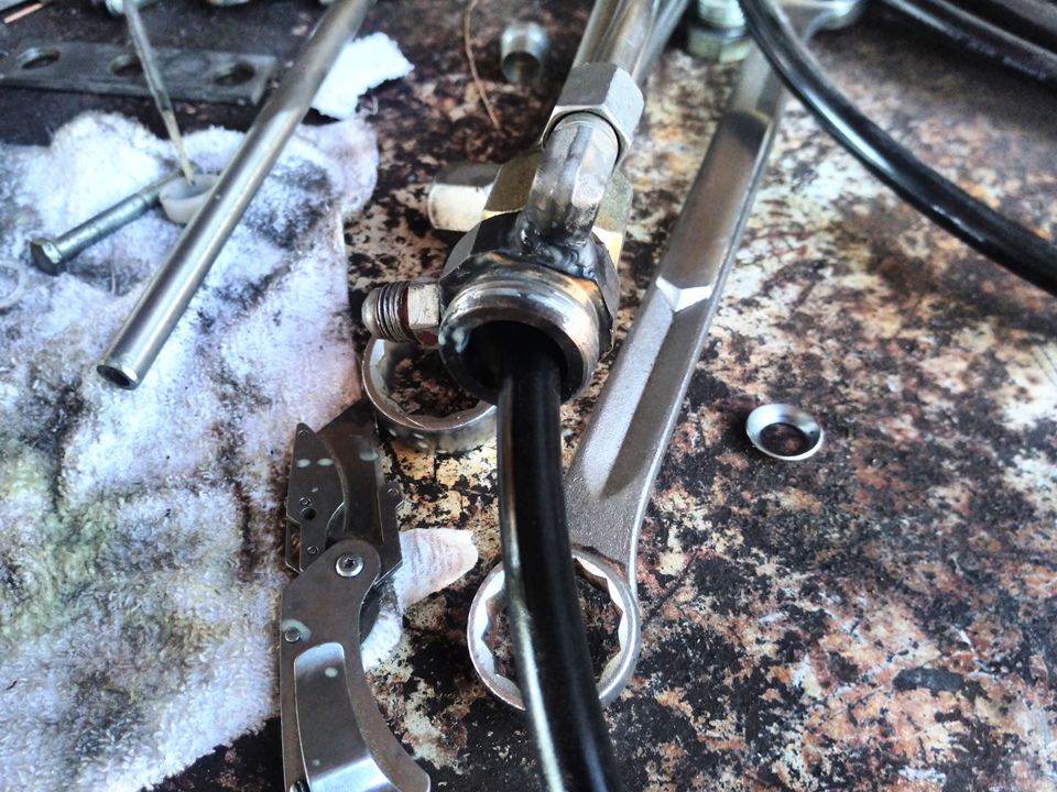

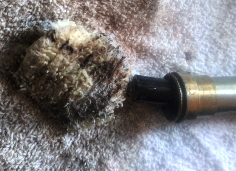

When it comes to cleaning out a long piece of hydraulic tubing, I find that using a length of smaller diameter air brake tubing by pushing an oiled cotton swab works better than most things as it can be pushed through bends as well as the straight sections and about the only way to insure there are no metal particles left in the line
