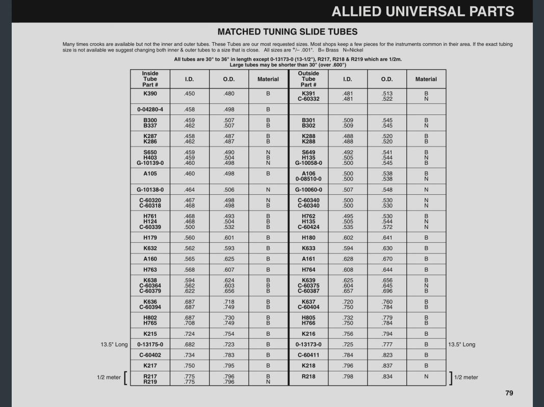

Allied Supply sell what you want but only to Musical instrument repair technicians. Maybe you could have a chat with Todd at Brass Music Specialists in Brisbane. He may have what you want in stock or could order it in for you. Attachment 17623
telescoping brass tubing googles easily but the .com vendors may not suit delivery in Queensland.
