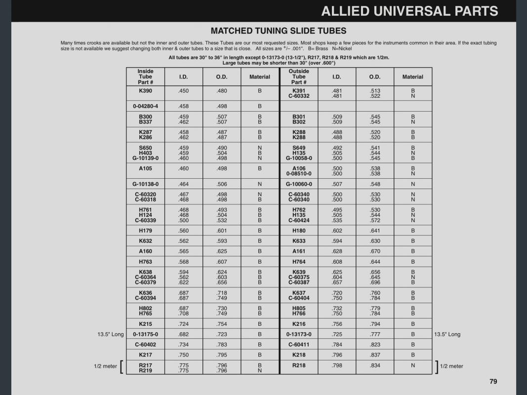

    Hello all, I am making a wooden flute and want to include a tuning slide. I haven't been able to find commercial brass tube where one size slides into another. Swaging has been suggested but need some help about how you do it.

    Hi, McMaster-Carr sells telescoping brass tubing up to 1" in dia.

    Hi Glueman2,
    Allied Supply sell what you want but only to Musical instrument repair technicians. Maybe you could have a chat with Todd at Brass Music Specialists in Brisbane. He may have what you want in stock or could order it in for you. Swaging brass tube-img_2279.jpg

    telescoping brass tubing googles easily but the .com vendors may not suit delivery in Queensland.
    Biggest issue to swaging your own is a question of power, whether drawing through a die or building a rotary swage. First step is supply of annealed tubing, or annealing commercial half-hard lengths. Any sites dealing with reloading of rifle cartridges will cover the simple process; it is air cooled not chilled.
    If I was faced with producing an airtight seal, first attempt might be felt 'o-rings' and lube used by brass musicians.
