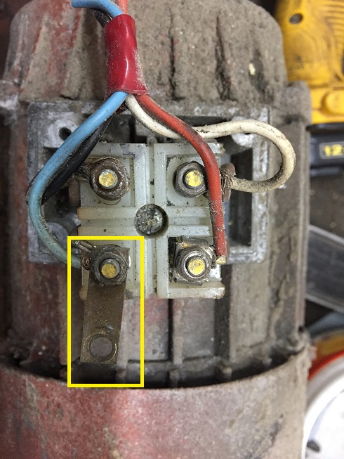

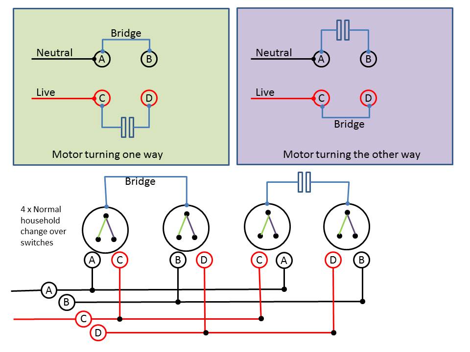

I have a 220V AC induction motor that allows me to change the direction by switching the a "BRIDGE" and the Capacitor internally. There is a sketch in the other tread.
I need some ideas as how to do this with a switch. What type of switch must I ask for and do I need to fit a second capacitor?or has somebody got a cheap DIY method. :confused:
