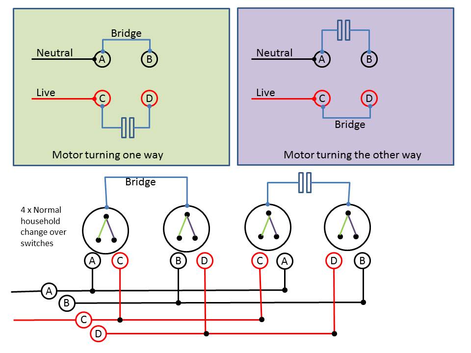

    I have a 220V AC induction motor that allows me to change the direction by switching the a "BRIDGE" and the Capacitor internally. There is a sketch in the other tread.
    I need some ideas as how to do this with a switch. What type of switch must I ask for and do I need to fit a second capacitor?or has somebody got a cheap DIY method.

    Here is an idea using 4 normal household change over switches. the type you use when 2 switches has to switch the same light.
    Unfortunately you have to keep your wits about to know to switch all the switches before the POWER switch.

    If you wire it right you can flip any switch any time you want to. Though when the motor is running the reversing switch does nothing because it is out of circuit then. It got taken out when the centrifugal switch opened. Forget all garage nut's diagrams but the one with the lavender background. We'll use that one. Let's say the top with the capacitor is the start winding, and the bottom labeled bridge is the run winding. Now let's further say that when A & C is hot the motor spins CW. Now if B & C are hot the motor spins CCW. You can do that with one DPST switch. Then just slap a switch on the hot coming in to turn the motor on, and off. That's all there is to it. You never move the capacitor in a motor either. It always stays on the start winding. It is absolutely stunning how much bad information there is on the Internet about this topic.

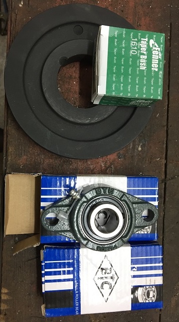

    I am following the advice given to me to improve the saw. First thing is a stronger motor. I am going to use a 20mm bright mild steel shaft and 2 very inexpensive flange bearings. First stage to reduce the speed from 1400 RPM to 60is
    The cast iron pulley and taper lock was cheaper than and ali blank and then I would still have had to bore it to 20mm. Do not have a boring bar at the moment and do not want to tackle another project whilst the saw is not fully sorted out.

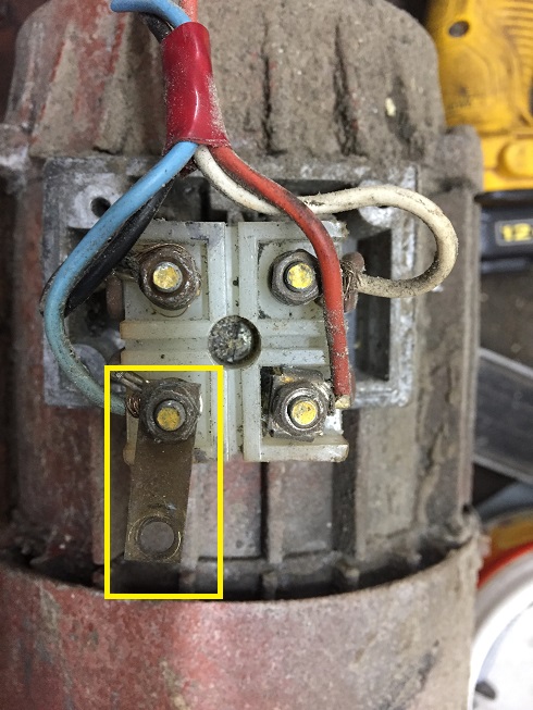

    This is what it looks like in the controlSwitch to change direction-motor-connections.jpg box of the motor. The bridge is in Yellow
