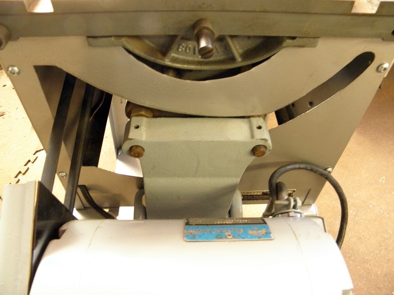

Table Saw sawdust cover behind motor. made from sheet metal.
Attachment 6597
DISREGARD THE PHOTOS BELOW THE TOP ONE IS THE FINISHED ONE...
Attachment 6597

Can you still tilt the blade with this setup?
Wow I did'nt think of that and I have not tried to tilt it either well I guess I'll have to mod the mod:lol:
Wow I did'nt thank of that and I have not tried to tilt it either well I'll have to mod the mod :lol: My brain must be over modded.
Thanks for pointing that out now i won't be surprised.
Problem Fixed with new curved slot. see top photo.. thanks for seeing that mix up:agree:.
