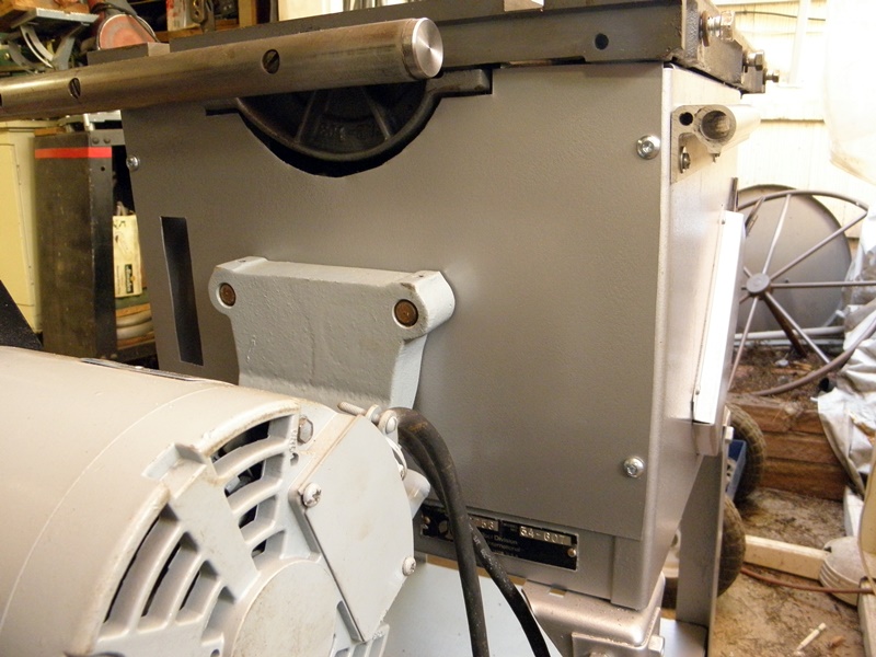

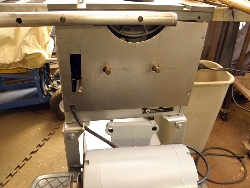

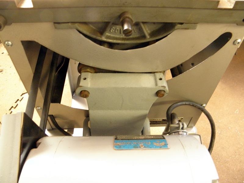

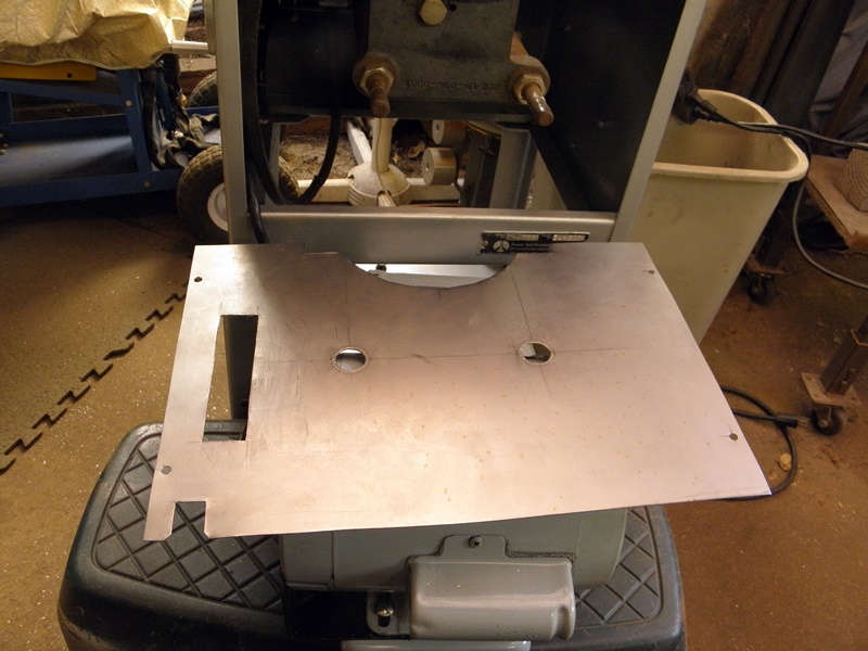

    Table Saw sawdust cover behind motor.
    Table Saw sawdust cover behind motor. made from sheet metal.
    DISREGARD THE PHOTOS BELOW THE TOP ONE IS THE FINISHED ONE...
    Attached Thumbnails Attached Thumbnails Table Saw sawdust cover behind motor.-001.jpg   Table Saw sawdust cover behind motor.-002.jpg   Table Saw sawdust cover behind motor.-004.jpg   Table Saw sawdust cover behind motor.-001.jpg

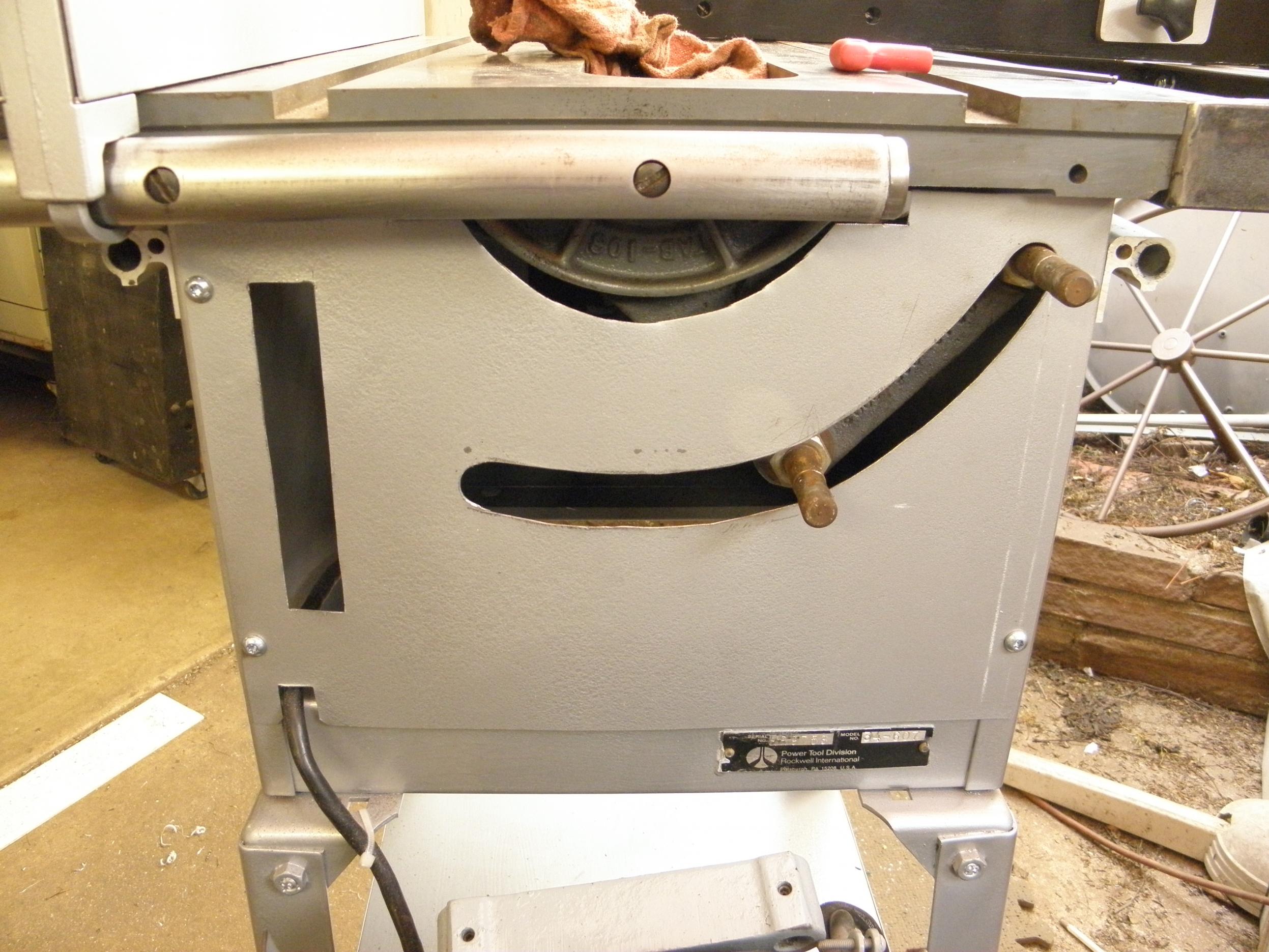

    Can you still tilt the blade with this setup?

    Wow I did'nt thank of that and I have not tried to tilt it either well I'll have to mod the mod My brain must be over modded.
    Thanks for pointing that out now i won't be surprised.

    Wow I did'nt think of that and I have not tried to tilt it either well I guess I'll have to mod the mod

    Problem Fixed with new curved slot. see top photo.. thanks for seeing that mix up.
