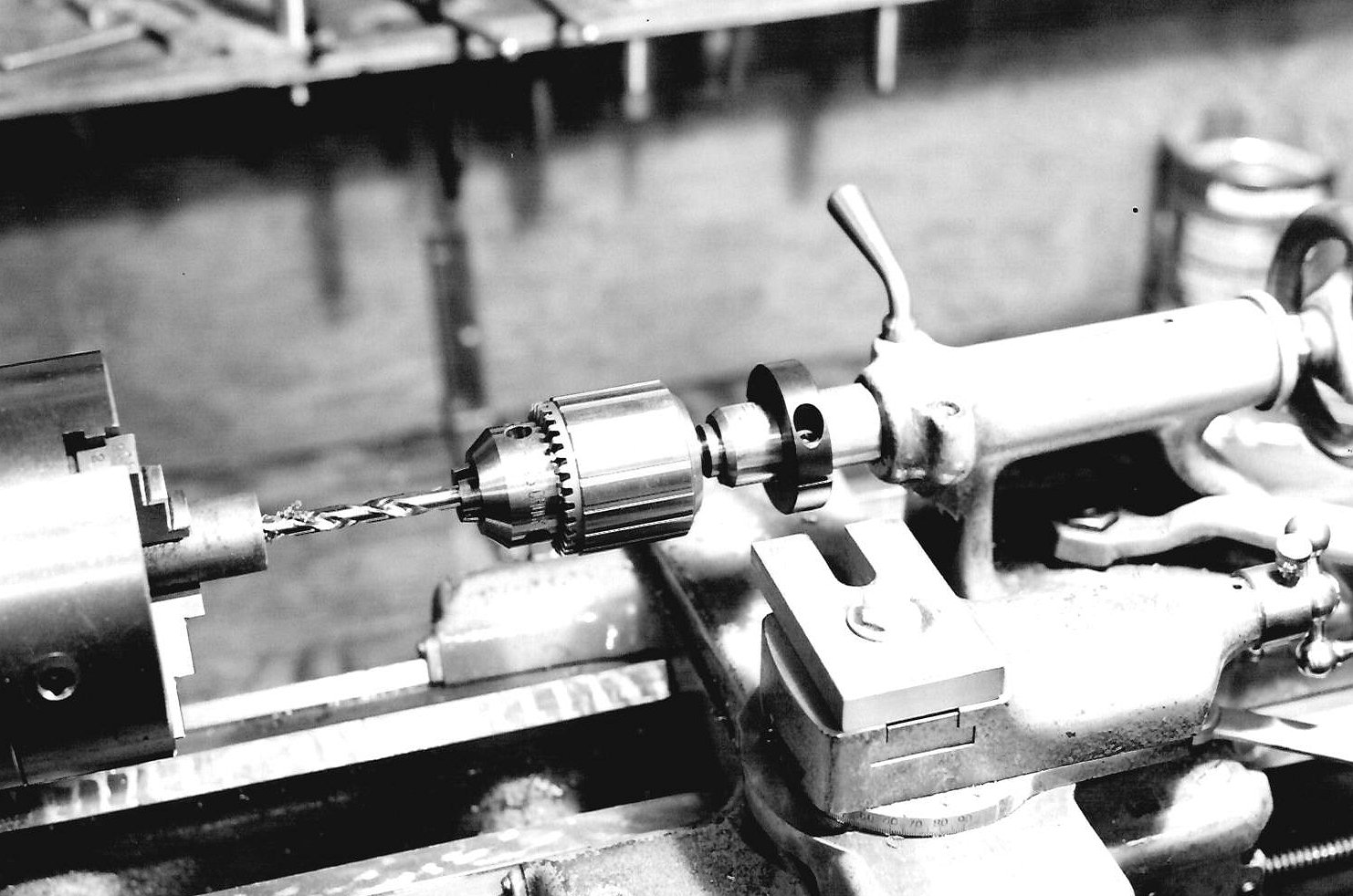

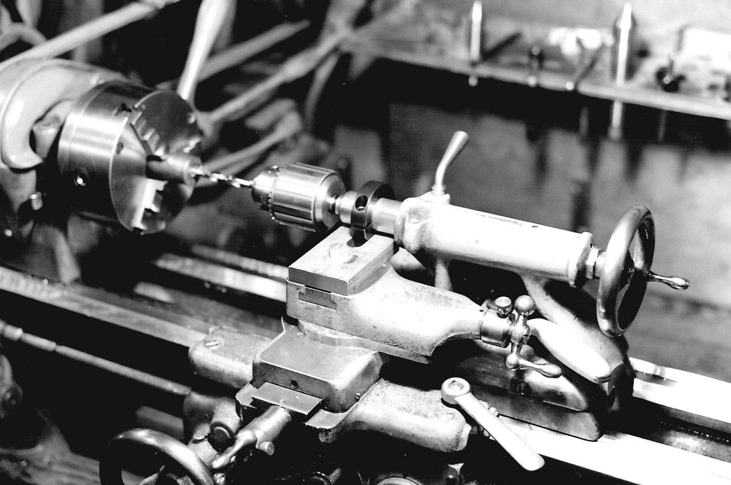

2 Attachment(s)
I posted this in another thread some time ago, but this was a somewhat simpler approach I took.
I got a two piece clamping shaft collar with an ID the same size as my tailstock spindle. Then I made a forked bracket that engaged the shaft collar as shown in the photo. Just slightly loosen the tailstock clamp and let the carriage pull it along at the desired feed rate.
Attachment 39816 Attachment 39817
The clamp on quill [tmate3, post 4] is nice because quick arrangement from start to usable.
All of a sudden I'm picturing a twist for these. Carriage still tows the tailstock, but also compresses a coil spring.....retracting a short distance at feed disengagement for peck drilling, the real technique for deep drilling.
Normally, I use the quill handwheel while disengaging to break chips. Not a difficult coordination, but involves both hands.
Far as concerns about tipping tailstock; part is where the towing gear attaches, very slight clamping also helps. Lathes referred to not so much an issue, and no one expects to proceed without a pilot hole. A properly sharp drill at correct feed rate with chip removal produces a clean dang hole.
