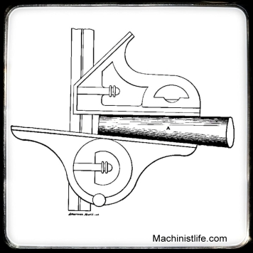

Saw this on another forum...
Attachment 31124
Too crude to measure the taper but a handy way to make a gauge for duplicating a taper when the original can't be mounted in the lathe.
Attachment 31124
Thank you. Mainly because the thought never would have entered my mind.
Also, remember that your combination square can be configured into a decent deep throat caliper. Here's the technique...
