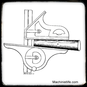

    Saw this on another forum...
    Too crude to measure the taper but a handy way to make a gauge for duplicating a taper when the original can't be mounted in the lathe.
    Regards, Marv

    Thank you. Mainly because the thought never would have entered my mind.
    Jim

    Also, remember that your combination square can be configured into a decent deep throat caliper. Here's the technique...
    Improvised deep throat calipers
