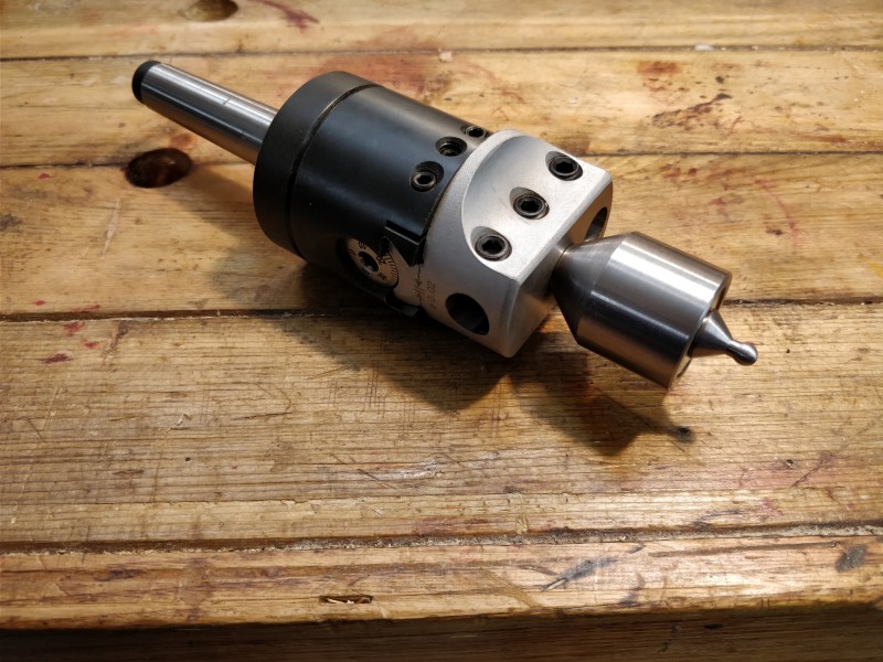

    I think it is Marv who is the precursor of this method for turning tapers on the lathe using a boring head in the tailstock.
    Many thanks to him for this clever idea !
    I wanted to give it a try in order to turn some taper mandrels that I needed, and I decided to make some accessories to it :

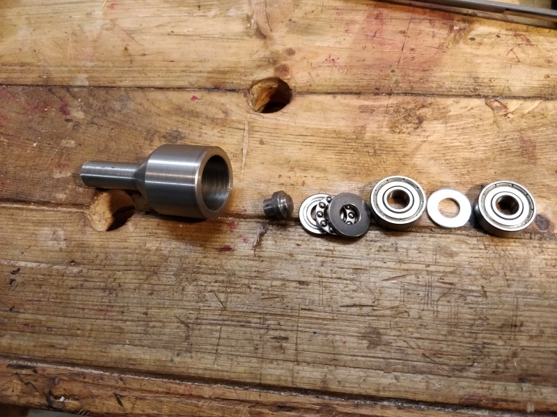

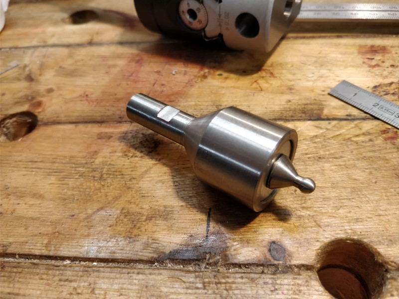

    A small live center with cylindrical shank that will fit the boring head :
    It's made of a stack of a bearing stop and a couple of ball bearings

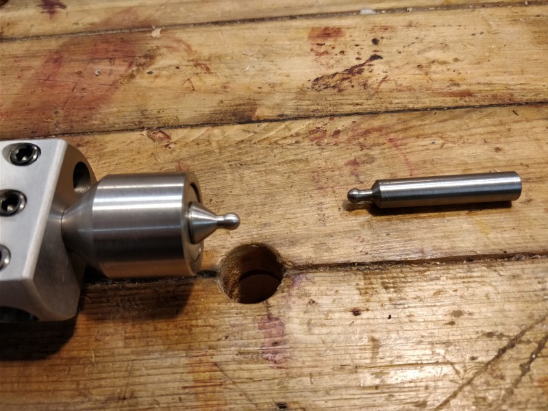

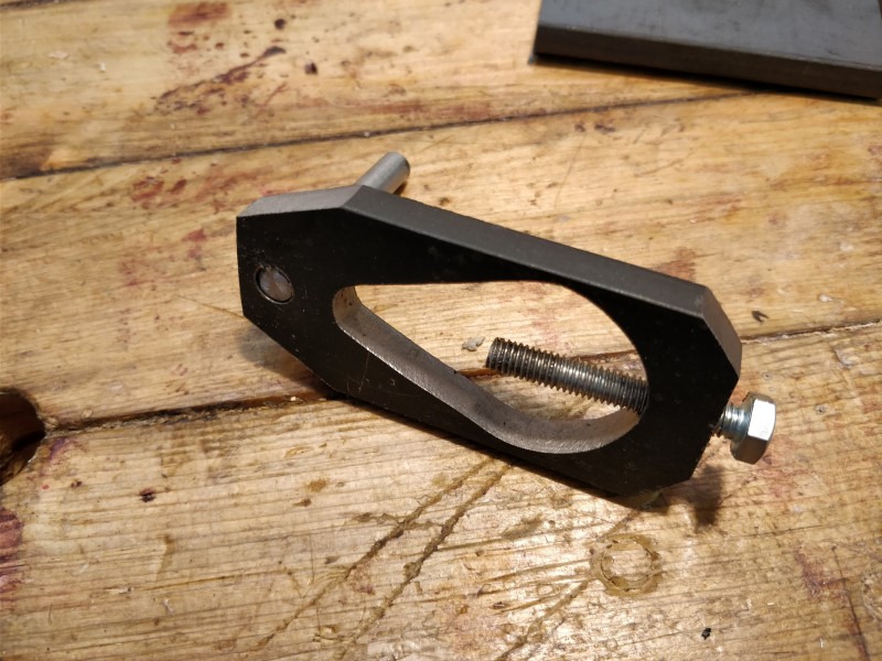

    A pair of spherical centers, re-using the ball tool I already showed yesterday.

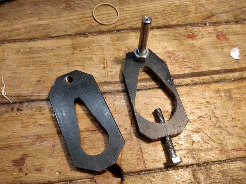

    And also a couple of Lathe Dogs, two different diameters :

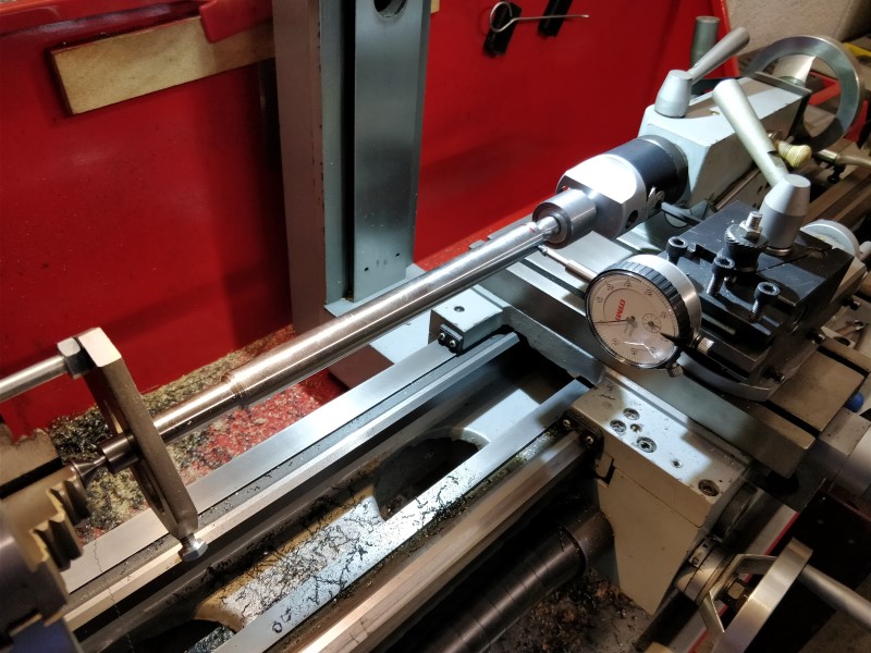

    And here is the complete setup :

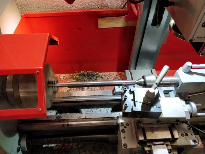

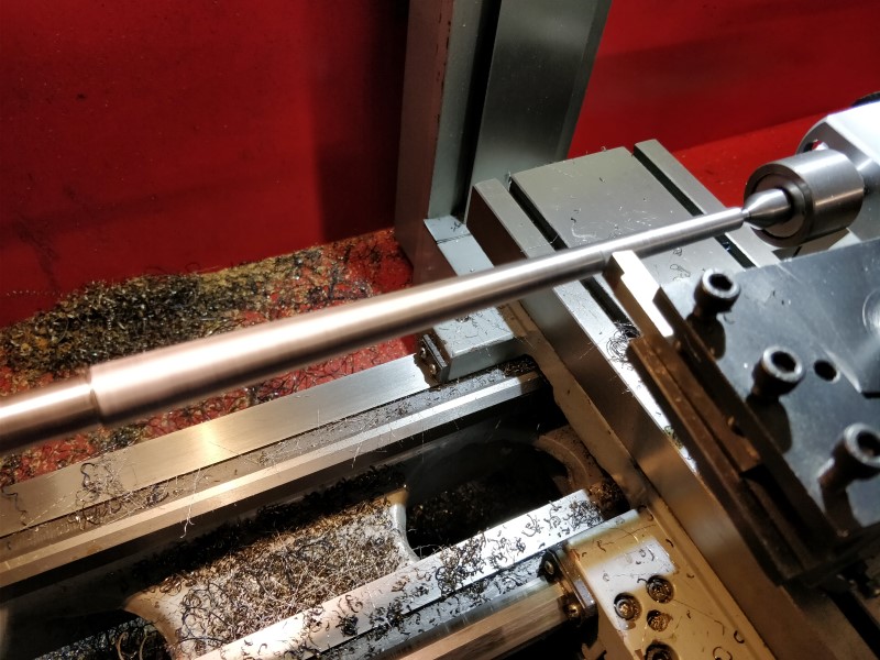

    Turning a reference cylinder :

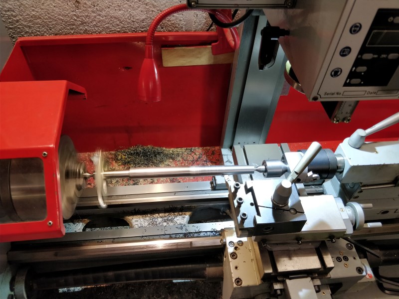

    Offsetting :
    Turning the taper :
    And finally a shearing tool showed here to finish the cone. (This tool is really wonderfull !)
