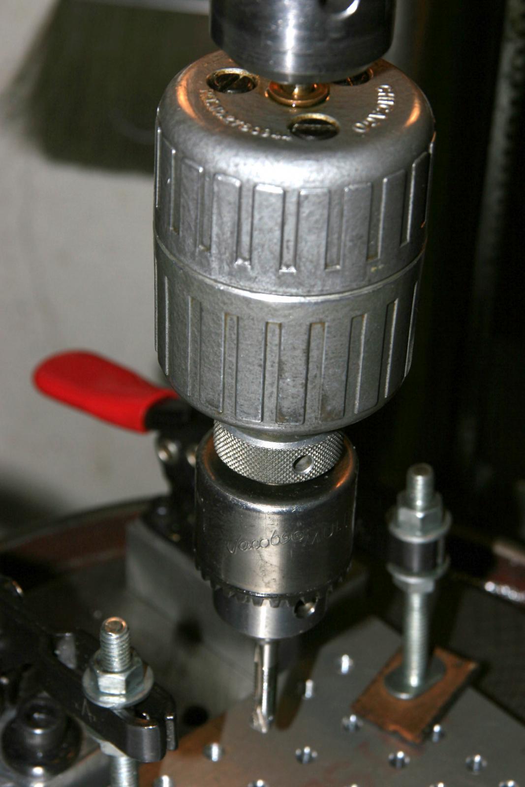

    In a hobby shop like mine I am always looking for a quicker or better way to make my parts.
    I have seen the Tapmatic tapping head and others similar in nature for sale on the net.
    They are quite expensive for hobby use so in looking around I found this Supreme Reversable Screw Driver and
    gear reduction from the way back time. (Some say old timey).

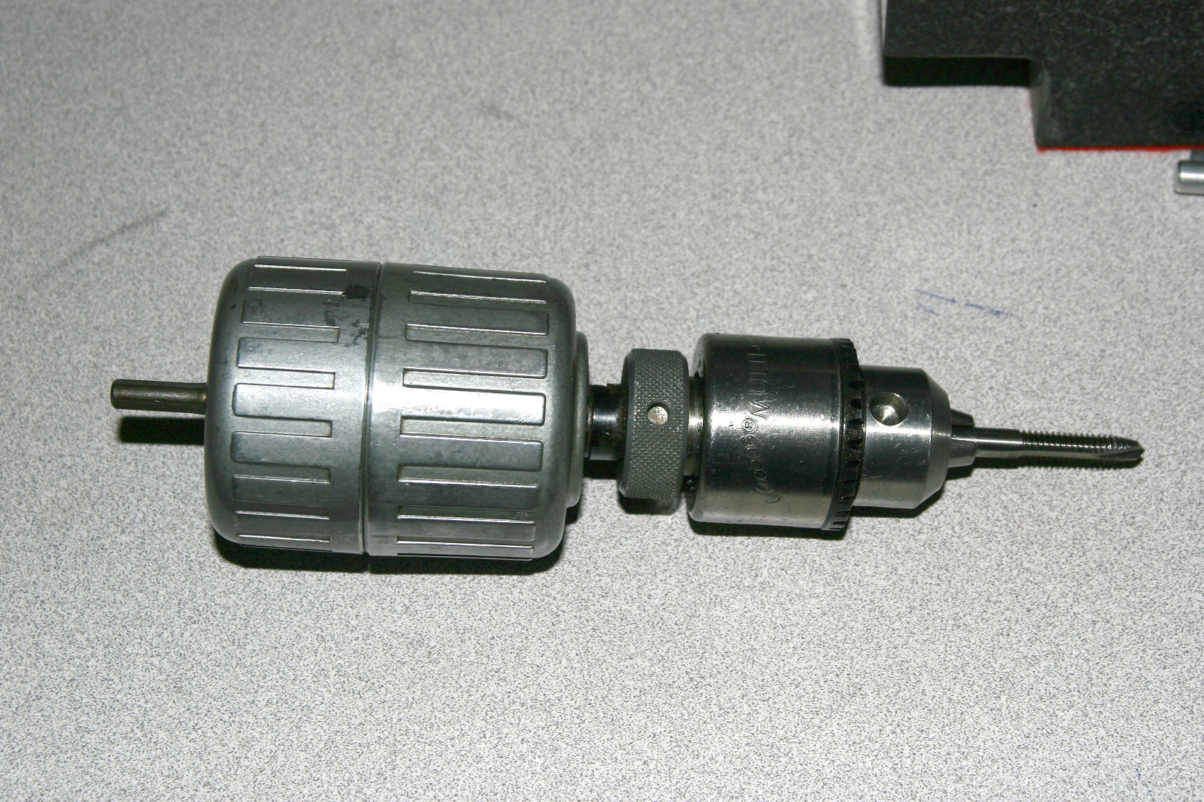

    Anyhow I bought one on the bay for $10.00 including shipping! Had to try that! It has a 1/2-20 nose thread
    so I put on an old Jacobs chuck. The whole thing seems a bit unwieldy but worth a try.

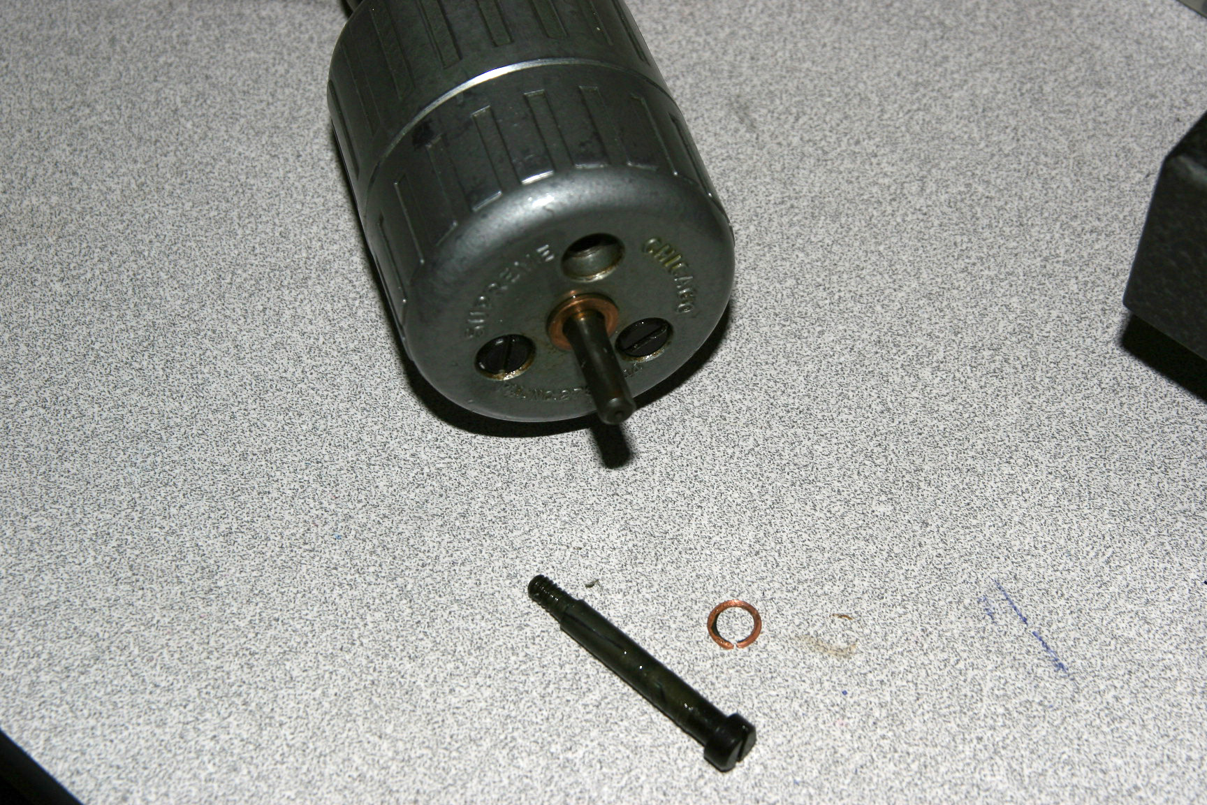

    Disappointed with it when I first checked it out. Sloppy, very sloppy, so sloppy that if spun up in the drill press
    it would scribe a circle with the tip of a tap of about 5/8" in diameter.
    The gear reduction was nice, smooth and the unit would reverse. After taking it apart I decided to take up some of the slop
    by simply adding a small copper washer under all three of the screws holding it together. The washers are #16 solid copper wire
    that I hammer formed to be flat. They are still a bit thick but I was able to just keep the fixing screws snug. This allowed the unit
    to operate in the proper fashion and get rid of that 5/8" circle. Trick is to not get it too tight, if you do it will not work properly.

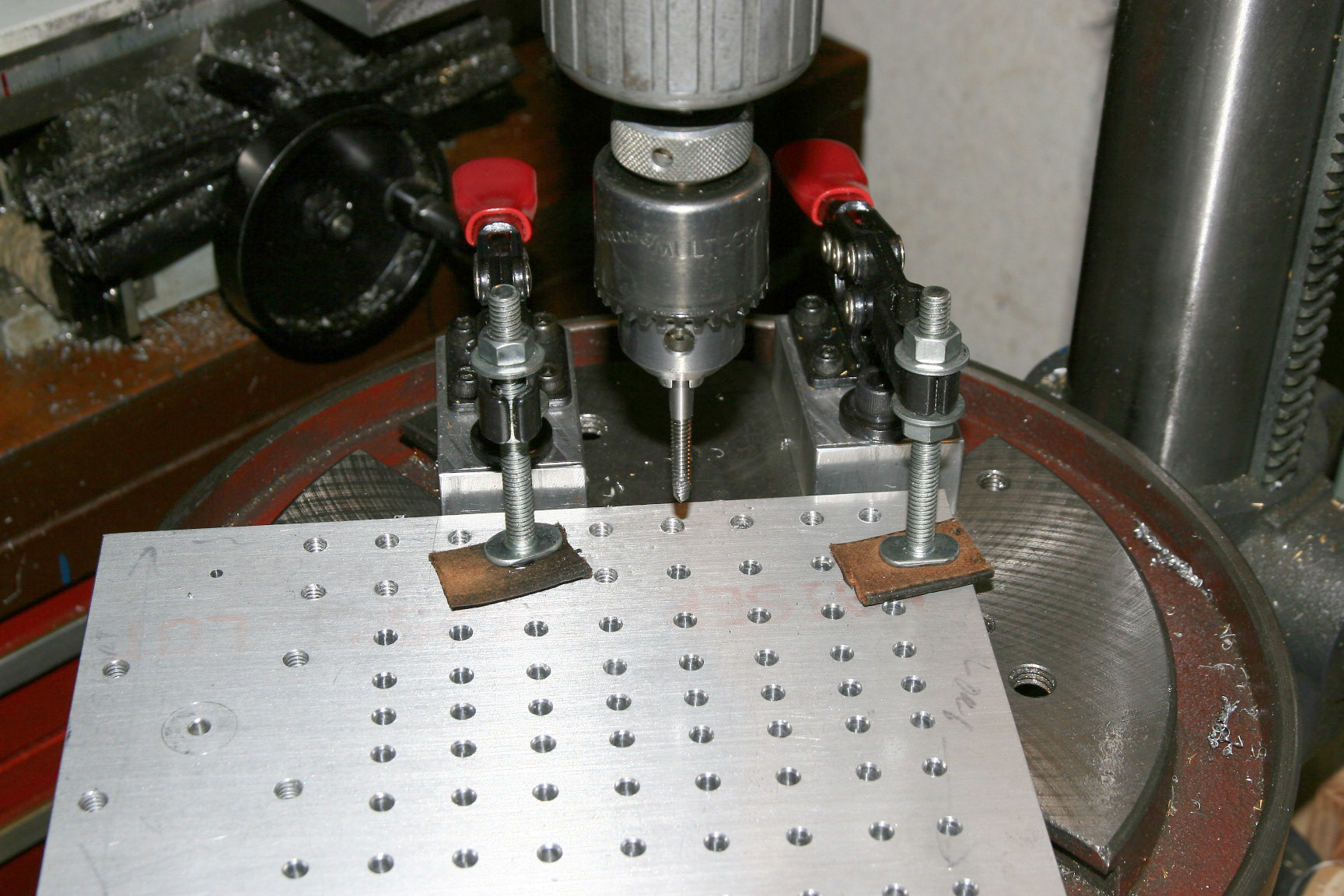

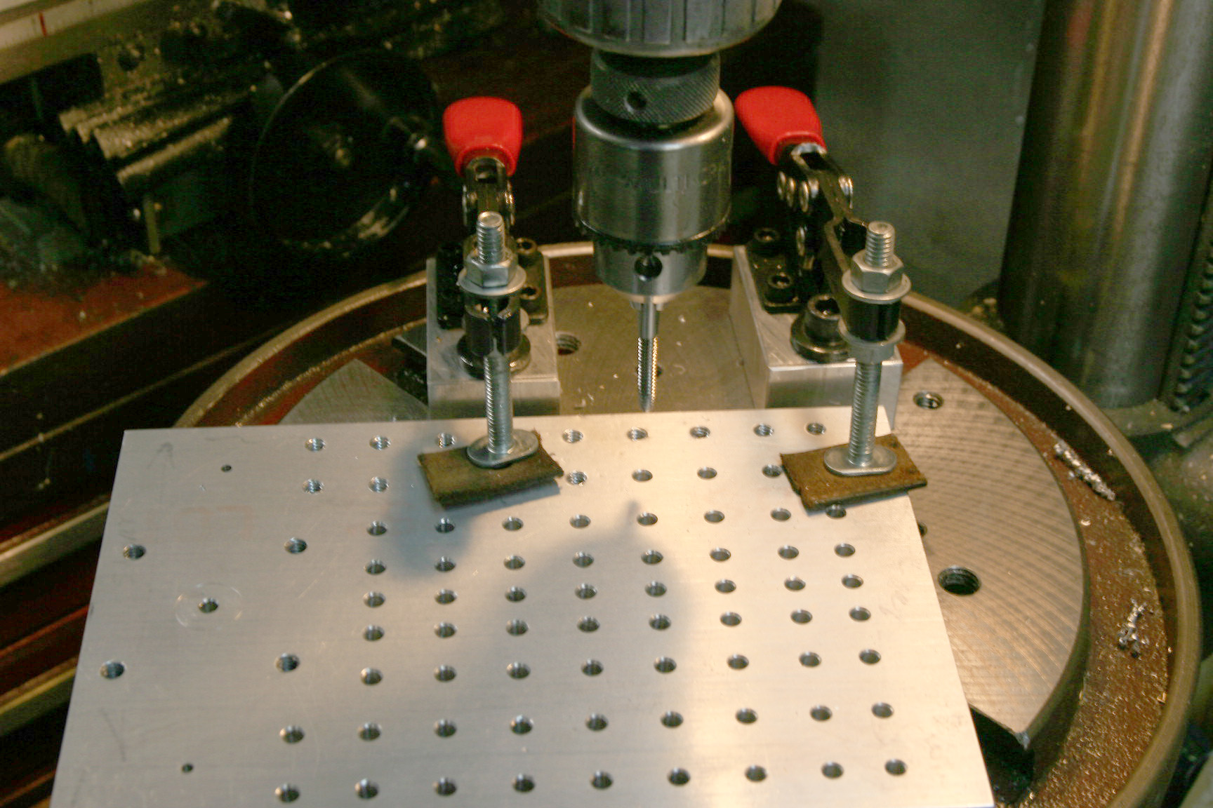

    The Chuck gripped that 1/4-20 better than it was suppose to. Never slipped once in tapping 72 holes 1/4-20 by 5/8 deep in aluminum.
    Requires a bit of effort to run that tap all the way to 5/8 but it works. Reverses and then pull the quill up and on to the next.
    One other key to getting this to work is to clamp the work to the drill press with at least two clamps. I do not want that plate
    spinning around or that tap to snap. Here is a post for the clamps seen in the picture:
    http://www.homemadetools.net/forum/d...9987#post71653
    Now, you do need to turn off the DP motor prior to reversing but that is not all that much trouble considering how much labor
    I saved by not having to hand tap 72 holes.
    Cheers, JR

    "Now, you do need to turn off the DP motor prior to reversing but that is not all that much trouble considering how much labor
    I saved by not having to hand tap 72 holes."
    Cheers, JR[/QUOTE]
    The one I have, you hold either the top or bottom half of the housing to drive or reverse the rotation.
    Just leave the drill press running forward.
    5/8 of slop seems excessive, but you want some float in the spindle to self align the tap to the hole.
    Jim

    Thanks Jim, mine is the 4100 model and to get it into reverse you need to push/pull and rotate the chuck end.
    I think they made this in 4 or 5 varieties over the years. Mine is supposedly just for screw driver use on an
    old portable drill motor that was not reversible. It is not a big issue considering how much labor it saves over
    manually tapping a bunch of holes. I have one more on order and it should be here by Friday. It is different
    and marketed by Buck so I am really interested in how that one works.
    Cheers, JR

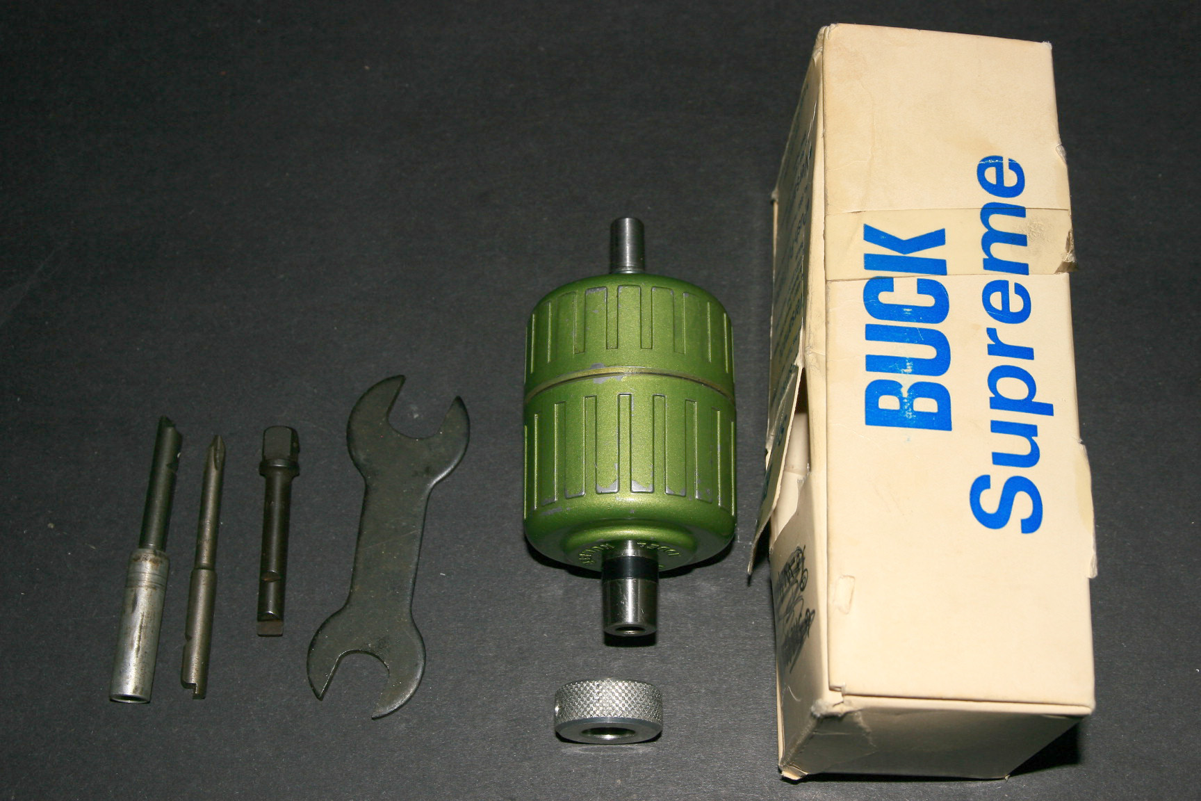

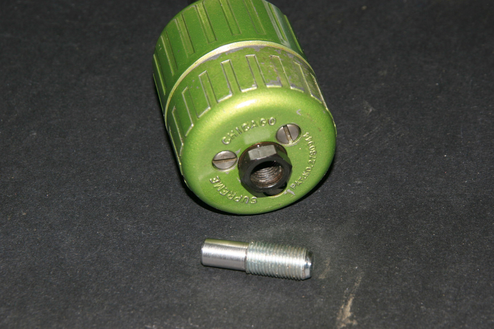

    Buck Supreme Versamatic Model71114

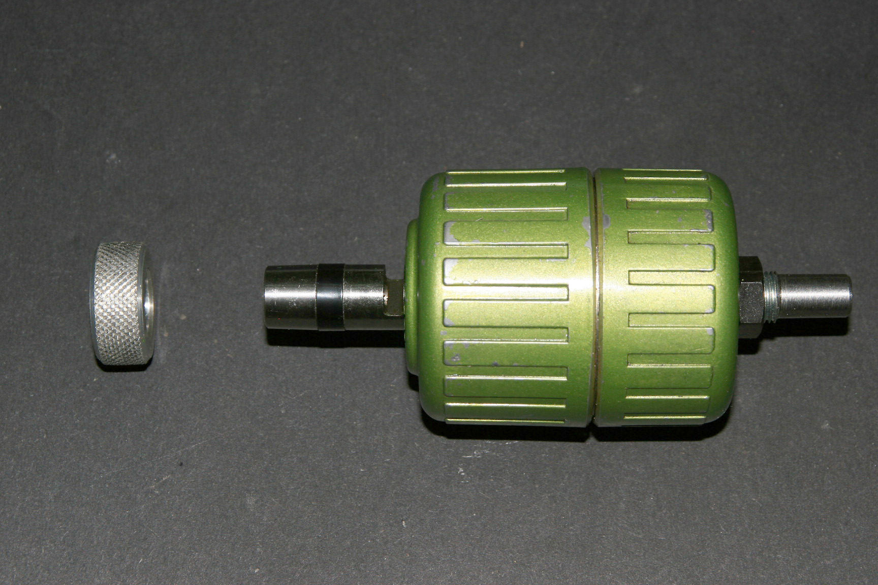

    Here are a couple of pics from my new (used) Versamatic.
    This one is in a Buck box with a model number of 7111.
    Better than my first copy this one has a 1/2-20 female thread for an arbor.
    I made up a quick one from a 1/2-20 bolt so I could put it in my DP.

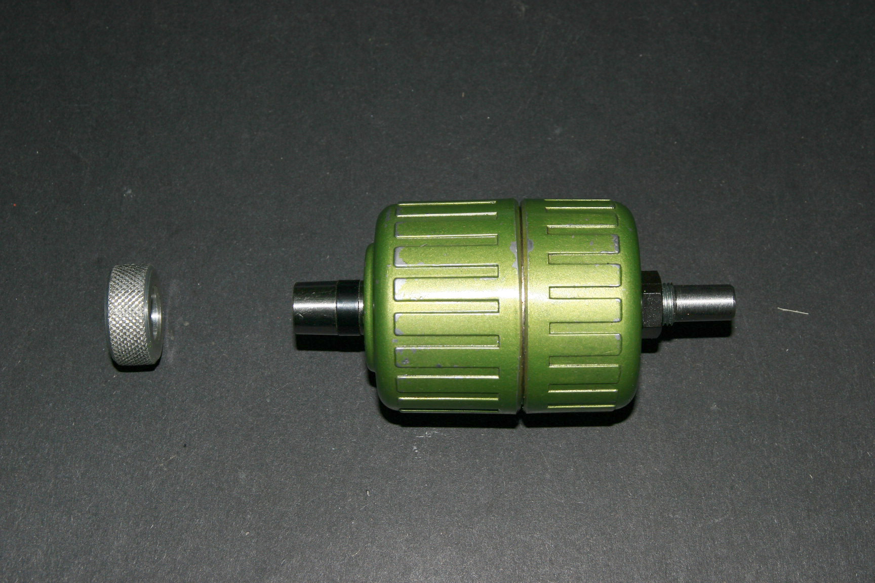

    The output end has a 33JT stub that fits my new chuck perfectly.
    The knurled aluminum knob has a 33JT socket for use with the screwdrivers. (Yankee type).
    In the 4th picture you can see the output shaft extension, picture 3 shows it retracted.
    Extended is CCW and Retracted is CW rotation.

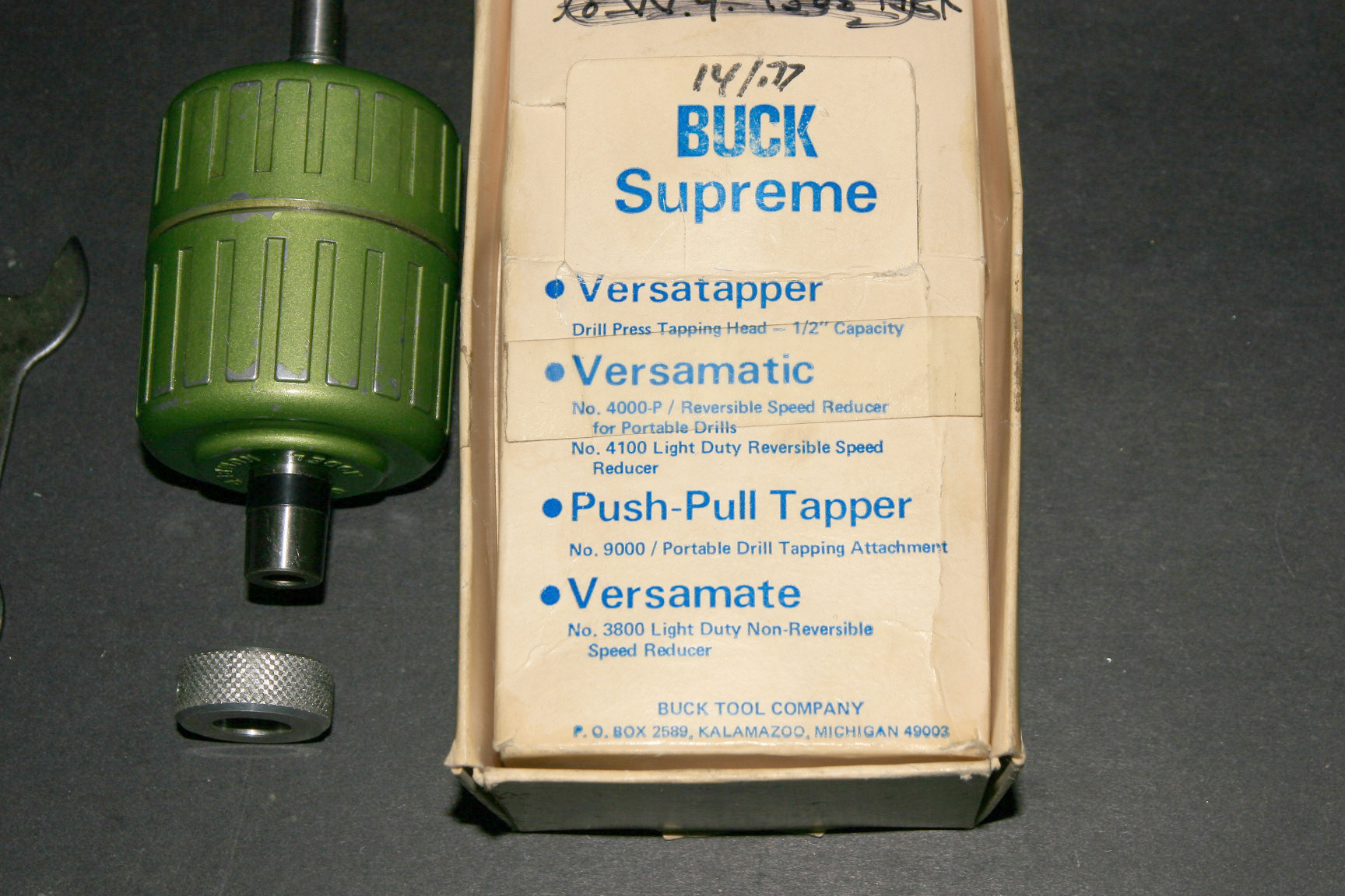

    The front of the Buck box lists :
    Versatapper (Best one for machine tapping and quite like a Tapmatic)
    Versamatic 4000-P and 4100 Like mine I believe.
    Push_Pull Tapper No 9000 This one would be nice for a home shop drill press use.
    The 9000 has specific chucks for taps.
    Versamate Speed reducer only.
    These are just the ones listed on this box!
    Cheers, JR
