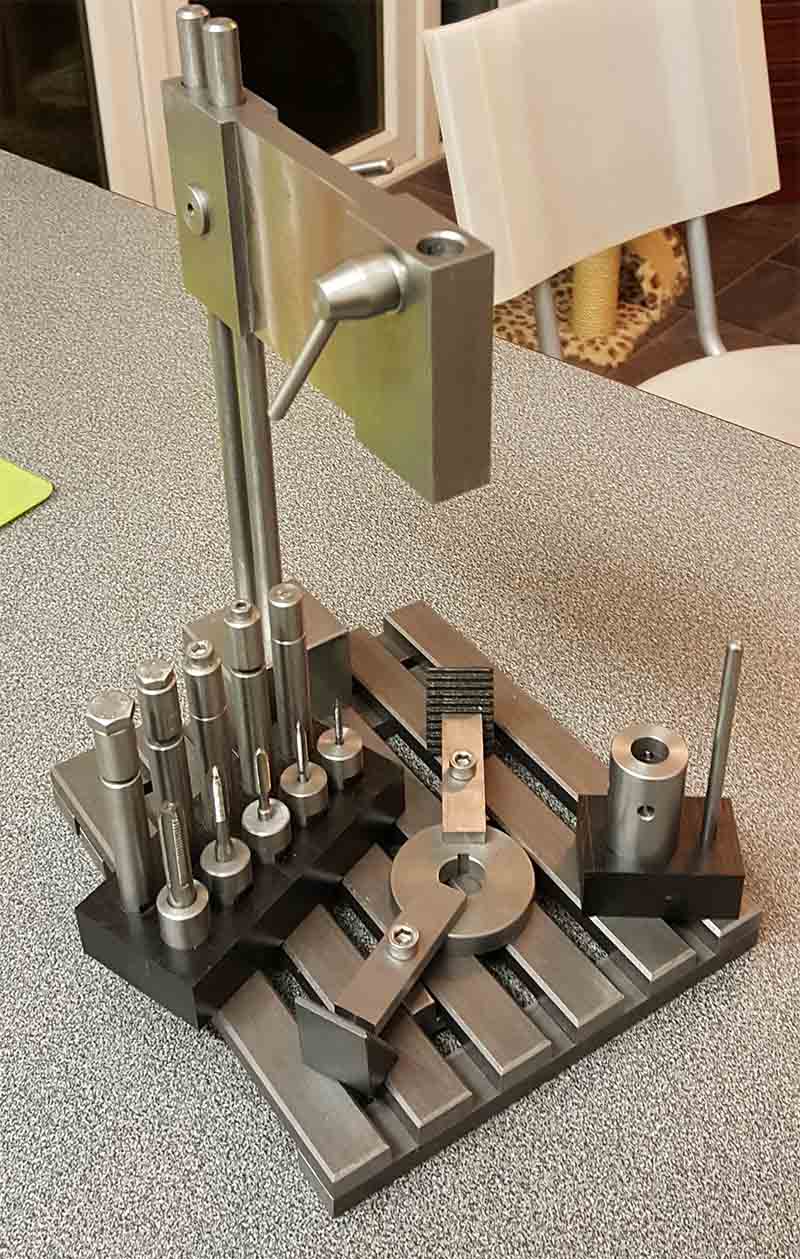

I just finished my Tapping Stand
Its built from the plans in Harold Halls book " MODEL ENGINEERS WORKSHOP PROJECTS "
book 39 in the workshop practice series
Its a nicely thought out design but then thats true of all of Harolds designs
What is clever with this design is each tap has a corresponding feed screw mechanism
which automatically feeds the tap downwards at the corect speed to match the pitch
of the thread
I am pleased how it came out
Don
