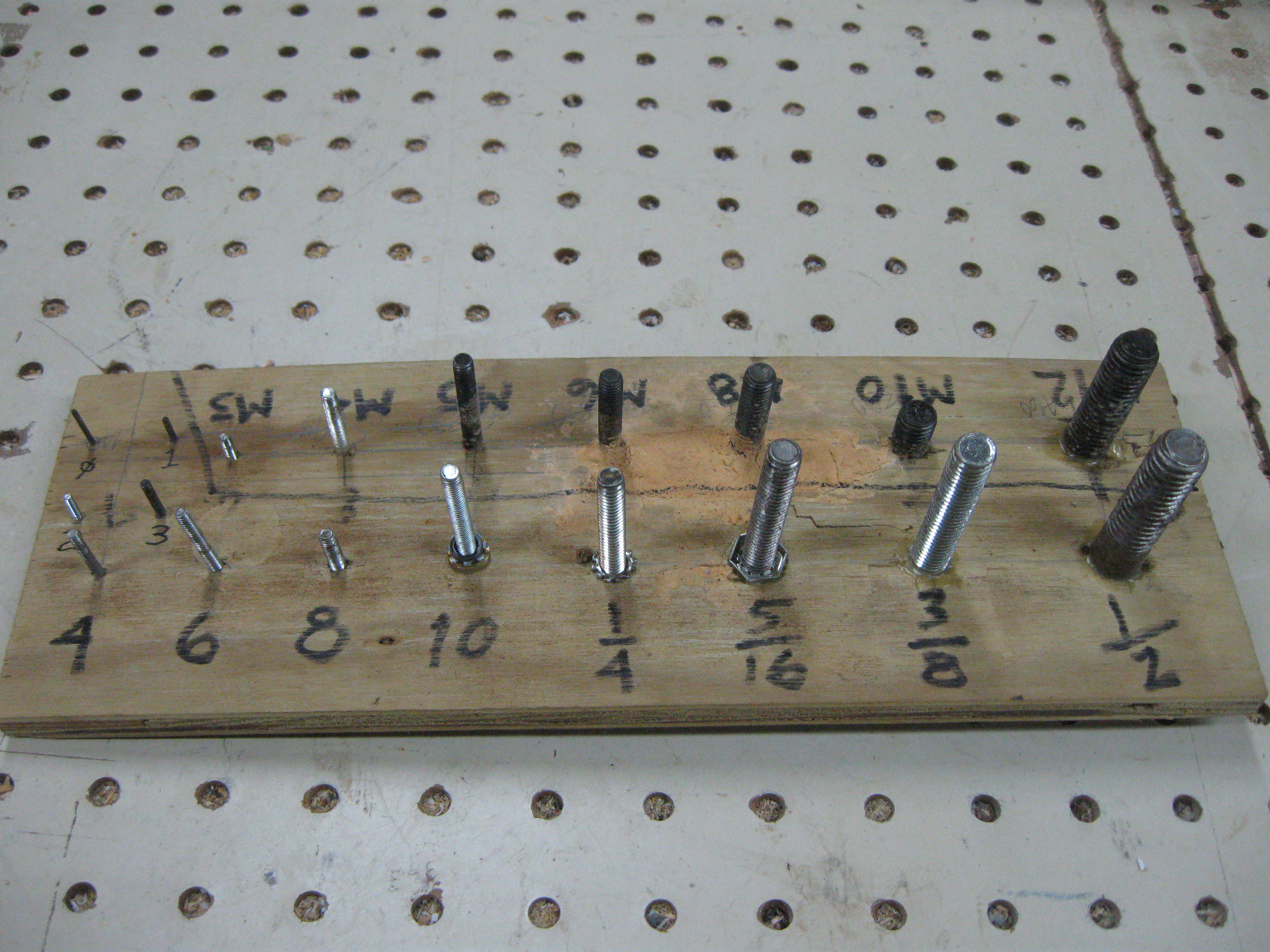

    I suppose this is more a hint than a tool but it's still a useful device that should be valuable to novice machinists.
    In modelmaking one makes a lot of threaded parts and, as a consequence, acquires a large collection of taps and dies. Whenever I encounter a new thread and need to buy threading tackle, I buy two taps and a die for the required size. I use the tap to make a nut and then adjust the die to make a stud that is a smooth running fit in the nut. These test pieces go in a pill vial, along with the taps and dies. The cap of the vial is Sharpie-marked (black for inferial and red for metric) with the thread designation, and tap drill for 65% thread depth (makes threading easier and reduces tap breakage). A large 'LH' in green is added for left-hand taps and dies.
    If one encounters an unidentified thread, there are numerous ways to identify it. If it's a male bolt/screw, thread checker plates, e.g.,
    Enco - Guaranteed Lowest Prices on Machinery, Tools and Shop Supplies
    can work but they often don't cover the smaller or seldom-used sizes and, more importantly, are impossible to use if the threaded stud is attached to machinery that blocks the rotation of the checker. Nut and bolt checkers, e.g.,
    Nut & Bolt Thread Checker (Inch & Metric) - Tap And Die Sets - Amazon.com
    suffer similarly in size coverage.
    I could dig my test pieces out of their vials and use them as checks but that's too tedious for me. So I put together a plate with a nut and bolt sample of all the sizes I encounter...
    In the case of bolts not in my collection (e.g., the very uncommon 5-44), I simply make another set of checkers using the tap and die in my collection. Since I have a fairly large fastener collection, this happens very infrequently.
    A personalized set like this covers several points. Any nut or bolt can be removed and taken to the questioned thread for checking plus its presence in the set proves that I have the necessary threading tackle to make whatever is required, male or female.
    Make yourself one of these; it will save you both time and aggravation.

    Thanks Marv. I've seen boards like this (Mr.Pete I think). Handy but a bit cumbersome IMHO. I found and like the Stud/nut rope on Amazon a while back (wish list) as it would be handy and could be used as test fits while still chucked up. It could also be added to by building additional sizes one runs across as necessary. Although they don't state it, but would assume they are 2-a/b fits. The use of thread standards is just too costly for us home shop guys on a budget. I do like your idea of the vials with all the necessary tools per size, particularly the tiny stuff.
    Thread depth is an interesting topic. Is 65% your go-to or just for smaller taps? IIRC, standard tap charts are for ~70-75%, giving a ~2a/b fit. A while back I had a big lesson on tapping a 6-32 thru hole in a 1/4-28 SHCS (socket head cap screw). Obviously a tough do with the hardness, length of engagement, thread depth and type of taps. With an adjustable die its pretty easy to ease into it but on the male end there are not adjustable taps but a lot of profiles, materials and types to choose from and cost can be an issue for the hi-zute ones. Being your kit is substantial I would be interested in your thoughts on types you prefer.

    Marv,
    I like the idea and have been wanted to do this with a pair of stud/nut ropes that PJs mentioned. I bought these from ENCO with my 20% discount and free shipping offer. One set is metric and the other Imperial but the thin steel cabling used to string the stud/nut combination is convenient for keeping the set together but makes it very difficult to use. I wanted to do something like you did with a labelled board and cut the thread/nut sets off the cable and place into a convenient board. Using the stud/nut without the cabling getting the way will be a lot easier but I haven't done this yet. At now I have your example.

    I had considered getting the metric nut and bolt checkers on a cable from ENCO but put it off. It seemed to me that the cable would really get in the way; your comments seem to confirm that. Plus, the advertised item doesn't cover a lot of the really small metric threads I encounter. I suppose I'll just make another board like the one shown when a find a nice round toit.
