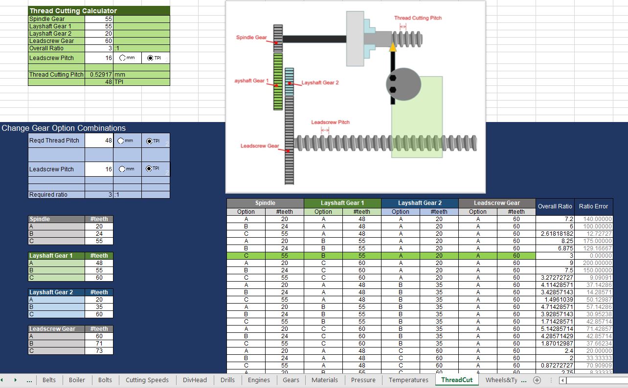

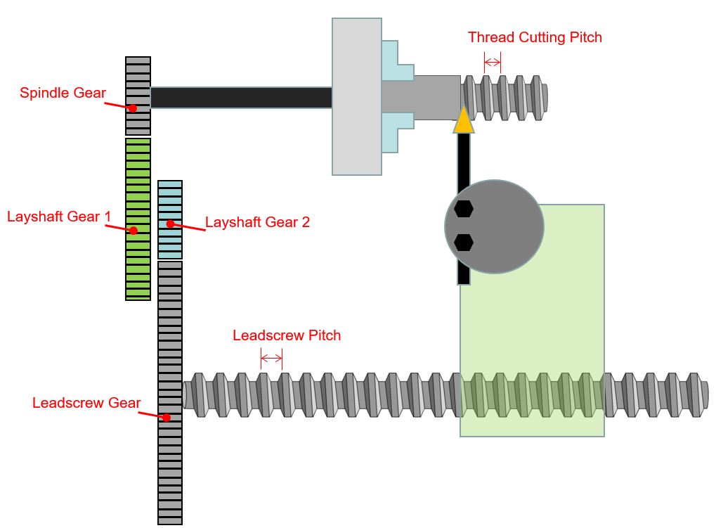

Just thought I would make a simple online Thread Cutting Change Gear Calculator
Uses number of teeth on each of the four gears and the leadscrew pitch - works with TPI and mm
Attachment 41249
Let me know if it is useful or you need other options or even calculators
