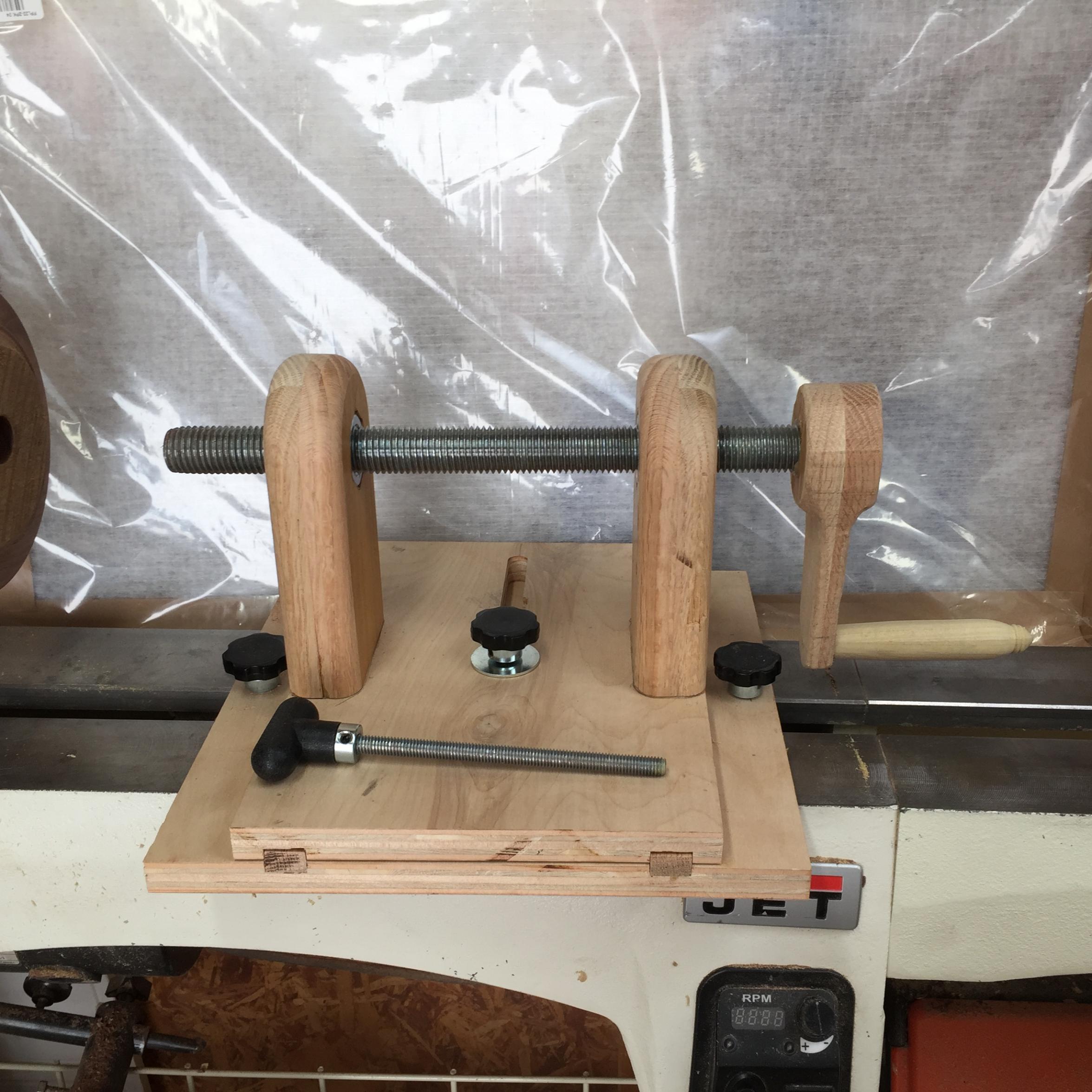

    This is my homemade thread cutting jig for a Jet wood lathe. The One Way chuck goes on the end of the threaded rod and a fly cutter in the lathe head. Cutter is from Chefware and rest of parts from Lowes.
