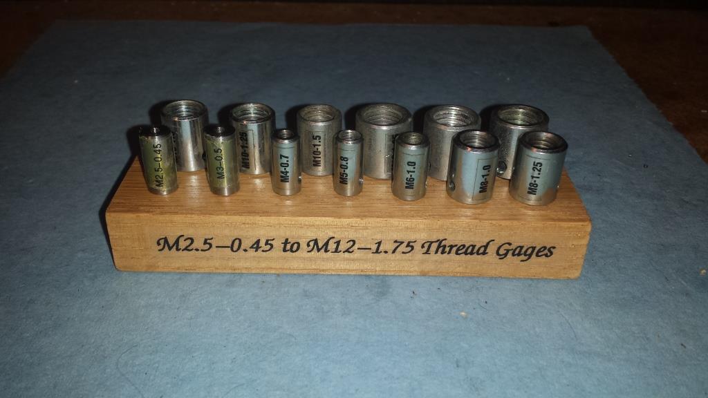

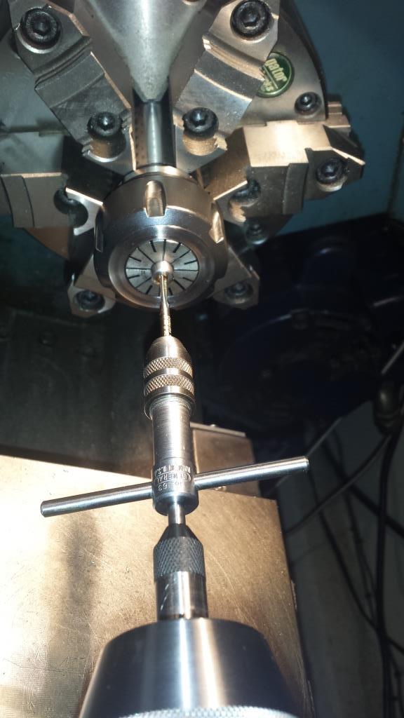

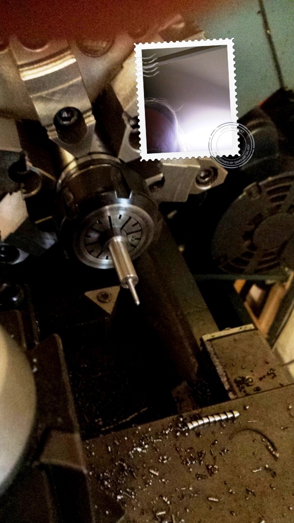

I finally finished my metric thread identification caddy. I didn't have the M2.5-0.45 and the M3-0.5 gages and made these from 12L14 steel.
Attachment 22817
The machining was very easy using taps and dies to make the thread gages.

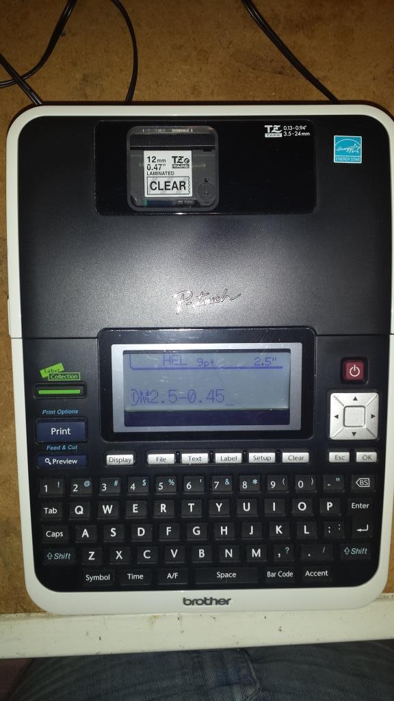

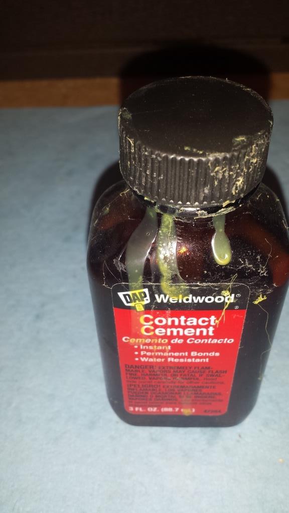

I used a P-Touch labeller for thread gage ID but had to use contact cement to permanently attach the clear labels.

Thank you for looking,
PaulJones
Whenever I buy a new tap/die set (I usually buy the two together), I use them to make a screw and nut sample to keep in the pill bottle with the tap/die. This provides me gauges for testing threads produced later with the tools as well as identifiers for unknown threads. I thoroughly recommend this habit.
Despite having both inferial and metric thread checkers, for some reason it never occurred to me to make the sample as a single piece and mount them in a holder for ready reference. I must train myself to do that in the future.
