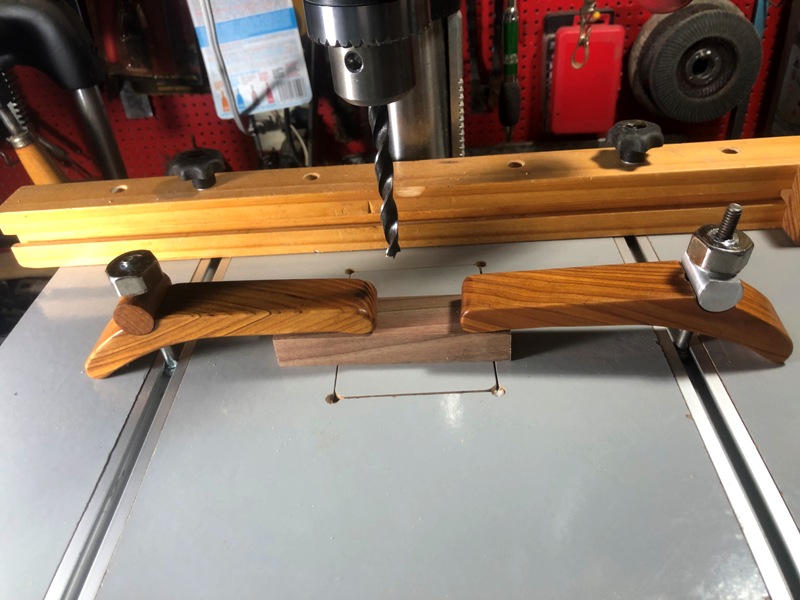

I know; there are dozens of homemade threaded knobs. Besides, commercial items are widely available in several sizes, shapes, and prices. Furthermore, now it is possible to make them, in any shape, color, and size, at a reasonable price, with 3-D printers.
The threaded knobs I show here are made with discarded plumber pieces:

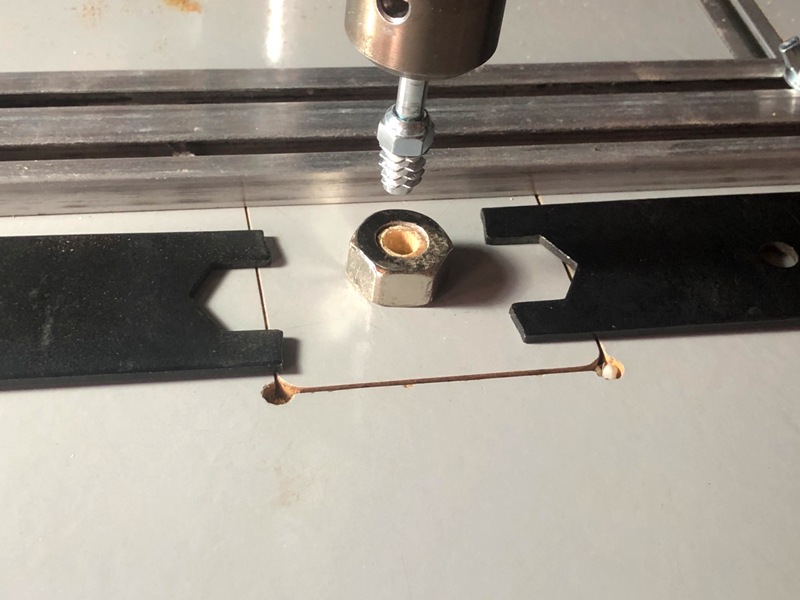

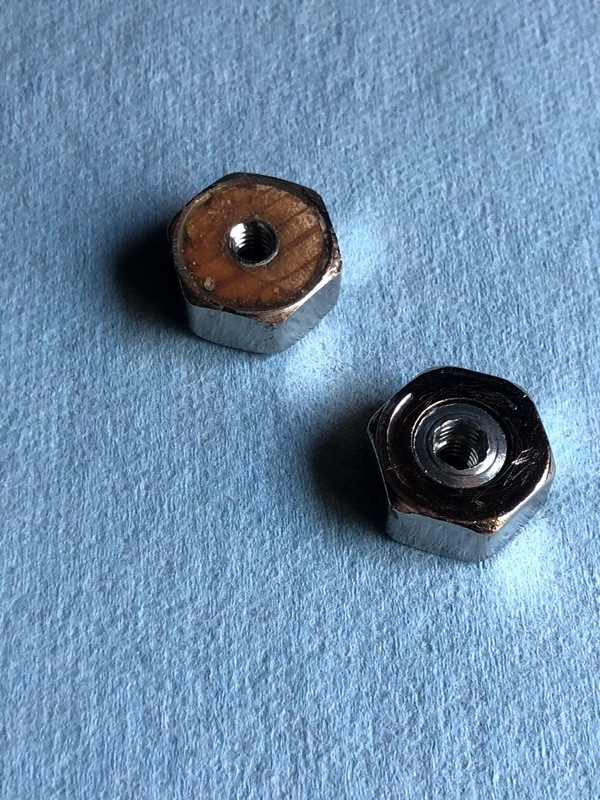

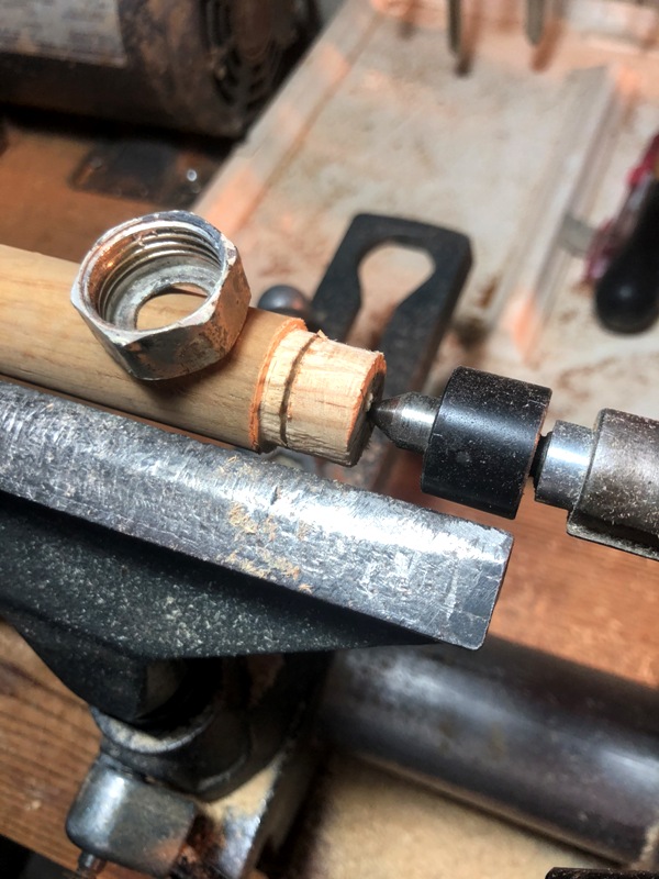

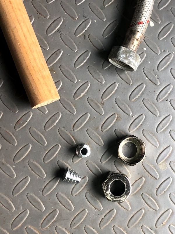

1. Female knobs. A nut from a flexible toilet hose, a wooden plug, and a type D insert (1/4" x 20):
Attachment 39346
Attachment 39347
Attachment 39348
Attachment 39349
Attachment 39350
Attachment 39351

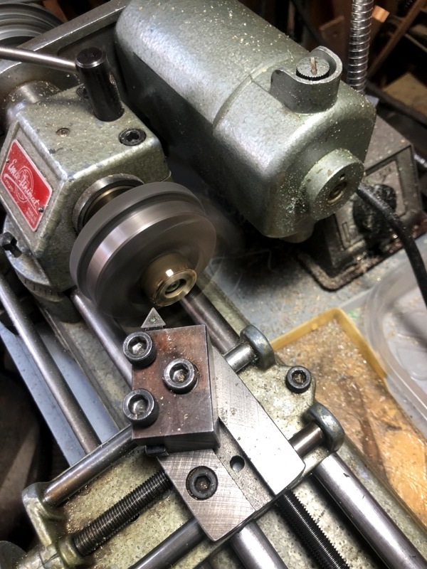

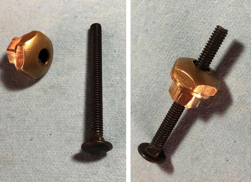

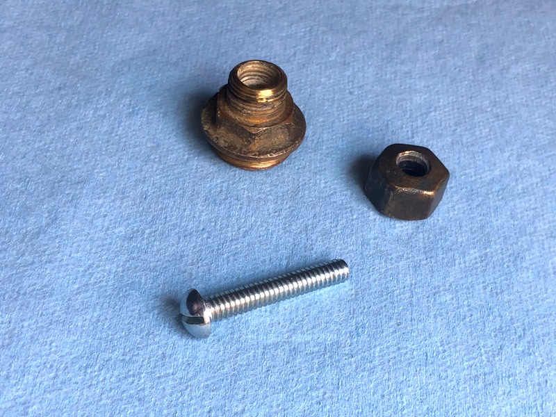

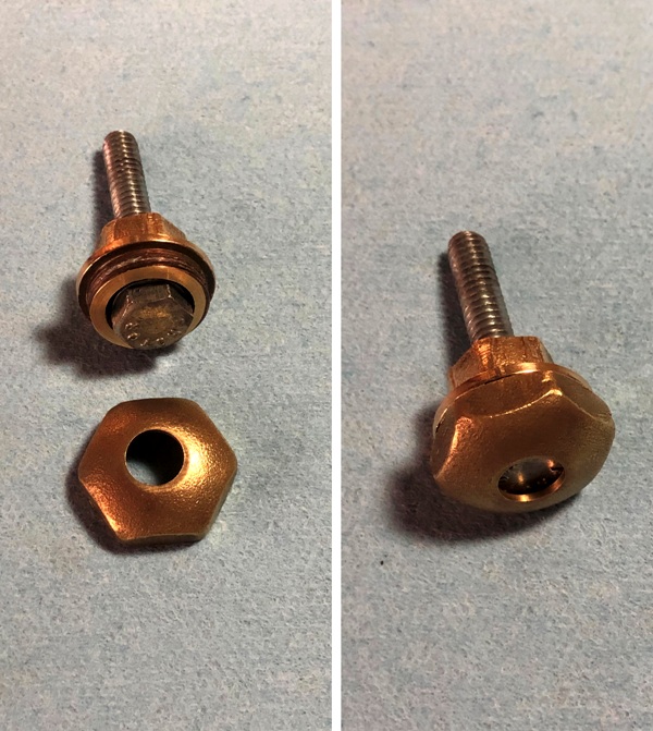

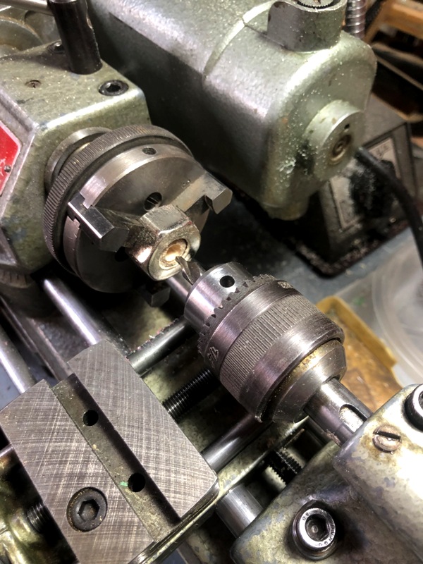

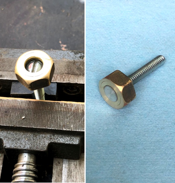

2. Male Knob. Two matching bronze plumber pieces, a ¼" x 20 round head screw:
Attachment 39352
Attachment 39353
Attachment 39354

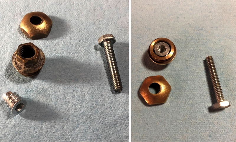

3. Male/female knob. Two matching bronze plumber pieces, a type D insert (1/4" x 20), and (optional for the male knob) a ¼" x 20 hex bolt:
Attachment 39355
Attachment 39356
Male knob
Attachment 39357
Female knob
