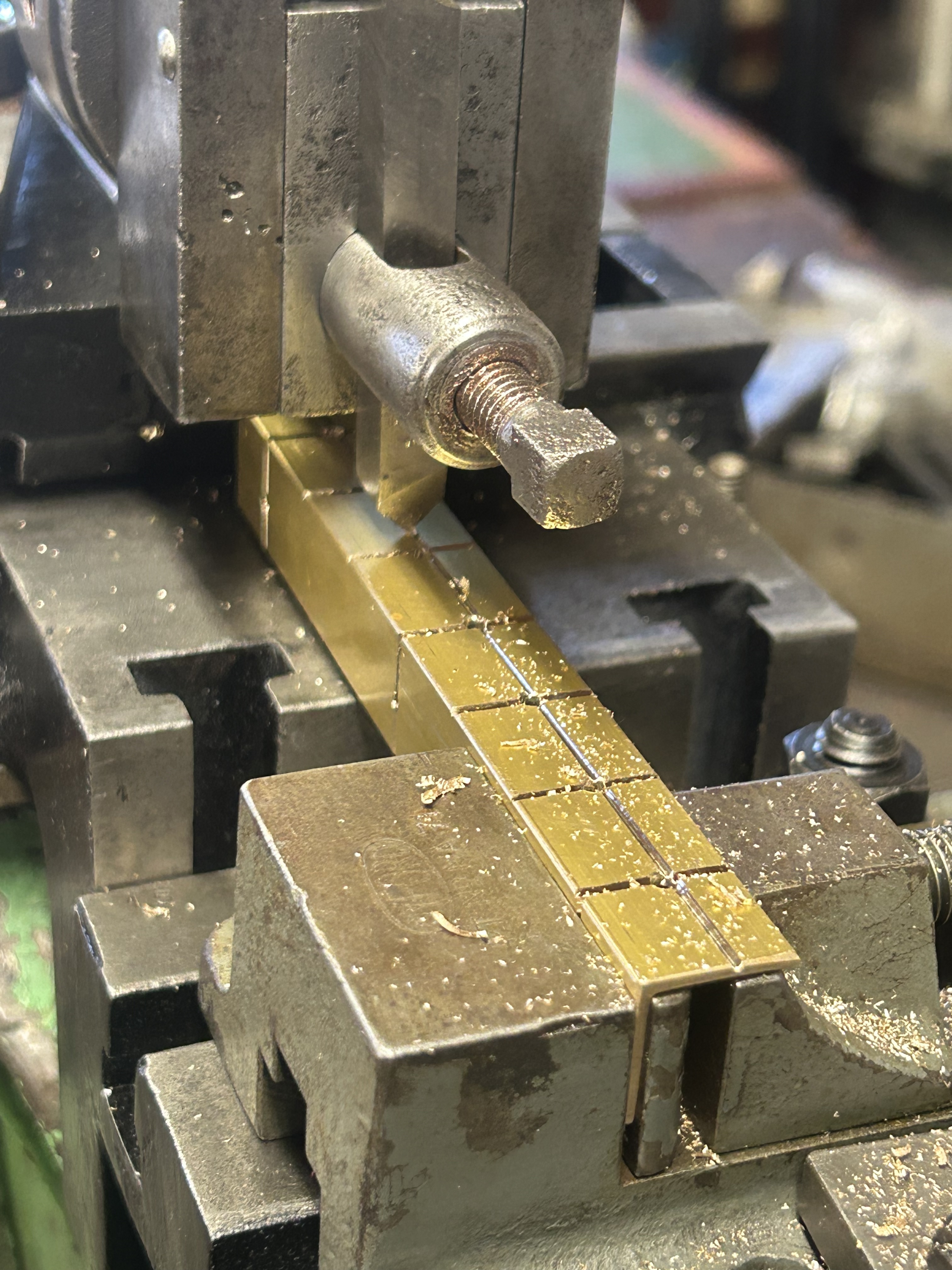

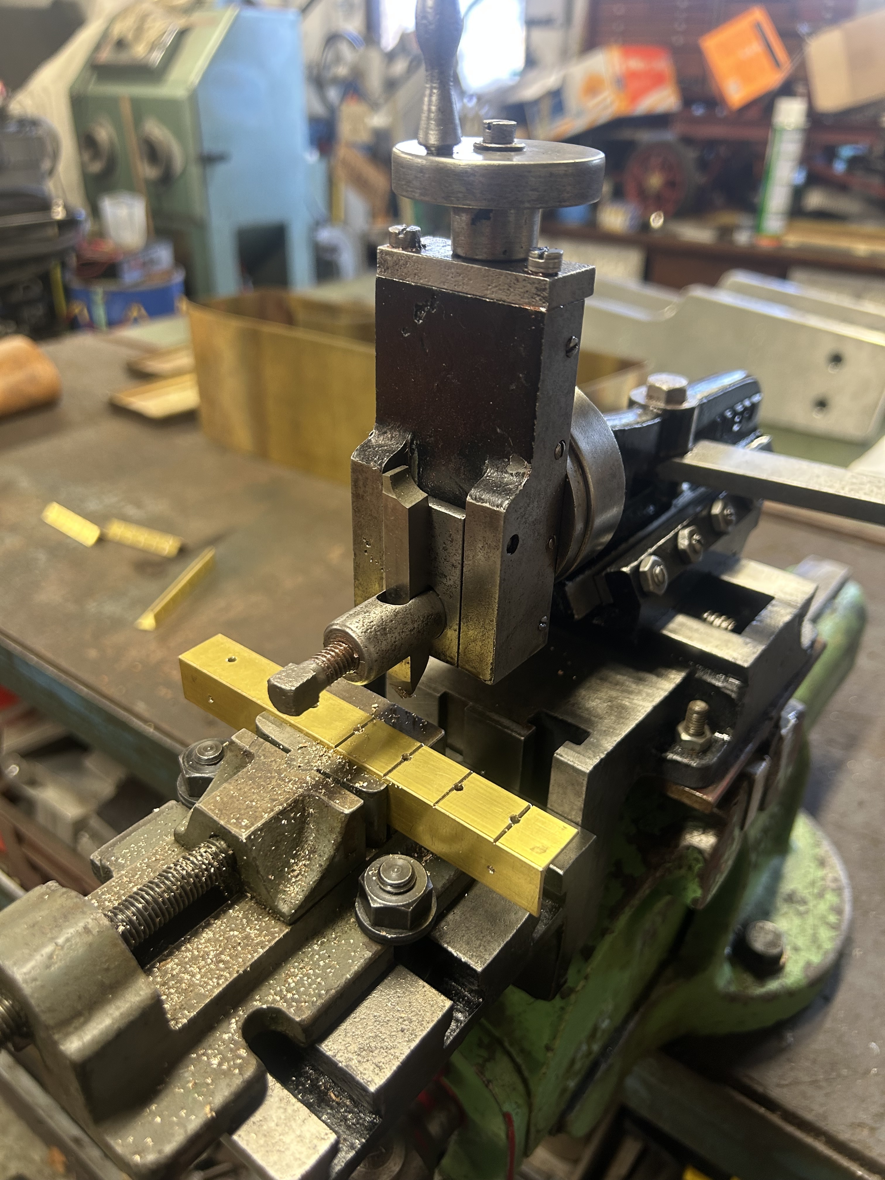

I am starting to build the water tank for my 3” scale Foden steam wagon. This will be soft soldered and riveted. When riveted there is no gap for the solder to capillary into the joint. So to overcome this issue I cut grooves in the mating part to allow the solder to run into the joint. Normally I would simply use a file to cut the groove but recently I was given a rusty Adept hand operated shaper which I resorted so thought I would use it to cut these grooves. This was far easier than filling and certainly a lot quicker. The photos below show the process and result.
Attachment 50502Cutting across the rivet holes so a water tight seal can be achieved as well as creating a stronger joint.

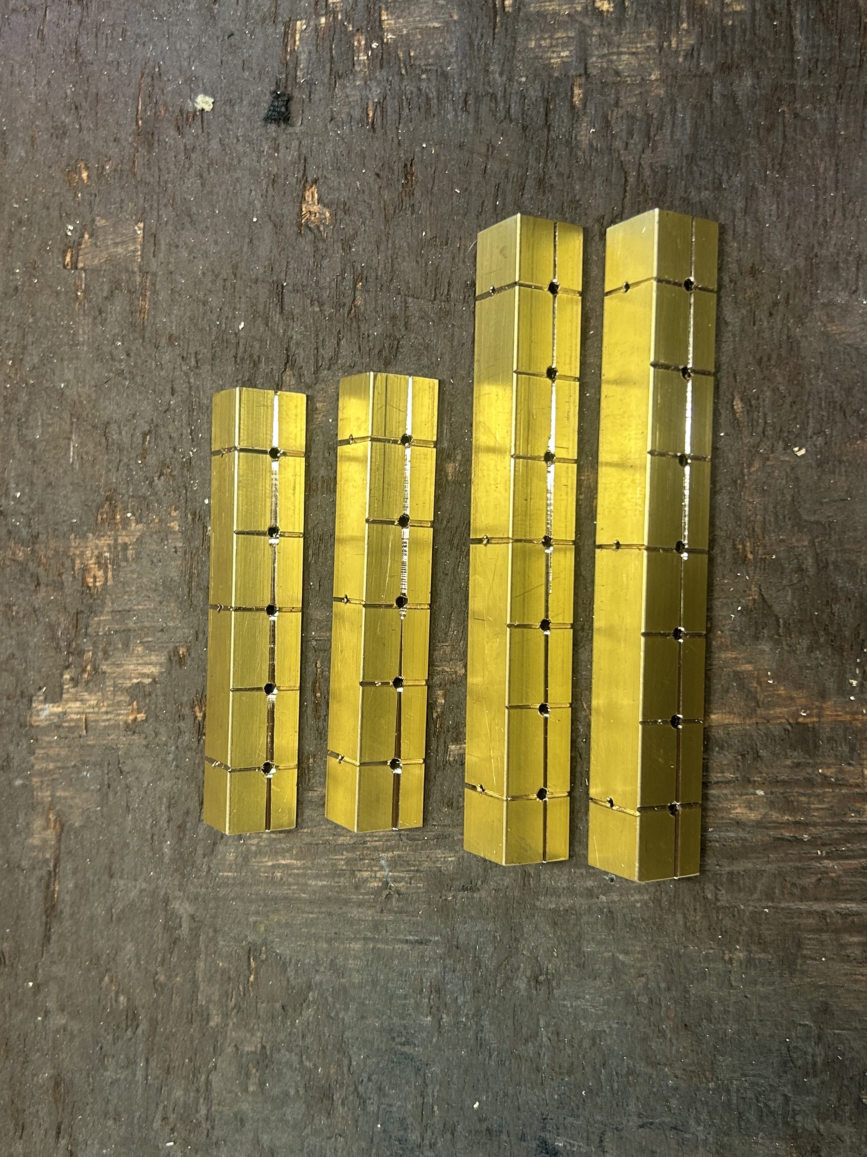

Attachment 50503These angles will be used to support the plates for the internal baffles.
Attachment 50504Completed angles ready for soldering. Flux is placed between the joint before riveting.

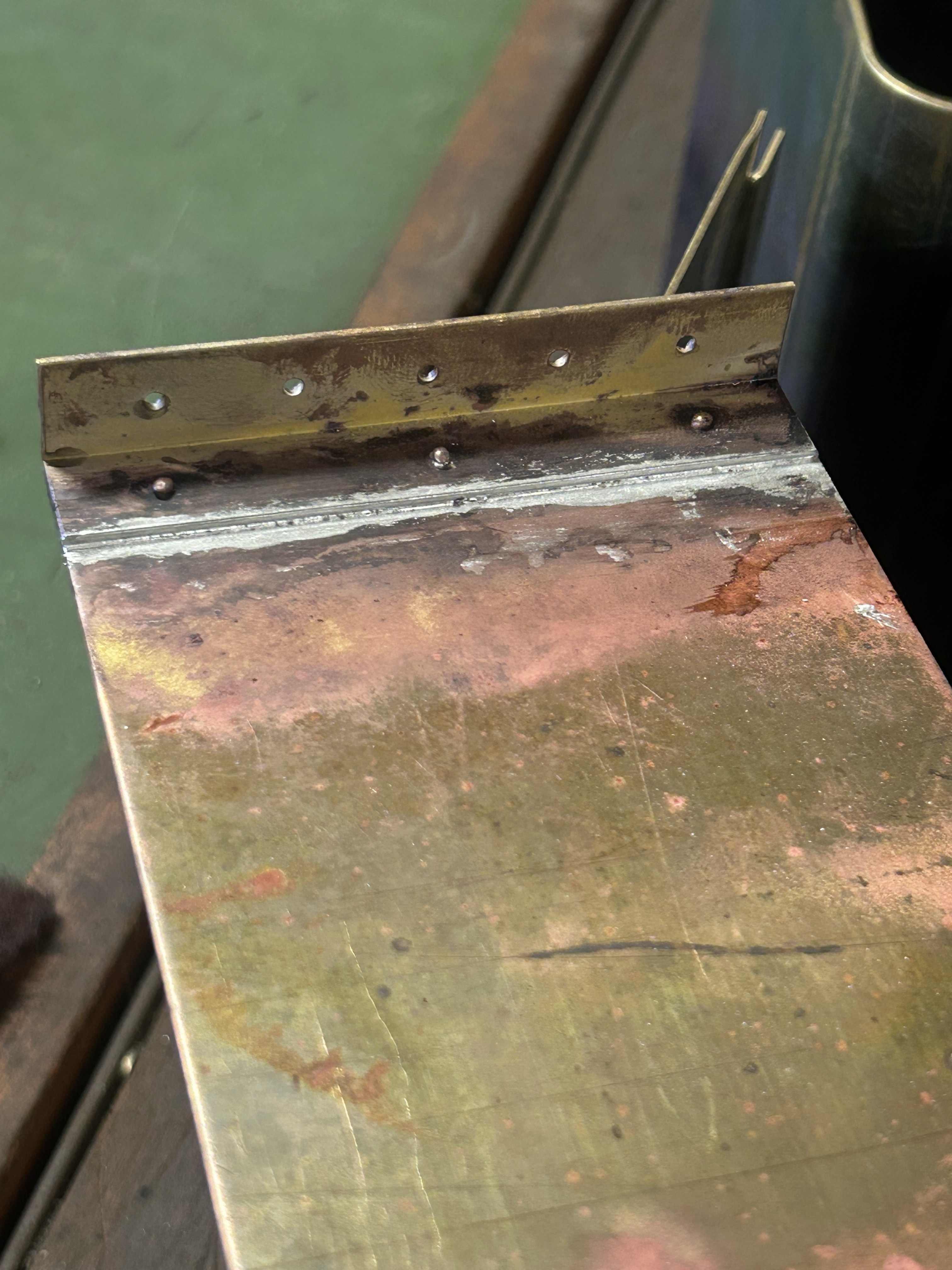

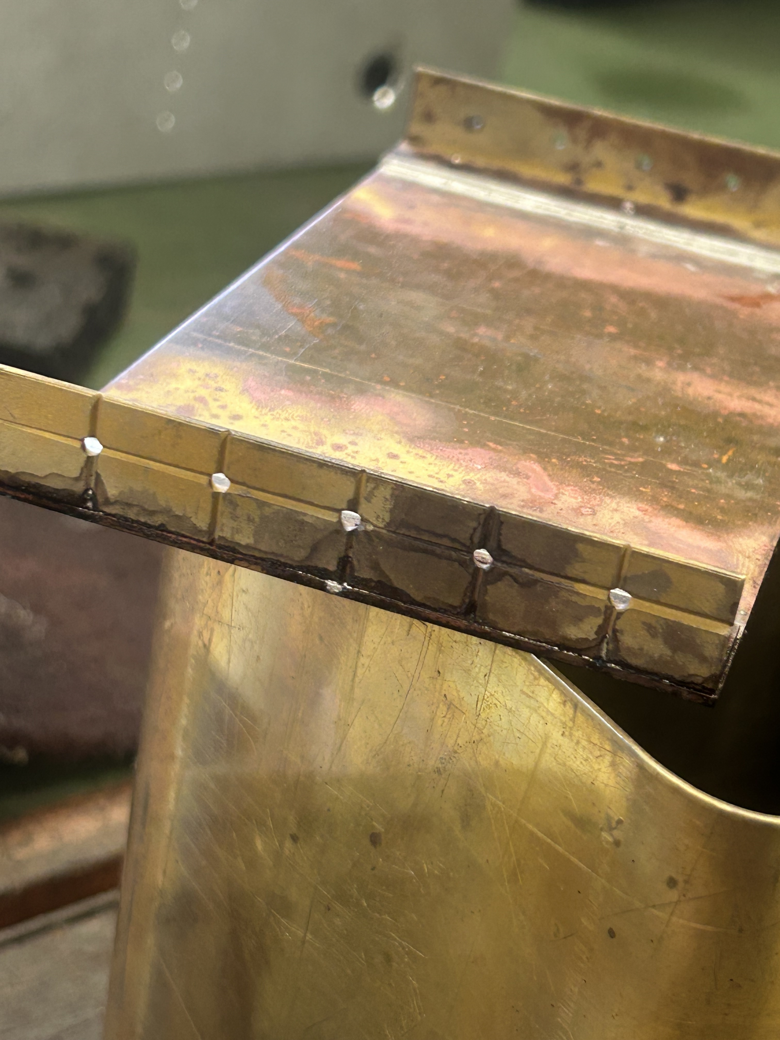

Attachment 50505As can be seen the solder has flowed through the joint and therefore around the rivets.
Attachment 50506Just requires cleaning ready to solder too the side plates of the tank
I also use this method for silver soldering so the solder can capillary freely through the joints.
