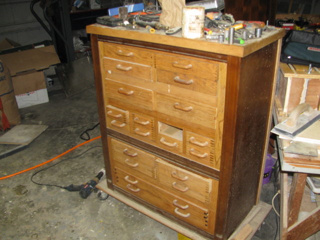

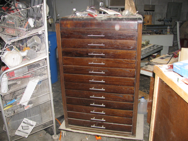

    I was cleaning my garage and forgot that I had made these tool chests out of old chest of drawers, thought you might be interested. I was experimenting with different kinds of joints, so I decided to make some drawers and make them into a chest. On Craigslist, I found these old chests and converted them. On the dark one, I put in stainless drawer slides and on the lighter one just the drawers into wood slides. The one with drawer slides was fairly easy to make after the drawers were made because the outside of the slides were attached to a rectangular piece of plywood just set into the sides and not attached to anything, free floating. Once the spacing was marked the outside of the slide was attached to the plywood and then the drawers just slid in. Relatively easy. The other one however was more difficult because of the spaces needed to make room for the drawers. Both have large casters for easy moving. Bob.Tool chest of drawers from old chest of drawers-img_2199.jpgTool chest of drawers from old chest of drawers-img_2200.jpg

    Yes, it's all solid wood, the drawers are made of Poplar and the fronts are Oak. The dark one with stainless drawer slides was very easy to make, considering what you end up with. It's been very handy, since I am so unorganized, helps quite a bit. I will try, in the future, to show off some false dovetail joints, also easy with two jigs that I have made. Some of the joints that you see are finger joints and some are false dovetail joints. I start out with the joints cut at 45 degrees and then add the false joints, also very strong. Bob.
