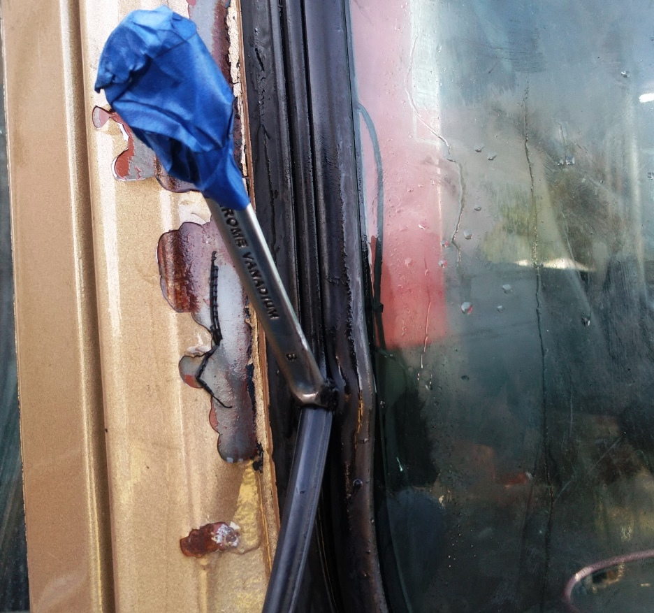

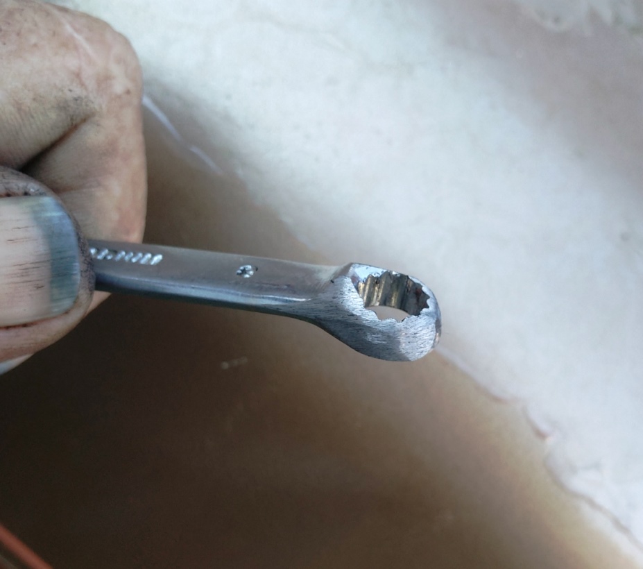

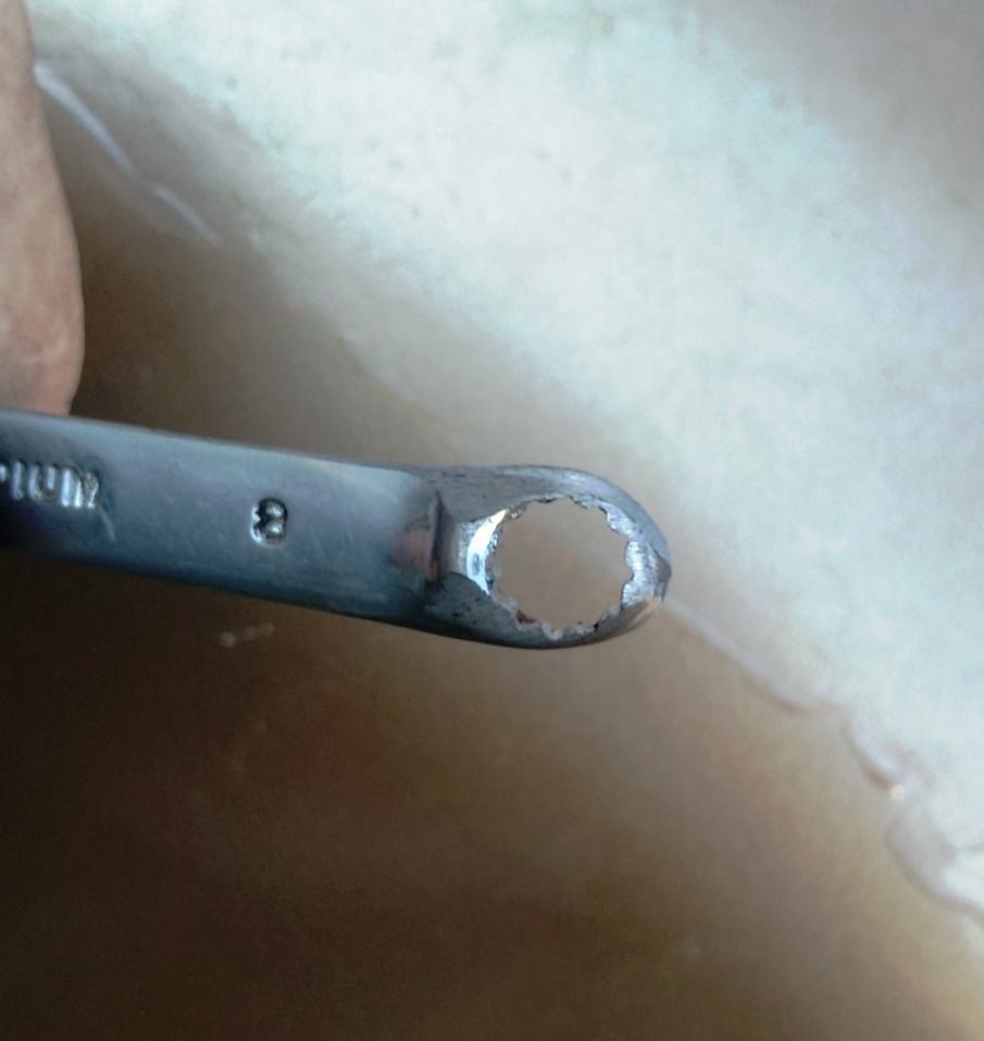

Fine the glass arrived a couple days later. Installing this older glass is nothing new to me I've done it many times But same as he I didn't have the lock strip tool, so I made one out of an 8mm box end wrench
Attachment 47814
Attachment 47815

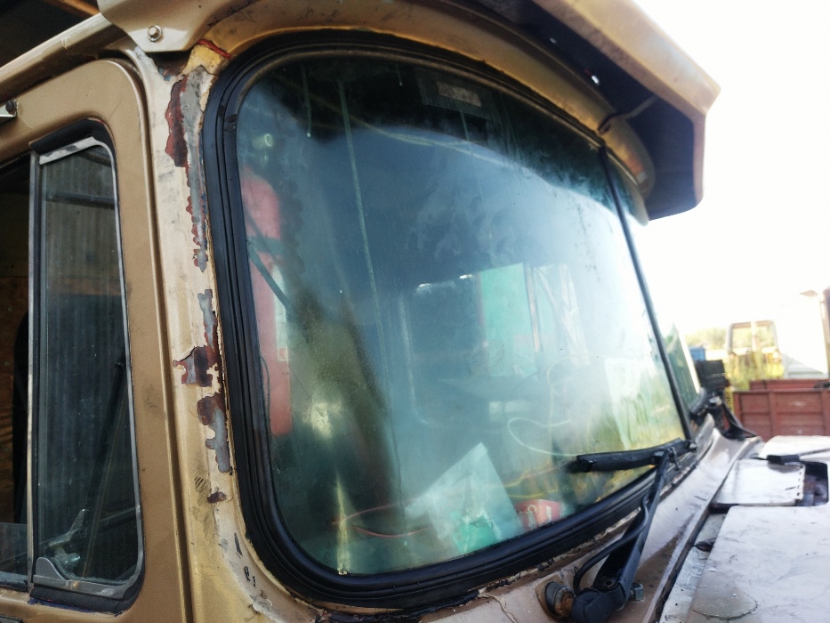

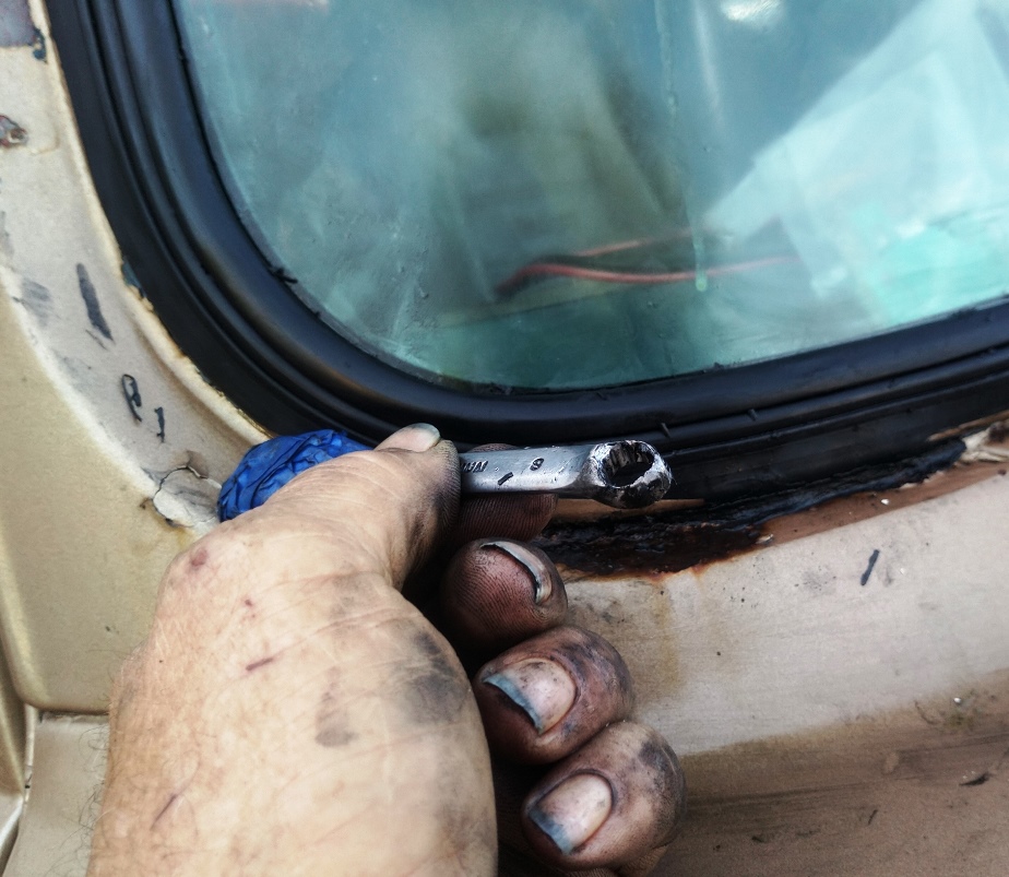

with a little liquid Dawn dish soap the install went so quickly I almost forget to get a picture
Attachment 47816
Attachment 47817
Attachment 47818
