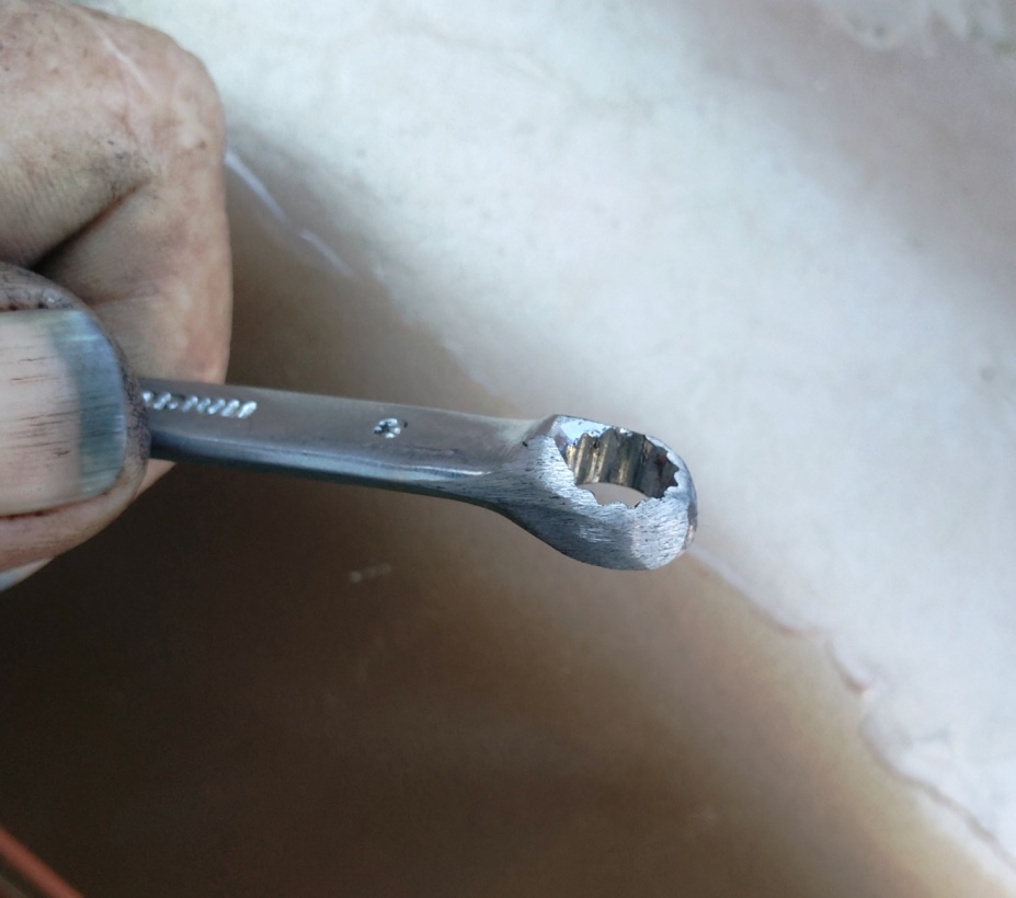

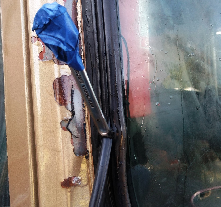

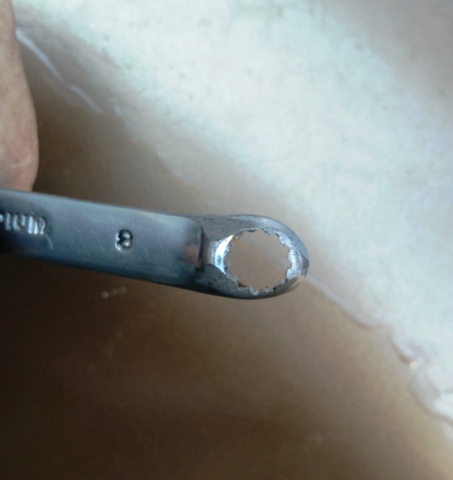

    Fine the glass arrived a couple days later. Installing this older glass is nothing new to me I've done it many times But same as he I didn't have the lock strip tool, so I made one out of an 8mm box end wrench

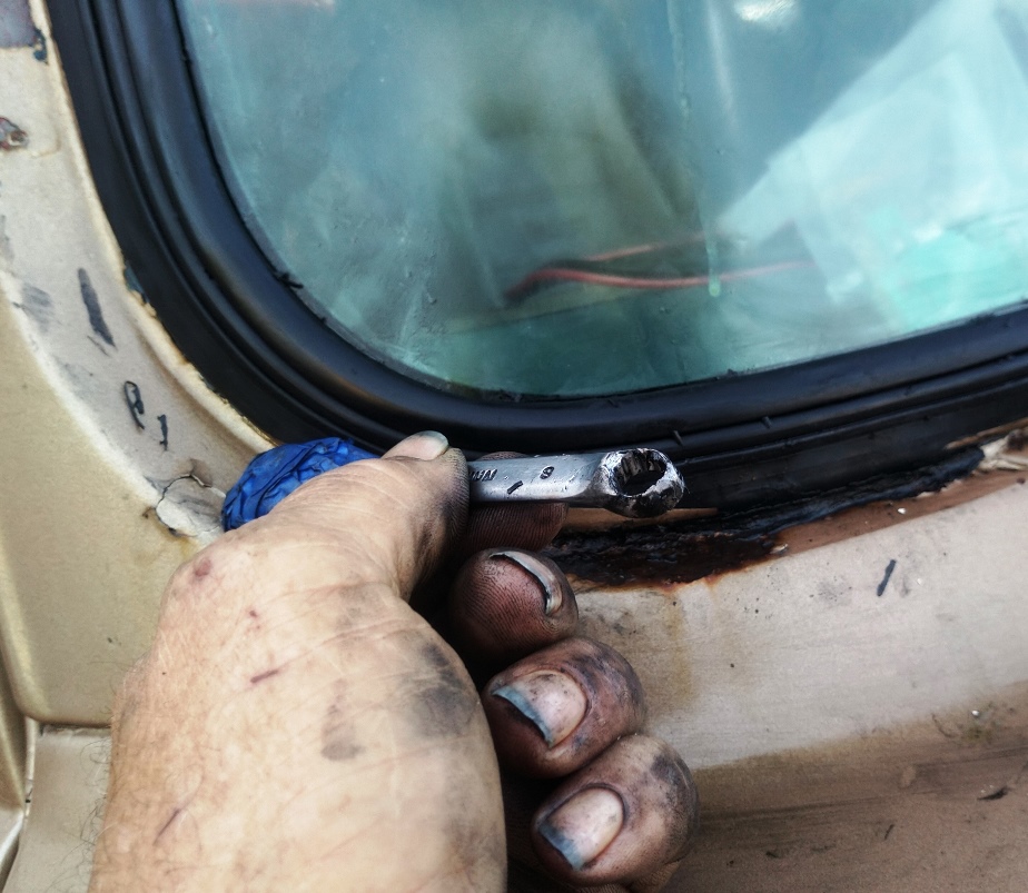

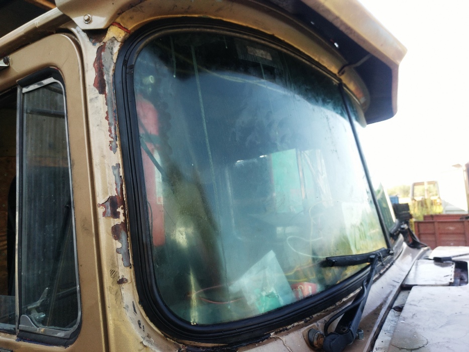

    with a little liquid Dawn dish soap the install went so quickly I almost forget to get a picture

    and now you get to remove the window to take care of the rust...

    Mark there is another type of window mounting rubber commonly used on cars and pickups from the mid 50s through the late 90s which did not have the lock strip.
    You stretched the rubber seal over the glass then wrapped a rosin cord around the outer grove placed the glass in place the best you could then from inside you pulled the cord from around the grove this would cause the lip of the seal to be pulled inside By the time you had pulled the cord all the way around the inner seal lip was in place, Job done. Again, dish washing liquid in the grove was your best friend.
