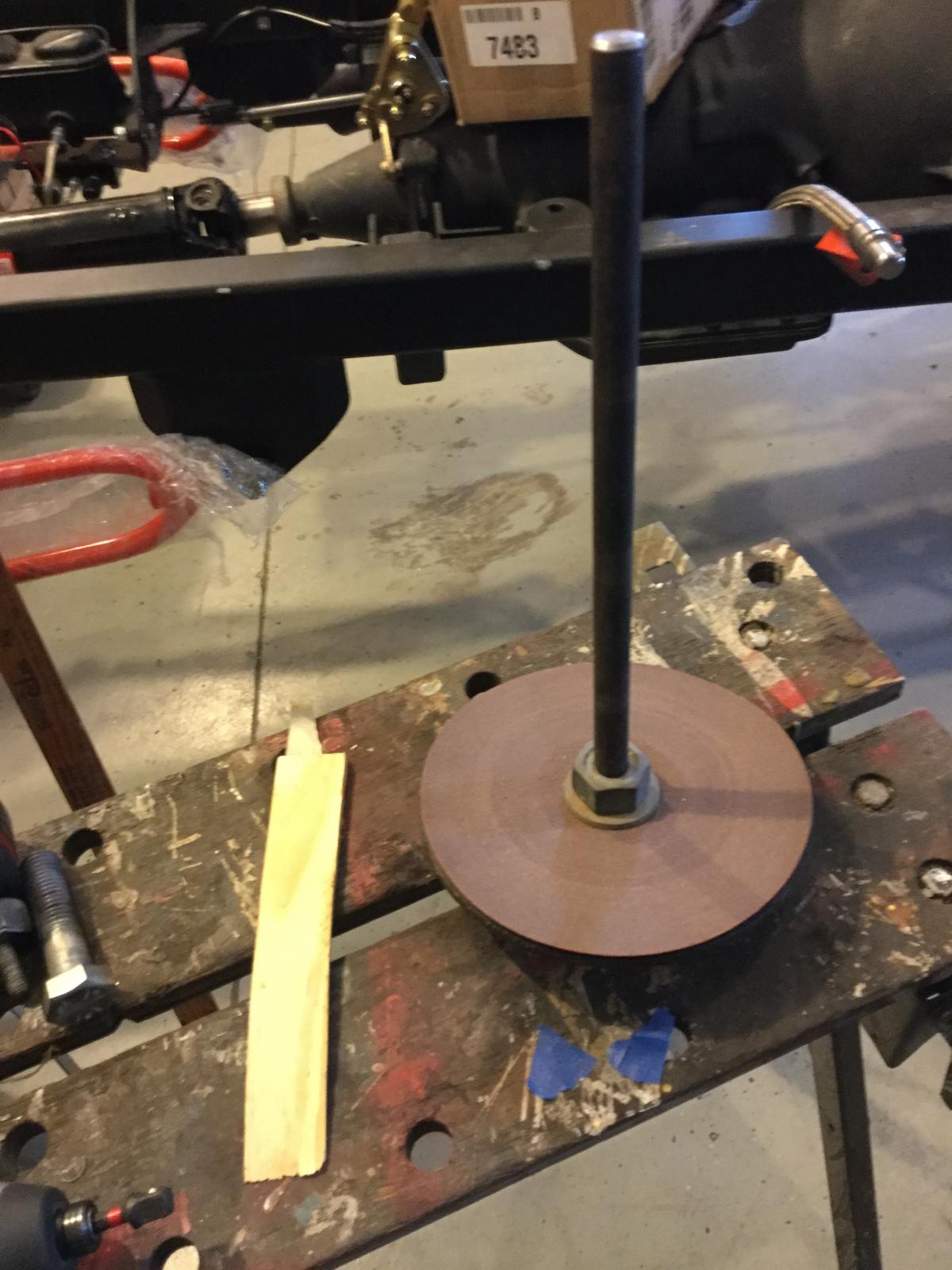

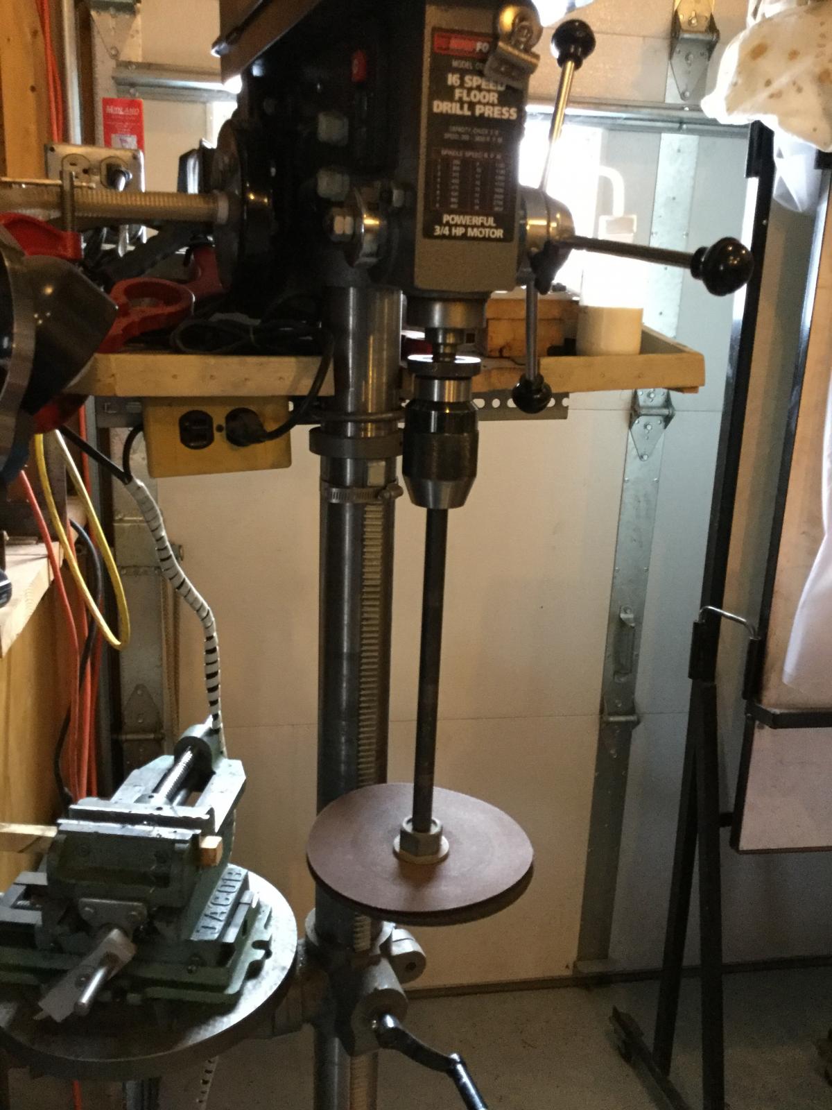

Tool sharpener
I built a simple and cheap tool multi use sharpener for shop. I took a long 5/8” bolt and cut the head off. I threaded it into the face of a 7” disc grinding wheel and locked it on with another nut. I use various adhesive backed sanding discs for the finish desired.
Attachment 27319
Attachment 27320
