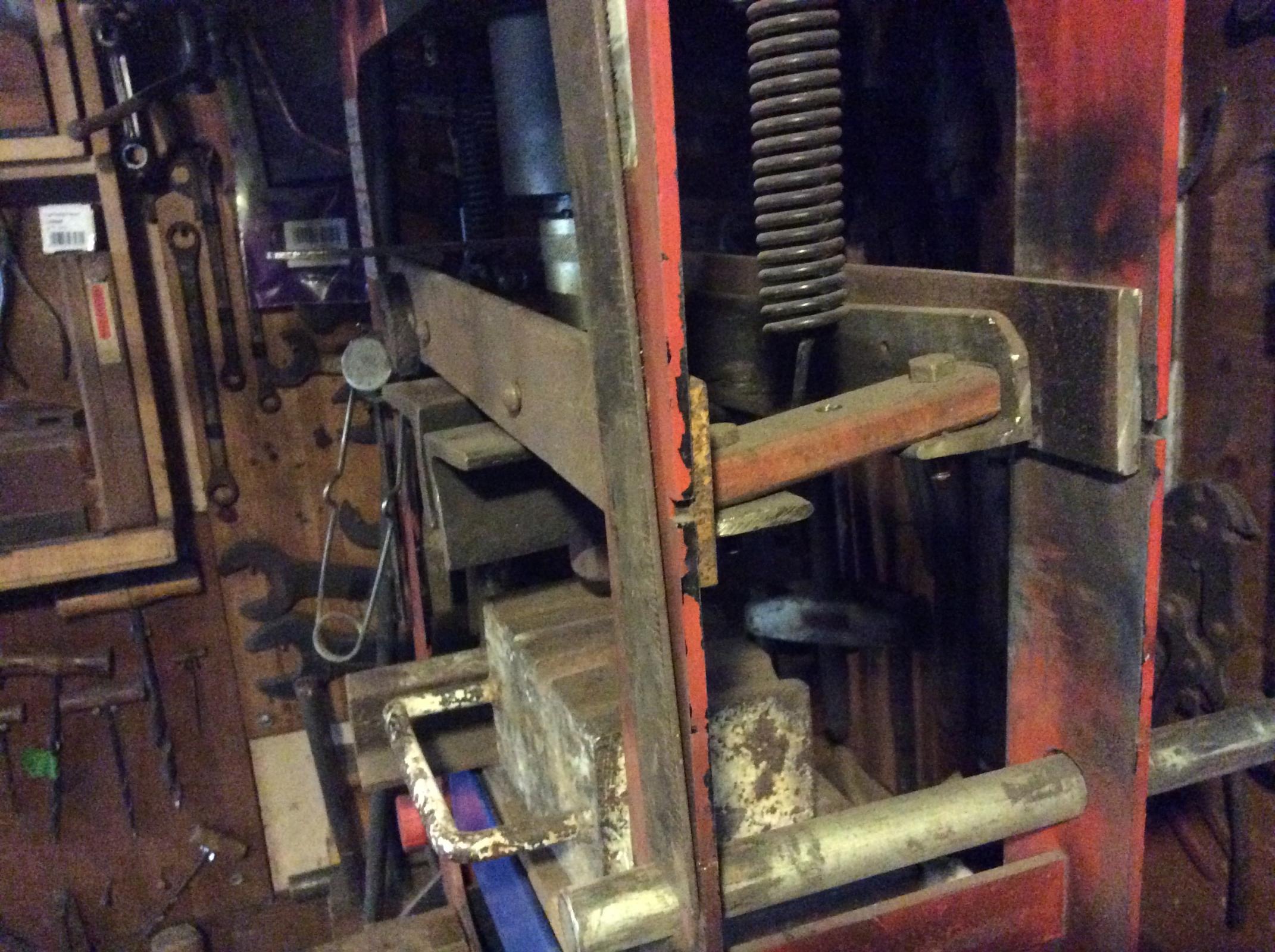

Attachment 33095
This is the carriage I made up to slide up and down the uprights of the 15T hydraulic press I bought for forging. (It wasn’t warped when I installed it) The springs make the piston retract slightly quicker, but do not seem to diminish the thrust.

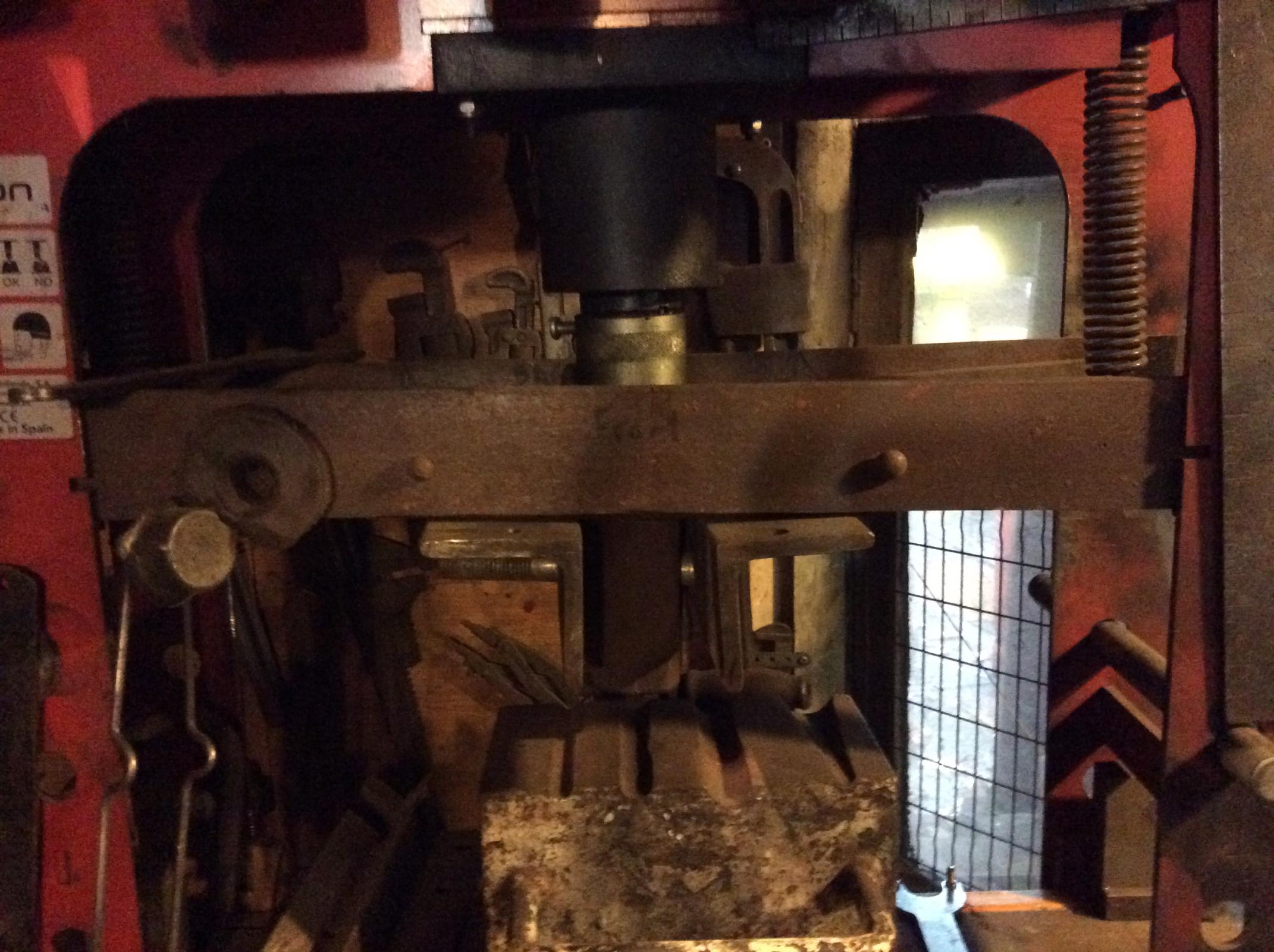

Attachment 33096 a bit of a glare from the window at the side, unfortunately, but I hope that you can make out the two pieces of angle iron which carries the tooling and beneath that an anvil, into which I have carved 4 grooves.

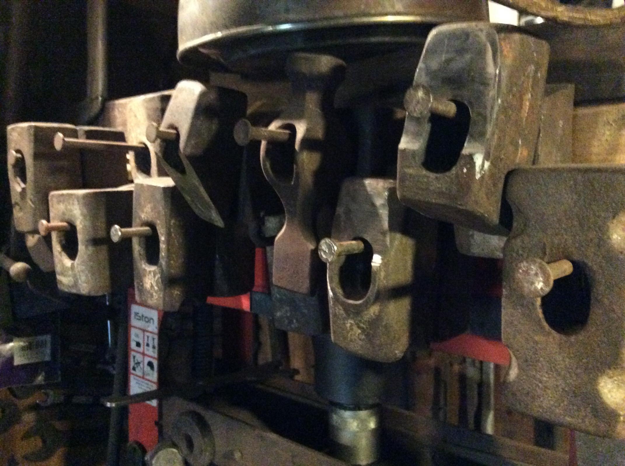

Attachment 33097
This is the rack of tooling, on top of the press. All of these have been ground from salvaged hammers, mostly 2lb lump hammers (I saved the wedges).

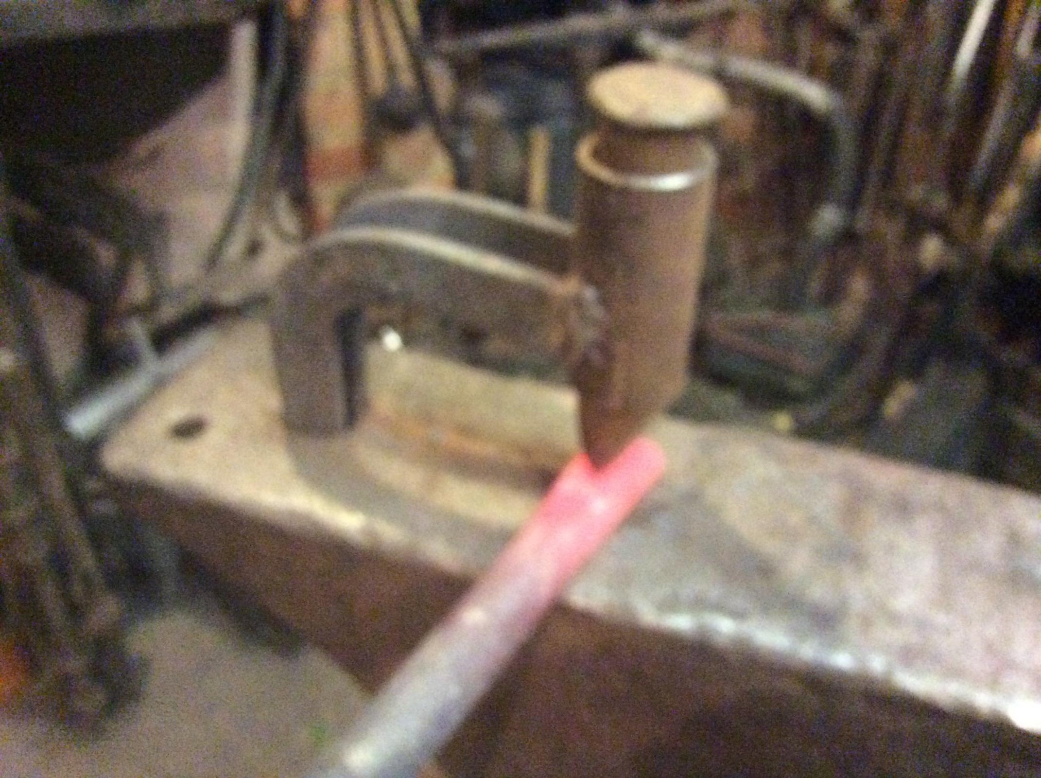

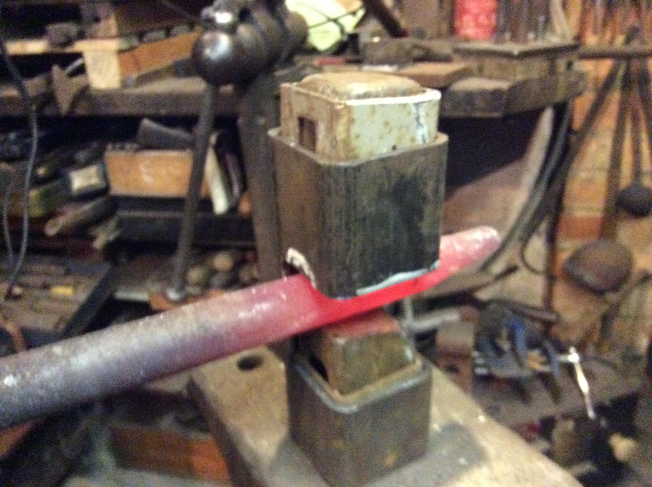

In emulation whereof, I made up an anvil guillotine, to make use of the tooling I’d made. Here you see a pair of butchers in the holder, to cut a shoulder into this bar (or a groove, by rotating the stock). You can see that there are inserts, from smaller box tube, to make up the slack.

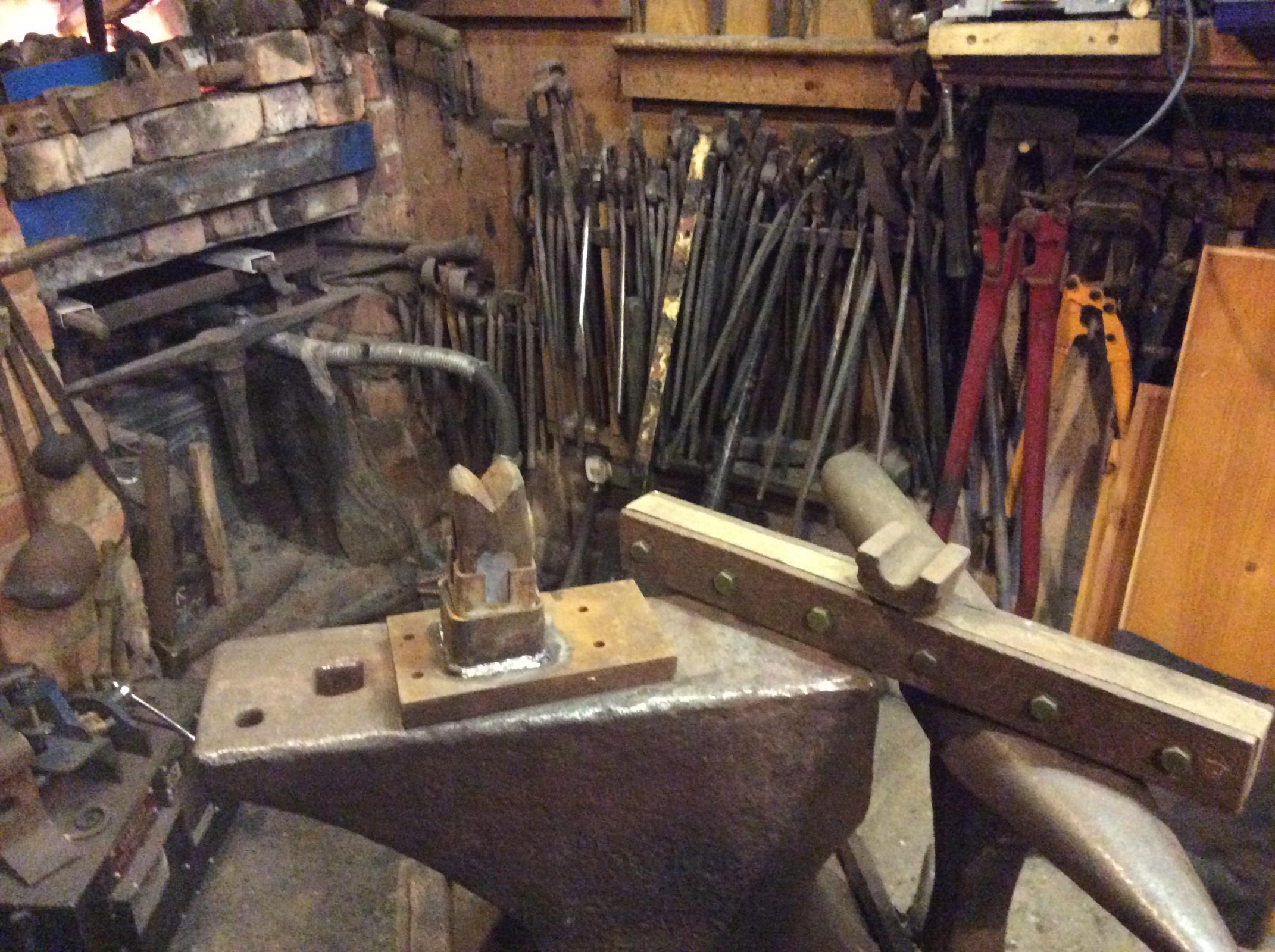

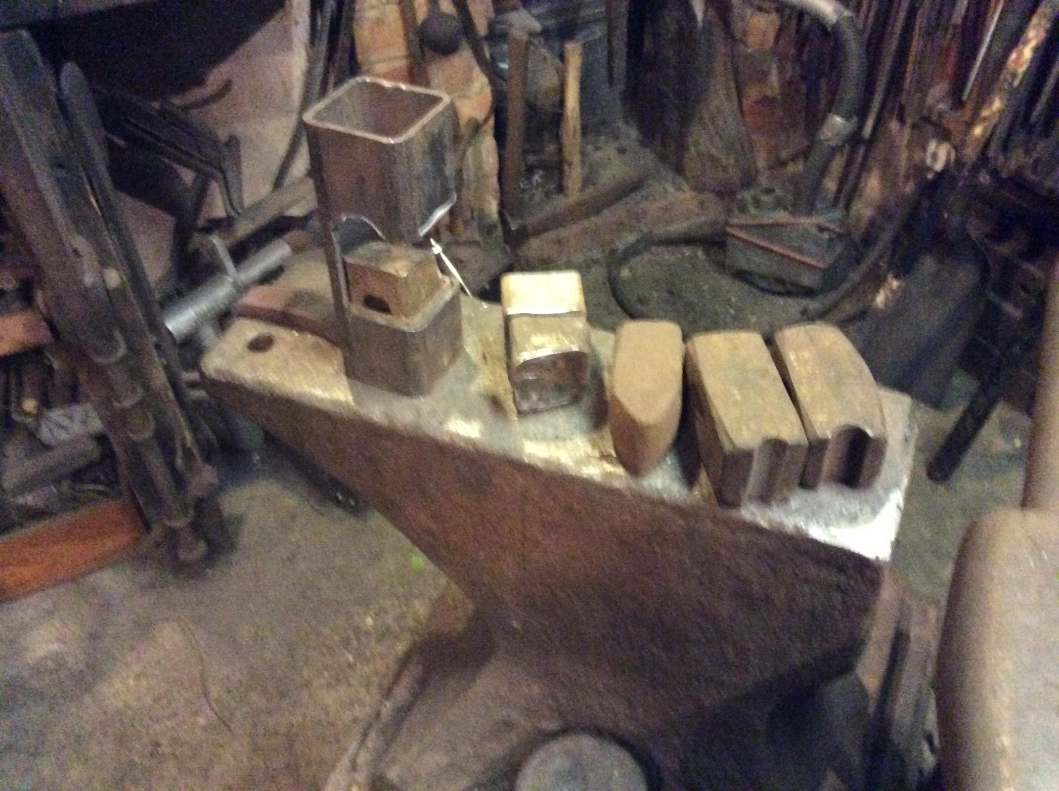

Attachment 33099
Here on the anvil are some of the tools, the butcher, 2 swages and a fuller.

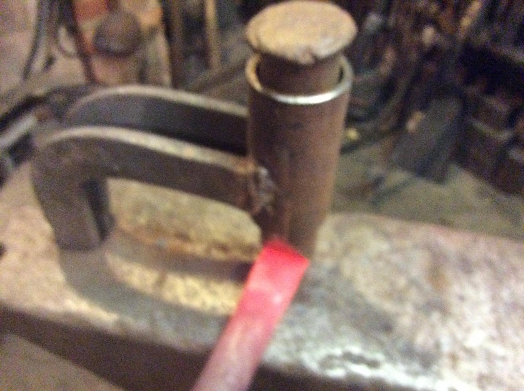

Glen, of GS Tongs, has another anvi guillotine, more refined than this, but the advantage is that you can vary the angle of eg the fuller to the stock as it is presented, rather than wave it about.
Attachment 33101
Like this. (The same fuller)

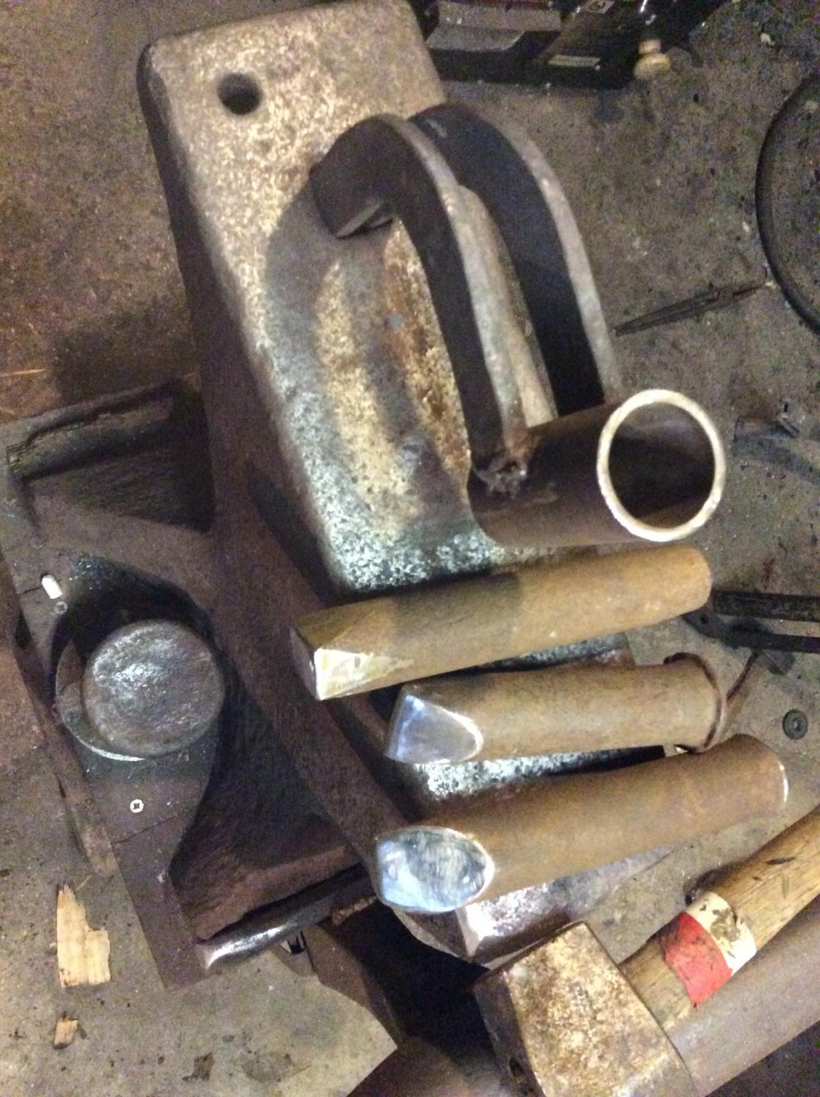

Attachment 33103
But I chose this diameter tube because had other tubes that fit nicely within, allowing a range of punches and chisels. Because I did not want to turn tubes to fit. You see 3 here, but there’s 2 more.

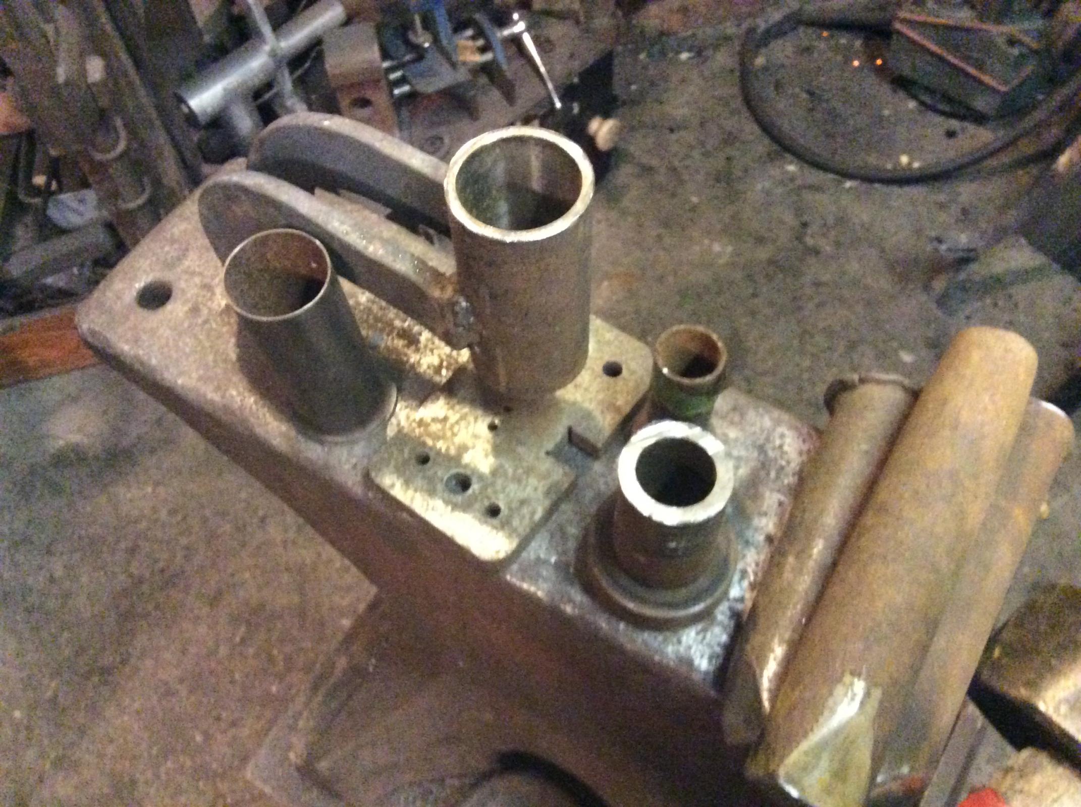

Attachment 33104
On the anvil here are two holders for anvil tools, that would fit the hardy hole, but the holders are designed to use in the press.
