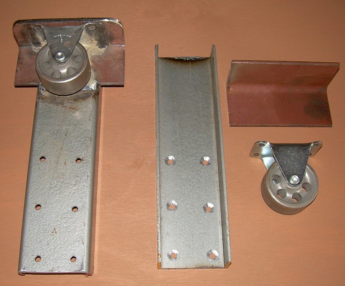

    Not a tool but a useful assembly if your building a workshop or other out building. So I spent the summer building a patio, porch and fresh-air workshop. I decided the best option for the back workshop entrance was a rolling door. In the first picture is one finished bracket for the rolling door and the parts for the second bracket before welding up.

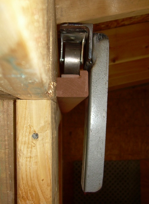

    In this picture I try the fit on the wood and steel flat bar rail.

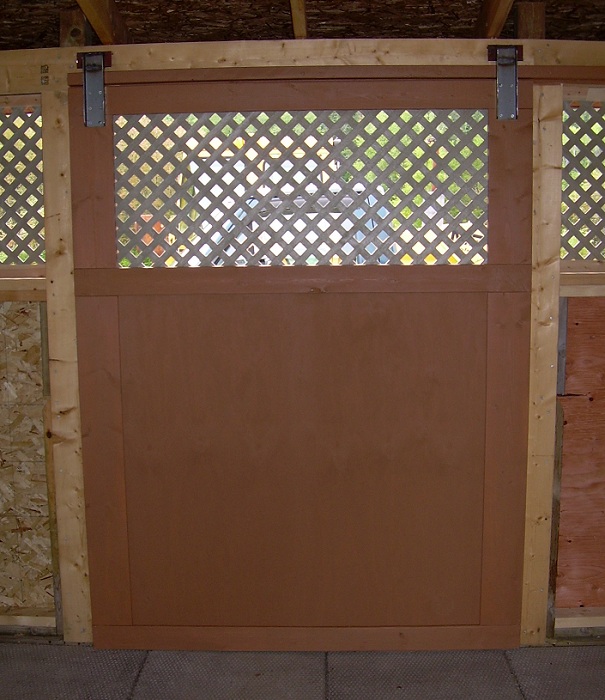

    Here the brackets are mounted on the closed door.

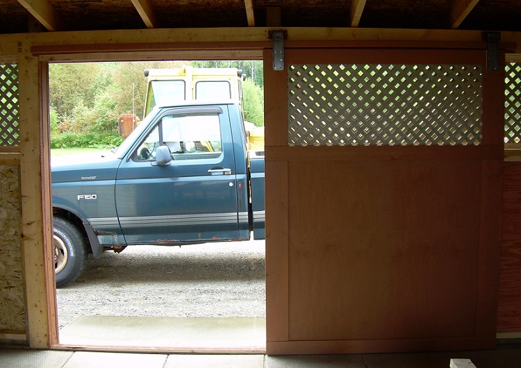

    The door in the open position.

    Worked out great, runs smoothly and opens with the push of one finger. The full build is at this link Hobby Workshop Projects
