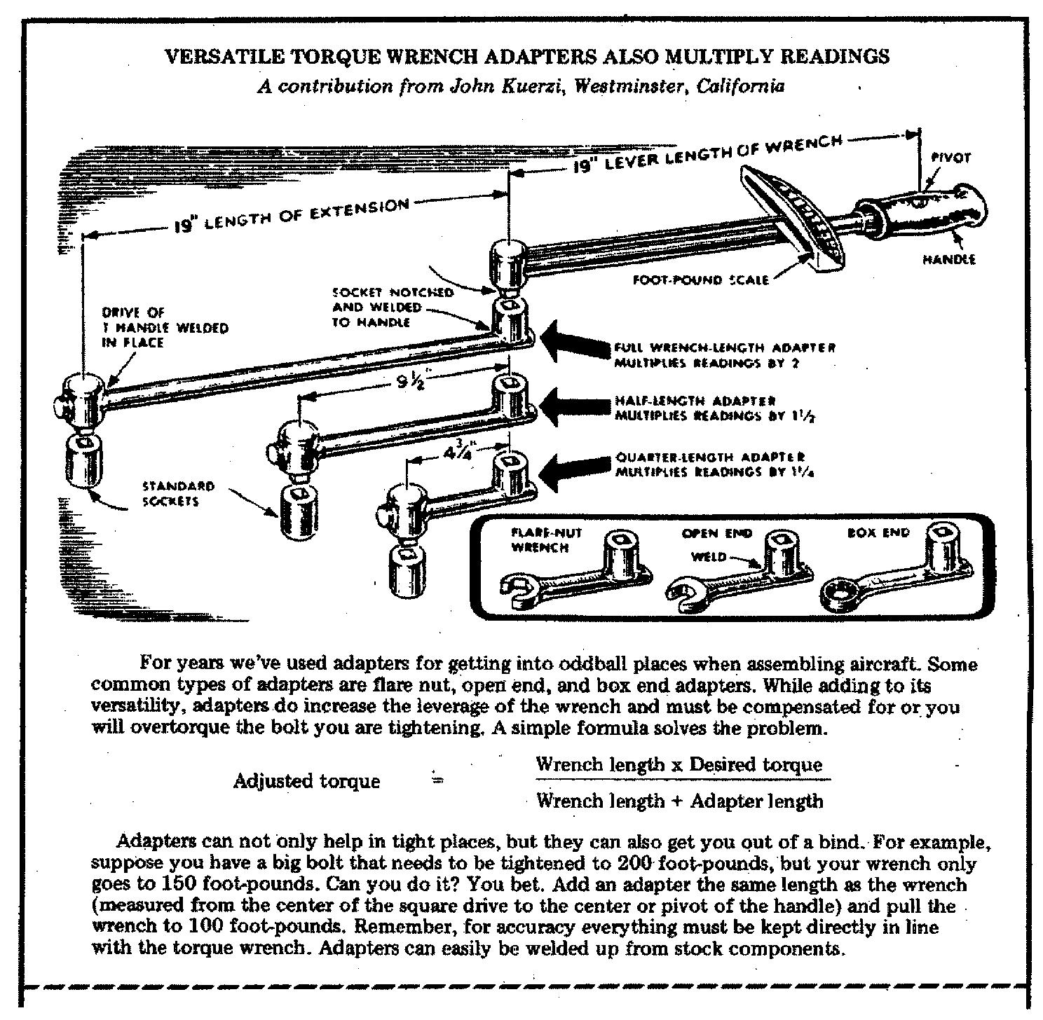

There are times when I sure could use an adjustable wrench that indicates torque. Well, I've got an adjustable wrench and I've got a torque wrench. Why not just stick them together? Does this change the amount of torque being applied?
If you are interested, please see
https://rick.sparber.org/TorqueWrenchAdapter.pdf
Your comments are welcome. All of us are smarter than any one of us.
