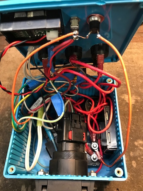

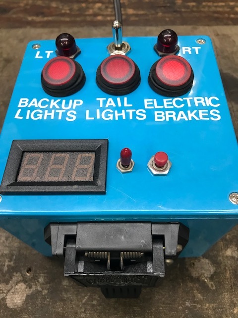

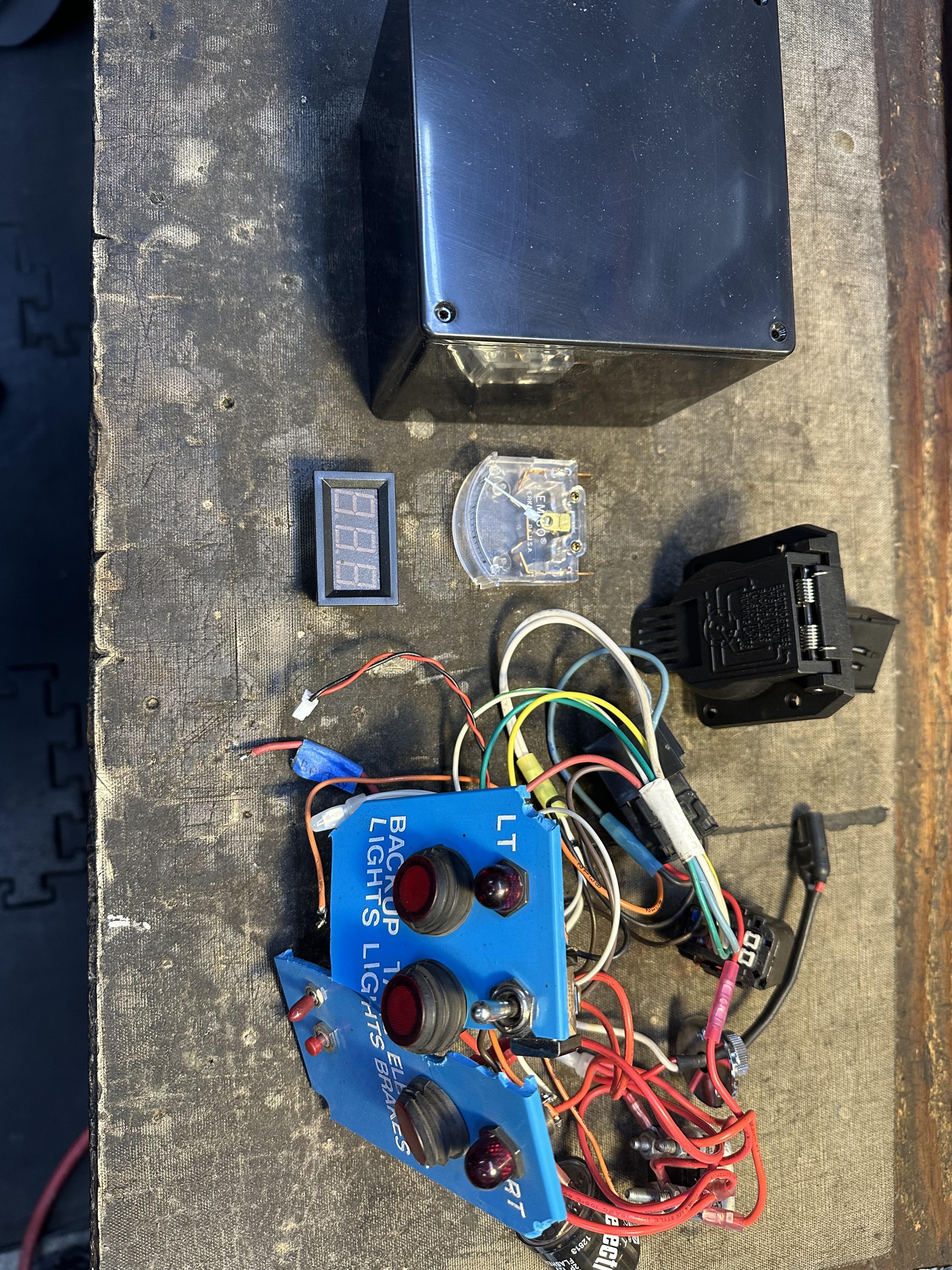

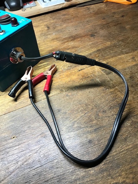

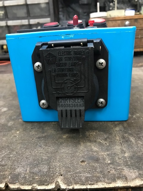

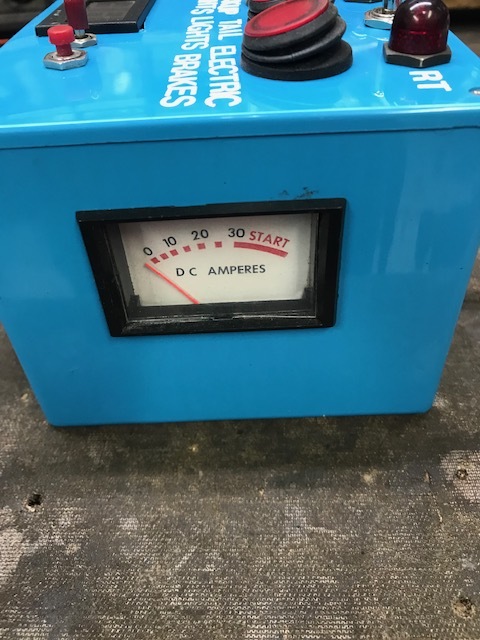

I needed a tester for working on electric parts on trailers. I didn't care for the commercially available units so I made one with parts I had on hand. Inside the box are two automatic-reset circuit breakers, one for the lights and one for the brakes. A 30 amp relay for the brakes. A solid state flasher. I mounted a voltmeter and a amp meter. The voltmeter will check the test battery or the battery on the trailer. The amp meter is for checking the brake coils.
Attachment 38329 Attachment 38330 Attachment 38331
It will test all electric functions of a trailer, Lights, Brakes and Battery

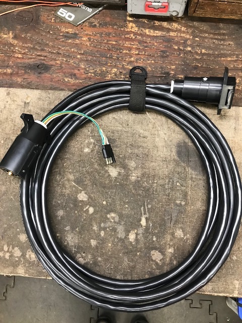

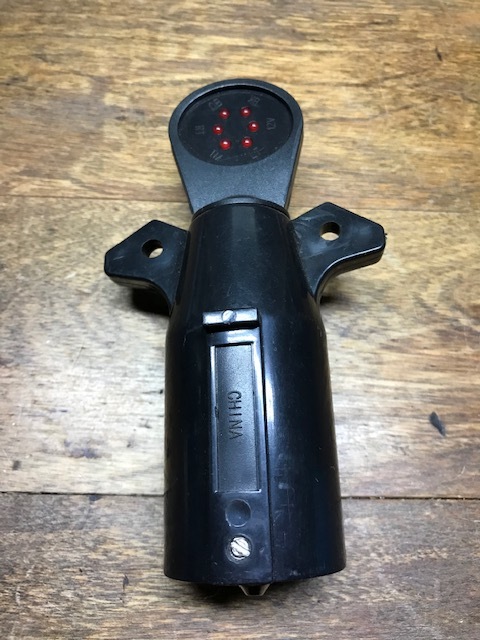

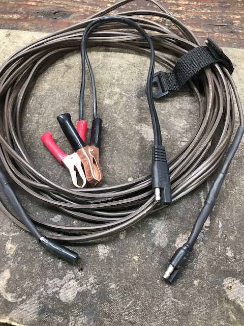

I made a 25 foot extension for the trailer that can also be used on the tow vehicle with the plug-in tester so I can test from the driver's seat or under the hood where the fuses and relays generally are.
Attachment 38332 Attachment 38333
Most trailers don't have backup lights put some trailers with surge brakes use a solenoid in reverse to stop the brakes from engaging, also will power-up backup cameras.
