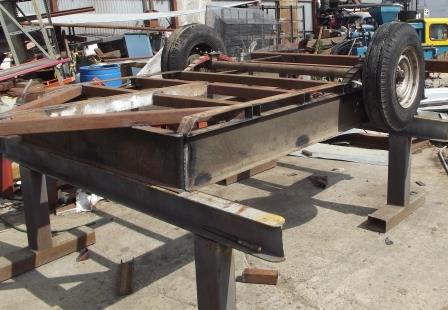

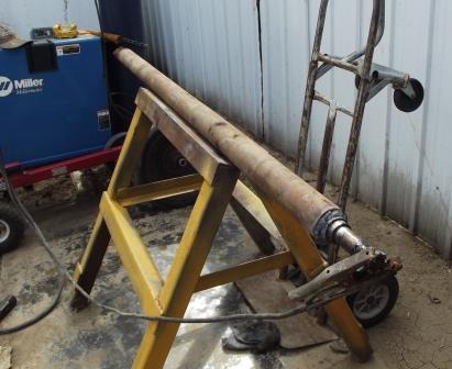

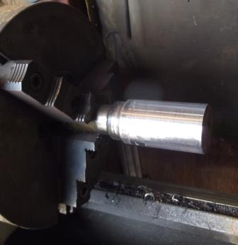

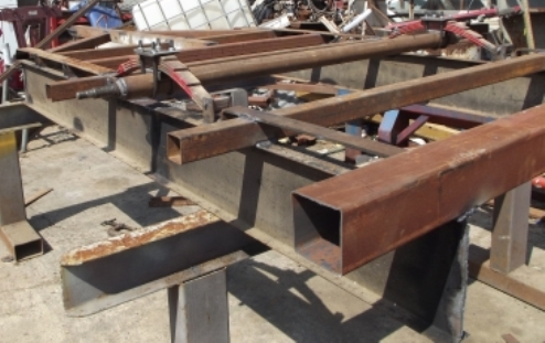

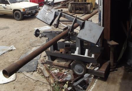

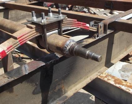

    for the last few days I have been building a small trailer. My goal was to use up some of the scrap materials I had accumulated over the years.

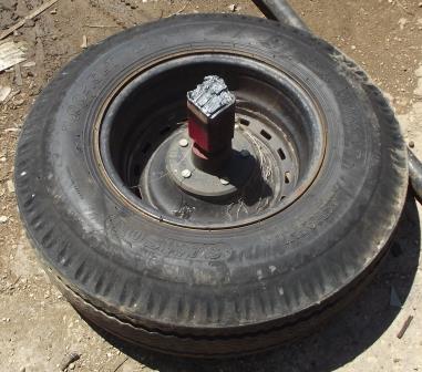

    To start with I had a pair of spindles and hubs with wheels and tires on them. the tires are 7.00 x 15 10 Pl rated I machined off the sq tube that was on the spindles then I welded a short length of 2 3/8" oilfield pipe over the stub then these were welded in the length of 2 7/8" oilfield pipe. This gave me my axle for the start of the trailerTrailer made from scratch-dscf7062c.jpg
    Trailer made from scratch-dscf7064c.jpgTrailer made from scratch-dscf7067c.jpgTrailer made from scratch-dscf7070c.jpgTrailer made from scratch-dscf7071c.jpgTrailer made from scratch-dscf7072c.jpgTrailer made from scratch-dscf7073c.jpg

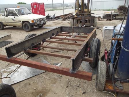

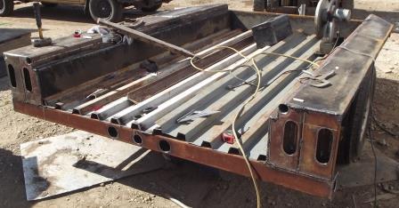

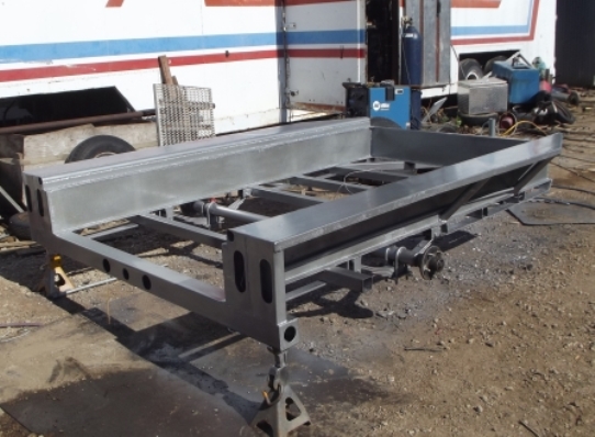

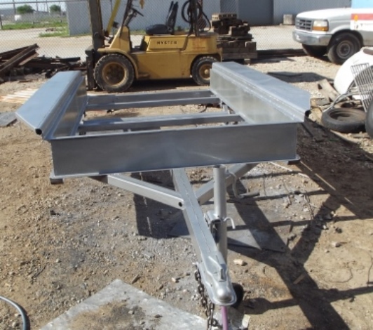

    Next I laid up the frame and cross-members and mounted the axle and tongue.
    The trailer is basically a 5 ft by 9 1/2 ft utility which easily converts into a 7 ft by 9 1/2 ft flat bed
    the frame is made from an old mobile home frame the cross-members are made out of 2 1/2" sq tubing the rear tube is 4" sq tube the tongue is made from 2 pieces of 3" channel.

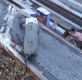

    To clean the old asphalt paint from the trailer I used my oscillating saw it worked much better than anything else I tried

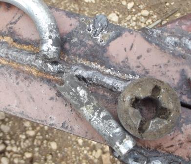

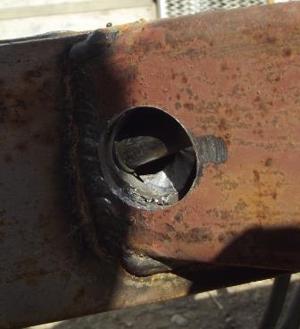

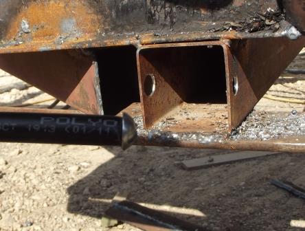

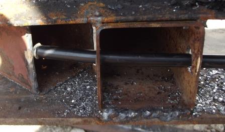

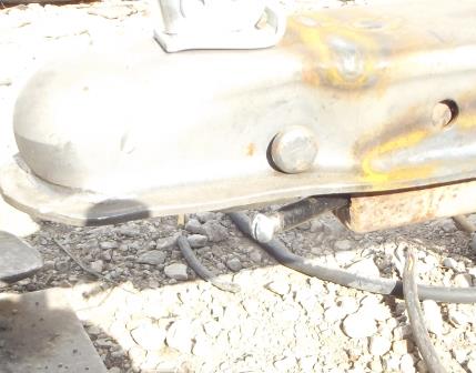

    For the wiring I fed a piece of 3/8 DOT nylon Air Brake tubing through both sides from the tongue , the diagonal tongue brace tubes then up through the front fender support tube to the marker light then back down to where a 1/2 " EMT conduit is welded in to carry the wires to the rear of the trailer.
    Trailer made from scratch-dscf7095c.jpgTrailer made from scratch-dscf7097c.jpgTrailer made from scratch-dscf7098c.jpgTrailer made from scratch-dscf7099c.jpgTrailer made from scratch-dscf7100c.jpg

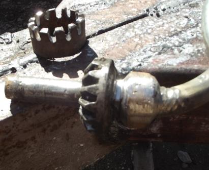

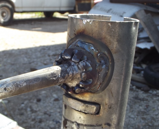

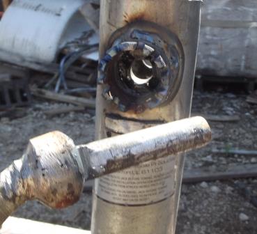

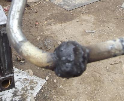

    In the last few pics I showed how the nylon tubing war routed I had to use a round head bolt to help ot slide past the changing angles

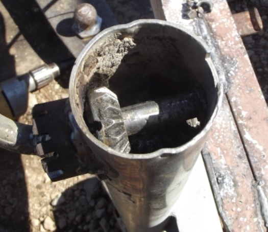

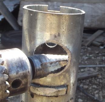

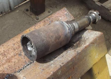

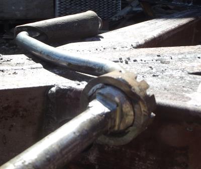

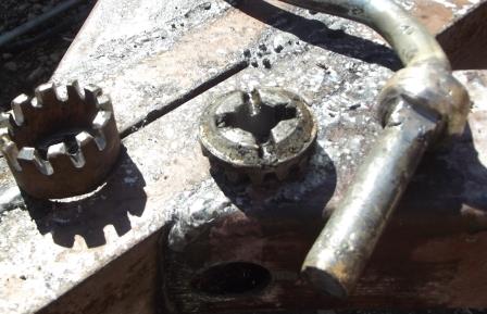

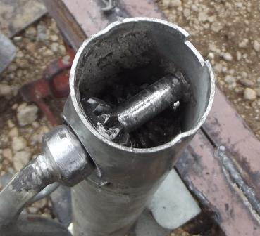

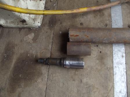

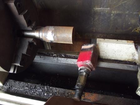

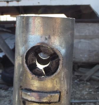

    the jack I had laying around had a broken handle so instead of using another jack I opted to repair this one
    The crank handle shaft had broken right where the roll pin went through it to turn the bevel gear.
    I really didn't care for the design as the bearing block was also broken. So I opted to weld up a dog knot on the shaft then instead of the roll pin I used my chop saw to make a square shoulder for the gear to be driven with. again using only the chop saw I made the knot round and cut several relief cuts around the end of a 1" pipe then cut it off to become the mounting bearing. I used a step drill bit to ogle out the hole the shaft passed through then welded the 1" pipe to the jack body after assembling the shaft to the gear I bent the tabs of the pipe over to hold the shaft in place.
    The jack works beautifully

    THe trailer was sprayed down several times with KBS Rust blast then left over night then wiped down with KBS #1 thinner then painted with KBS rust seal silver
