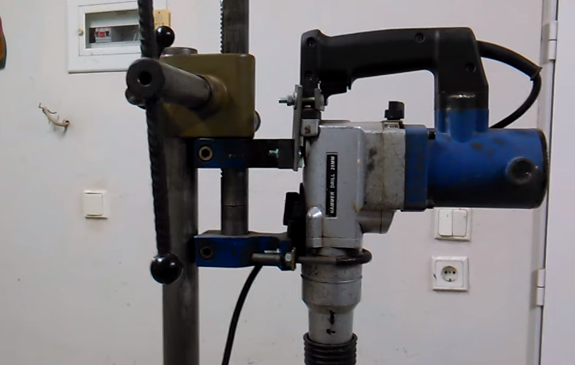

    TRANSFORM A PNEUMATIC DRILL WITH SDS TO A STRONG STABLE TABLE DRILL

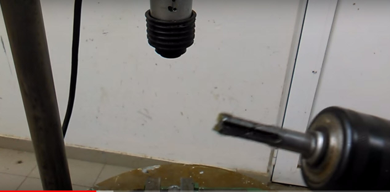

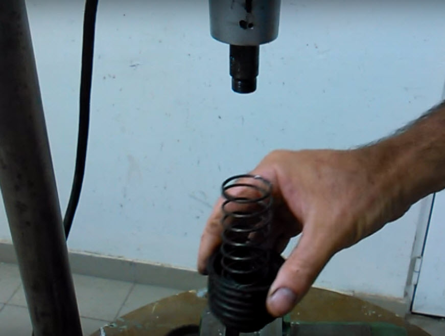

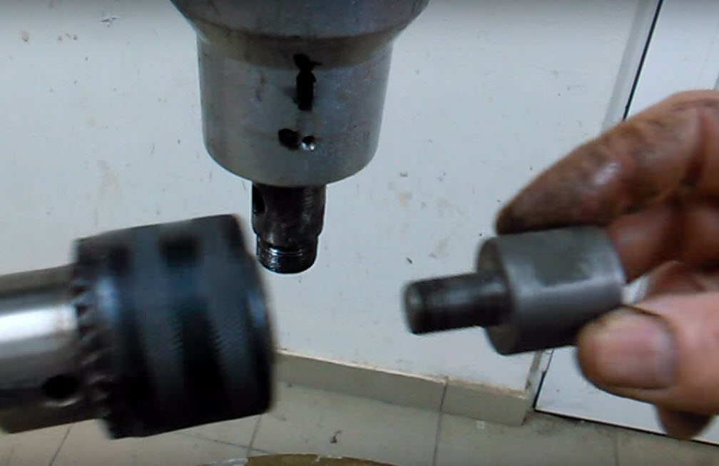

    When someone gave as a gift to me a drill base i decided to transform a cheap pneumatic drill to a strong one more stable by replacing the sds tool with an adaptor with special double thread i made with the lathe.

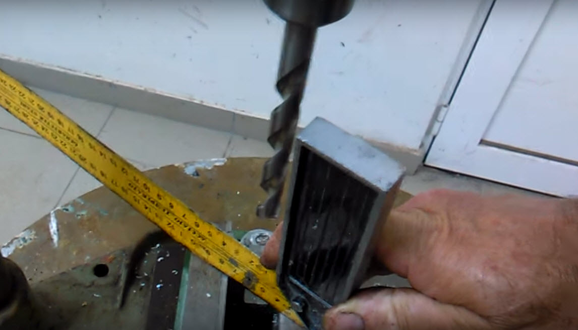

    The precizion now is better and using a xy table you can also use it as a milling machine for soft materials.
    YOY CAN SEE THE TOOL HERE.
